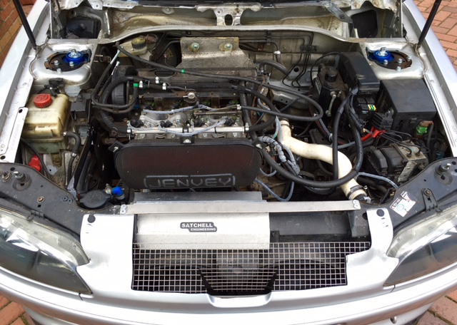

Fitted my Suspension today & top mounts
Ajustable top mounts made by Russain Guy / Dennis

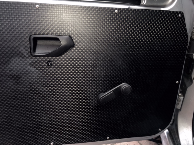

Twangy / Wayne Carbon Fibre door cards & rear cards fitted with Stainless screws ...lacquered them in Matt finish .

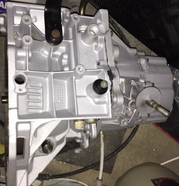

Can't wait for the gearbox to go in ...that's what I'm looking forward to the most M8 ...
4.75 Crownwheel & Pinion with complete new Bearings & bushes refurbed by Miles

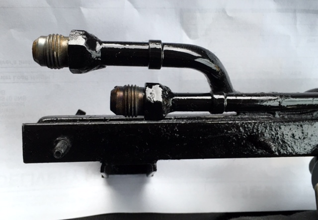

Welded on some JIC6 to the old fuel rail for Safty after my scare Rofl
I'll now run 811 Goodridge Ptfe Stainless hose back to the swirl pot ...so all JIC6 connections

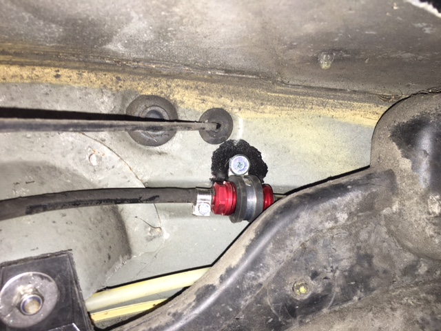

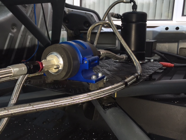

Because of my fuel line fire my two fuel pipes had to go & breather hose to my Charcoal canister had to be rerouted sadly ...
Now fitted ...Red in the Picture ....Upside down breather vent on alloy p clip from tank now ...up above & inside drivers rear wing & under arch liner
Then vents out ...no pipework inside for this
My 811 PTFE fuel pipes are now running down the passenger inside exhaust tunnel.
To the right of the red upside down valve which cuts fuel off ...only needed if I turn the car over HOPE NOT ... ...it's now by the petrol filler cap cable operner ..ideal place for it to go hopefully ?

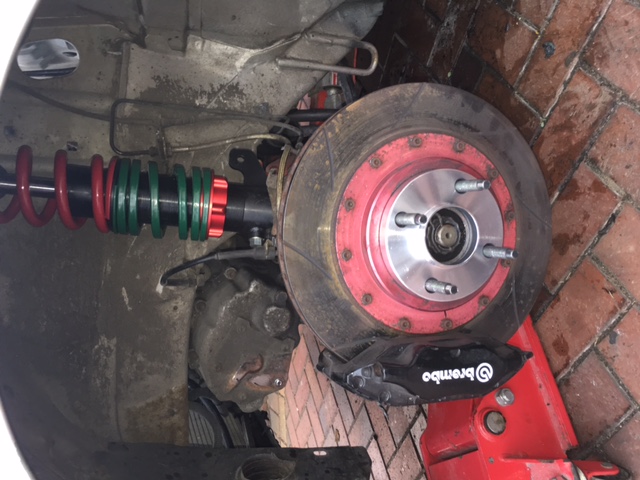

I've taken my Brembo V6 4pot Calipers off for Godspeed to totally refurb them ...

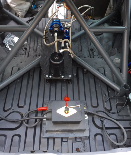

#71

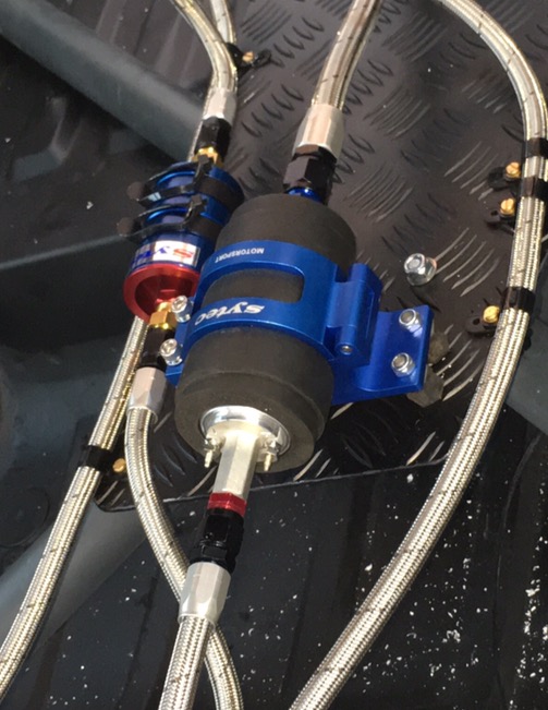

Jenvey throttle Cables now needs to be reversed & shortened by 18 inchs ..
All Full pipes fitted
Swirl / pump / filter now finished & all fuel pipes fitted but need P Clipping down ....
Battery cables need extra covering & P clipping / tiding up
Alloy checker plate rubber mounted on floor
Fuel pump rubber Bobbin mounted also
Getting there after my Fire setback
Just need to vac up mess & connect power to my relay with 30amp cable & fuse Rofl

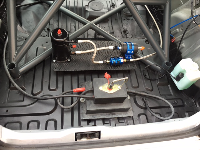

every update a complete winner, fuel system is utter lush. Do the rubber mounts help isolate the noise from the pump?
#75
(16-03-2016, 09:34 AM)zx_volcane Wrote: every update a complete winner, fuel system is utter lush. Do the rubber mounts help isolate the noise from the pump?
Thank you so much guys ...its been stressful / expensive work ...
I'm really trying to get it finished in 2-3 weeks
Yes & car to pump also ...it's what they do in the planes ...vibration suppression ...the pumps are loud ...

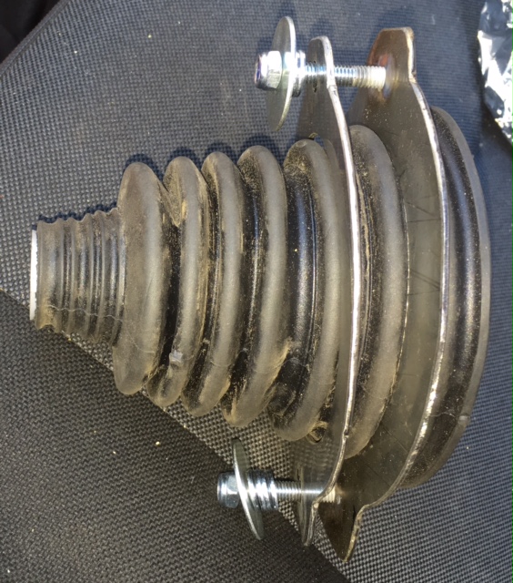

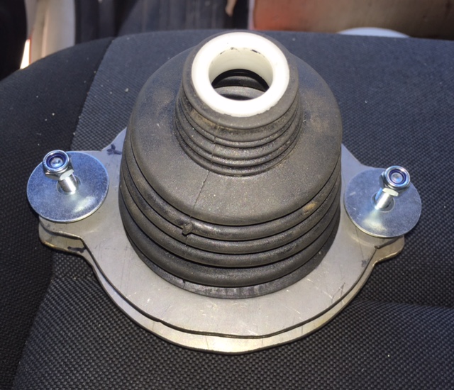

Finished making my new Satchell shift gator boot cover ...
This one clamps the boot & is more flexible ....hopefully this will free up some of the pressure when it's moving gear to gear ...the original supplied one is much to tight on angles
Made both clamps out of Stainless Steel only because I could....also welded the nuts on so I can fit it easy on my own from inside the Car

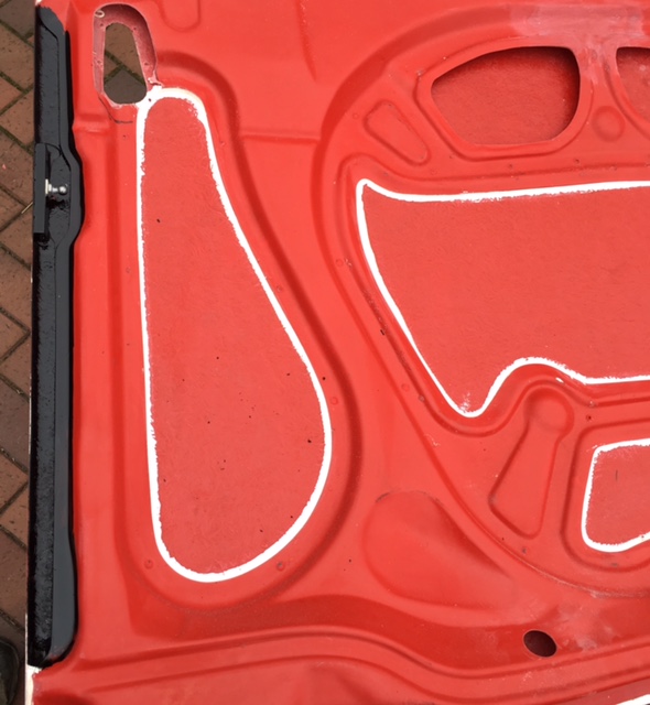

Well Piggy I found why my bonnet was flexing m8 ....see the Black down the edges ...well I stuck the panels together with my windscreen bond ....he missed & the twin skins were 8mm apart & not supporting each other ....
Gone to get sprayed now .everything dry fitted & tried including squirters ...

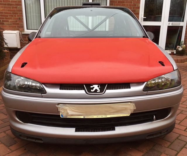

I've fitted the Badge to the grill as I didn't want to weaken the bonnet ...now I've got a smooth bonnet but still have enough badge showing ...
Aero catches trial fitted & bonnet drilled for washer jets ...
Getting professionally sprayed same colour as car & should have it back before next Friday Rofl
