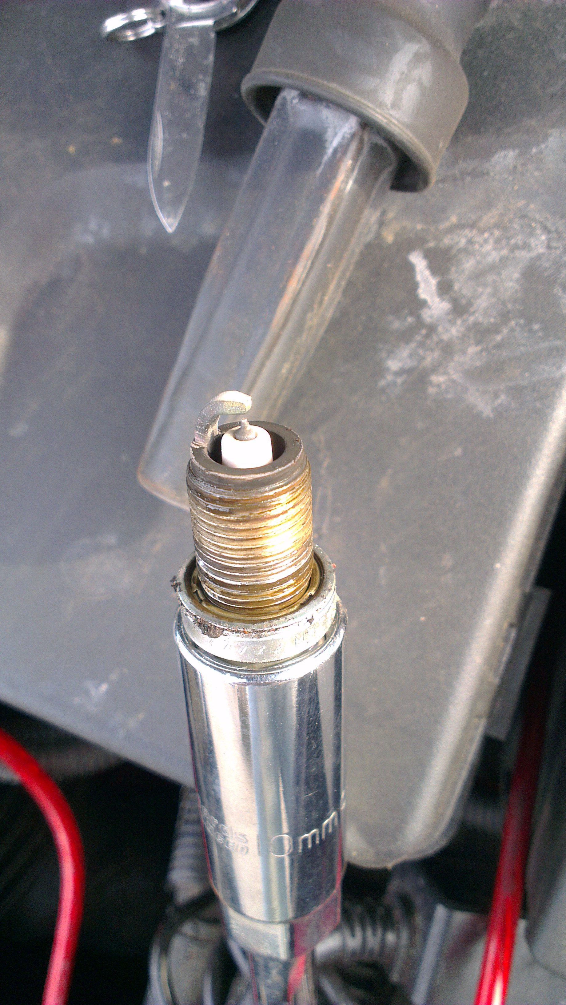

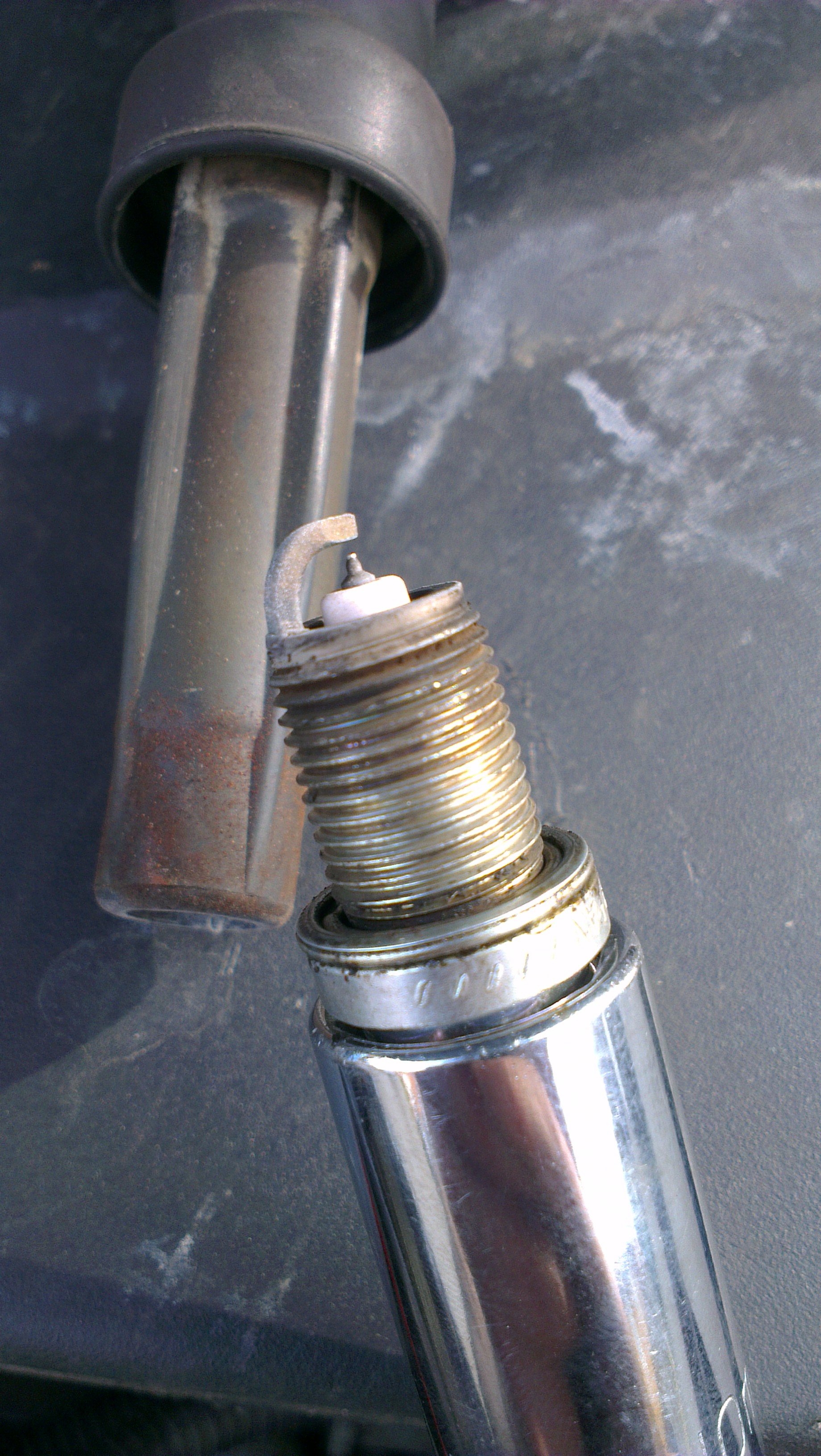

Anyway, I had a spare 20mins this afternoon so whipped the plugs out.
From battery side to cam pullies;
1
2
3
4
Now I don't know a huge amount about plugs and how the colour relates to how the engine is running; can anyone who knows what they're looking for comment please Smile

They look pretty good to me buddy!! Not much in the way of deposits...!

They look fairly healthy tbh.
Ed, if there is still a issue (which if im honest, i genuinely dont think there is from driving it the other day), im starting to think it could be your ecu at fault.

those plugs look great...they also look like iridium tipped ones which last a lot longer...I would have greased the threads and popped em back in and saved the new set for later date.

I didn't bother swapping them for new ones, yeah they are NGK iridiums Smile cheers mate Smile ill bung up another few photos shortly from before I got the tyre gel out :p

theres a problem with the first plug!
(07-04-2013, 05:47 PM)cully Wrote: theres a problem with the first plug!
....go on...
As above... Elaborate!!
some bum fart took the photo out of focus!

(07-04-2013, 05:59 PM)cully Wrote: some bum fart took the photo out of focus!
FFFFUUUUUUUUUUUUUU!!!! Go back to your lecktricks old man Tongue
Tbh it was quite hard taking photos of the tips, my hands were shaking a bit, and the phone didn't want to focus on them at the range where you could actually see them! Anyway, if the general consensus is theyre alright I'll just drive on Big Grin
