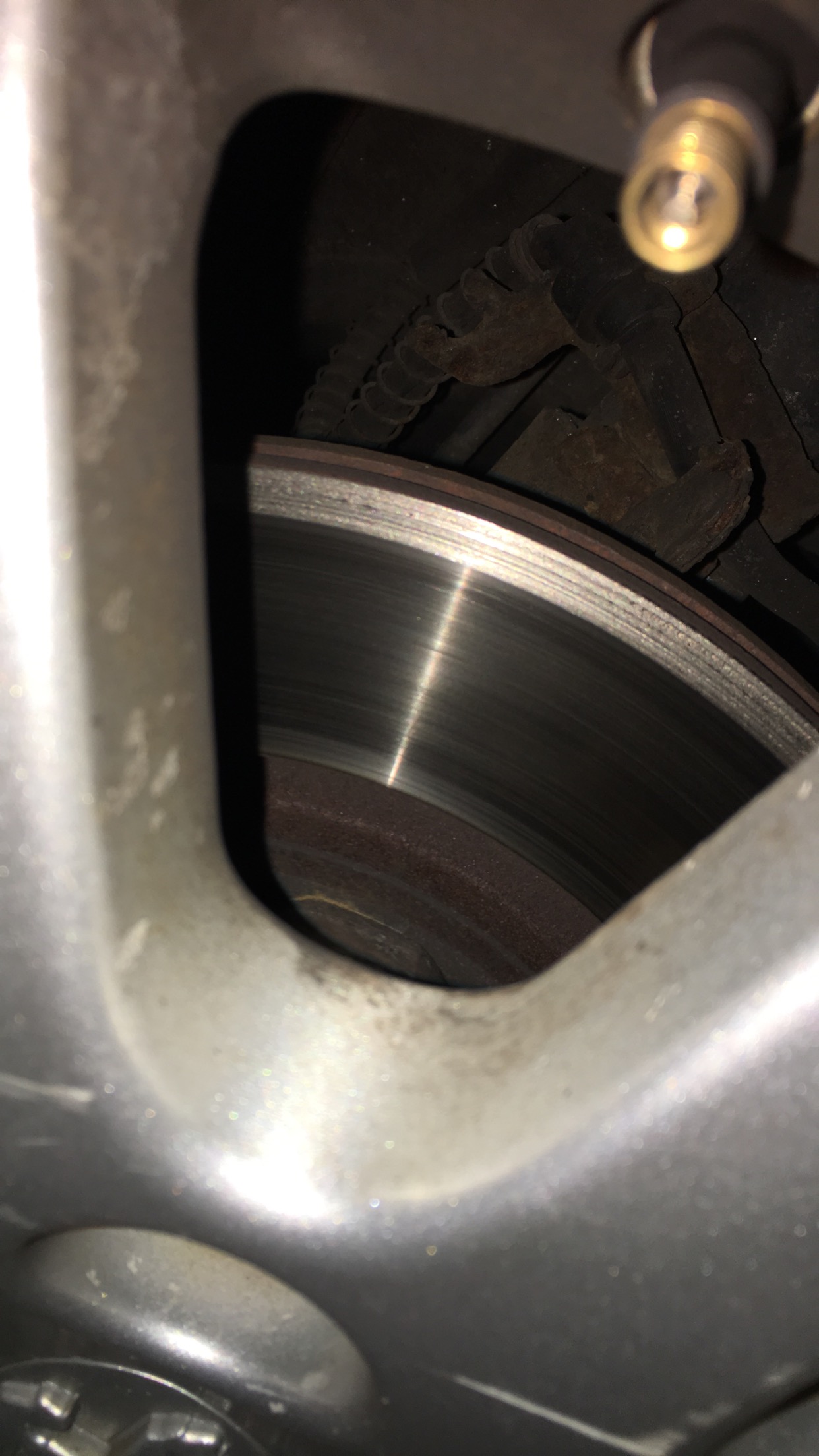

Bucket seat is officially in, to those who are against dropped harnesses they are placed in not in use currently.
On some down news drove the car today quick stop to the chippy for food and well I think I need new pads and disks ?

Nice. Shame about the brakes, those discs don't look very old.

(11-11-2017, 07:03 AM)Poodle Wrote: Bodykits and the like don't tend to be very popular on here, bu then the banter has calmed a little in the last couple of years.
I grew up in the max power era and still would love to go back to those days, if people want to hate on my car they can feel free, at the end of the day they don’t have to drive it I do so it’s made so I like it ?, my local car scene has a Motto your car your scene which I agree with it.
Disks and pads have been on the car since I bought it but I’ve give it death and knowing my look it’s probably the cheap pads used by last owner that I’ve killed. Waiting on the brake servo to get fixed before I throw on my GTI 6 brake setup.
