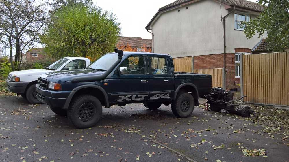

Had my truck recovered home by an ex forum member JonnyB who now runs a recovery firm.

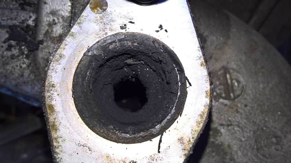

Started taking my truck apart and found quite how clogged my EGR system was

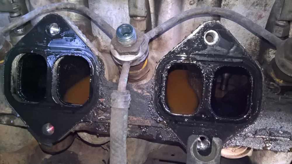

Also found out that I have definitely cracked my head.
Yup, that's coolant in the inlet to cylinder 2!

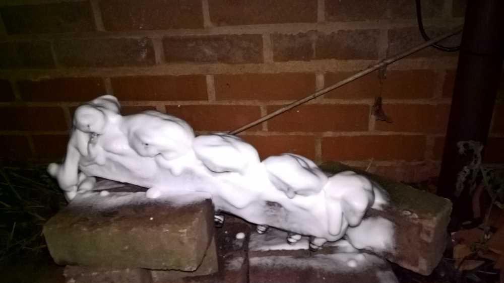

And while it was apart I decided I'd clean out the inlet manifold. I used Mr Muscle oven cleaner, it does a nice job and the foam expands to fill the inside of the manifold. One can did the manifold twice but I wish I'd bought 2 cans to fill it 4 times.

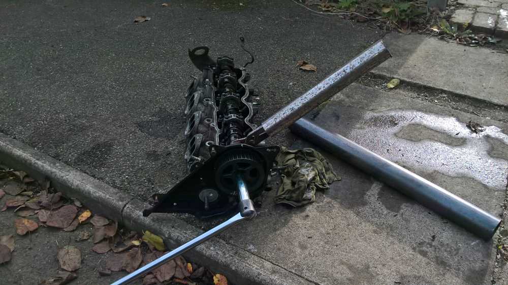

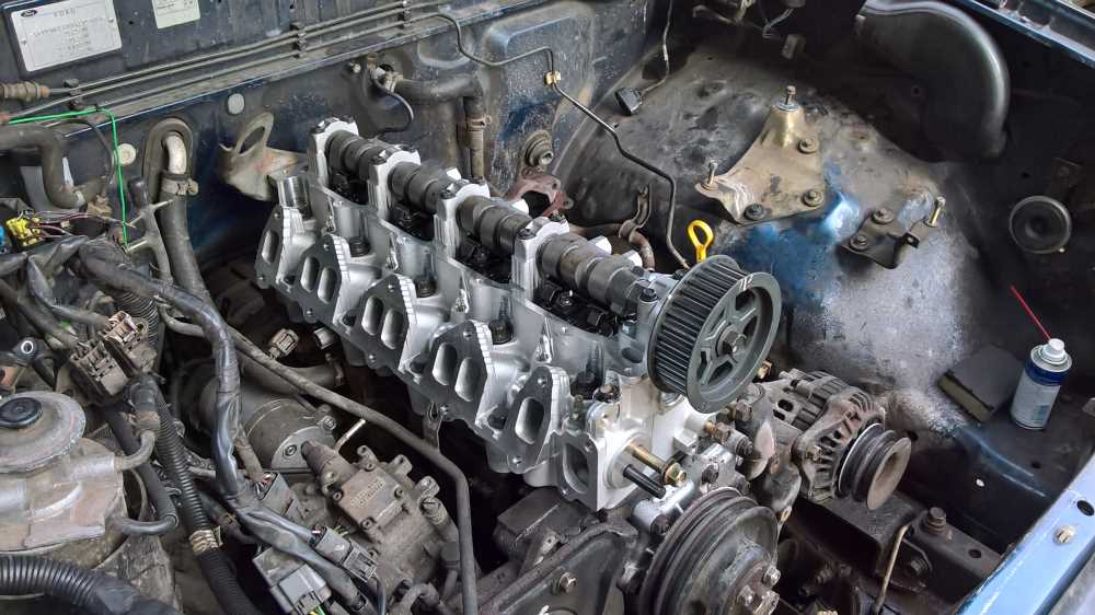

Anyway I got the head off quite quickly this morning, the injectors came out nice and easy and the head bolts came away with no trouble. I cleaned up the face of the block with wet and dry on a block of wood, left it like this as I didn't think it was gonna get any better.
One of the many joys of the day that made a 1 minute job into a 30 minute one was removing the cam pulley. The cam shaft has a hex on it to get a spanner on, I rounded this off. I could get good purchase with the grips but not enough leverage so slid a bit of small diameter exhaust over the grips which worked. I'd never of got it done in the bay with the fact I was having to apply body weight to the exhaust and the leavers.
Other Joys have a press in water fitting, I don't have a press and there's no way I could get any real sort of tool on it. In the end I heated up the head and slid a big 21mm spanner round the pipe and hammered on the spanner, right pain in the arse. The other pain is removing every bloody stud out the head especially the exhaust ones that appear to have started corroding in.
Anyway head is on. All the 18 head bolts are torqued up, this was a pain in itself as there is 2 different types of bolts and they were supplied with different heads so it meant constantly swapping sockets on the breaker bar. I've than pictured got a little further, the inlet manifold is on, water inlet, injectors are in and piped up, glow plugs are in and the cam belt is on and correctly timed. I don't think it was correctly timed before (the car has had some less than brilliant mechanics work on it before) I'd counted teeth and copied what was there when I swapped the belt but now having worked out what the timing marks are I'm pretty sure that was a tooth or 2 out causing the rough idle.

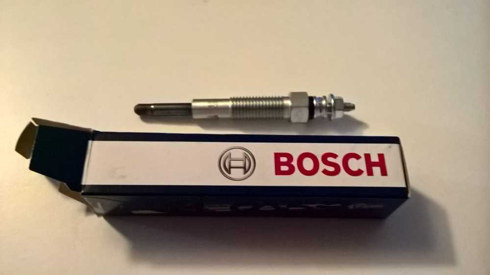

I got a glow plug stuck in the old head, couldn't afford a full set so I have a single bosch duraterm on cylinder 2. I will change them all at some point.

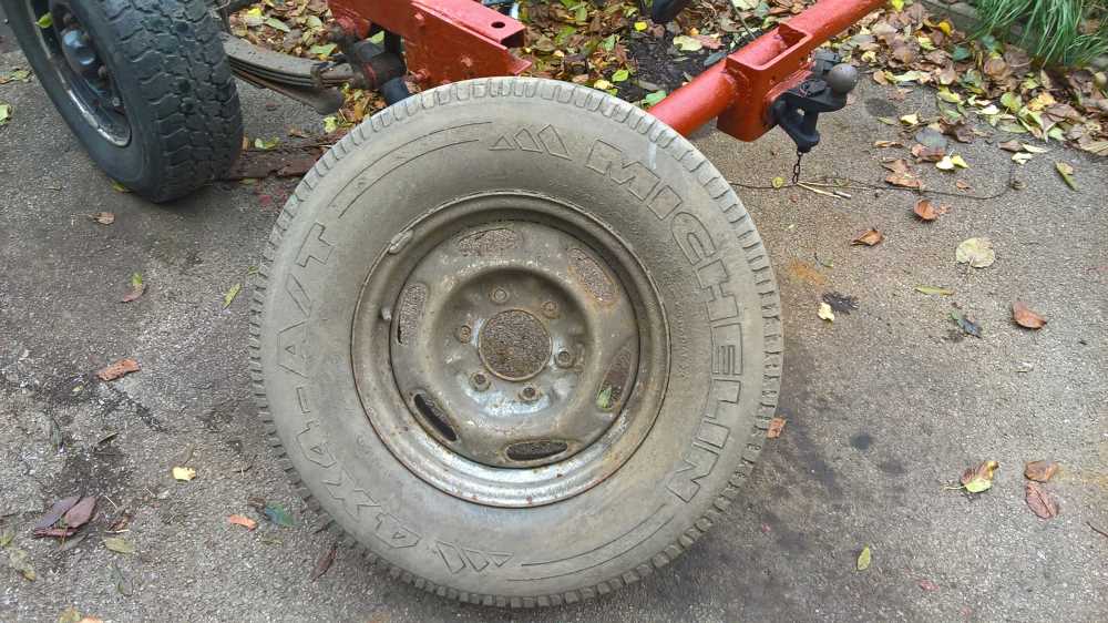

Whipped the spare wheel off, it's barely legal and gets in the way offroading but it's gone in the pile for the drift truck.

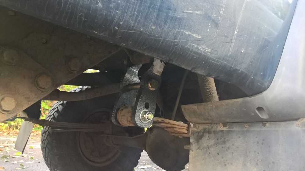

Fitted my longer rear shackles (bottom right) which was good as whoever had previously fitted new shackles with P bushes has an entirely different opinion of what tight is to me, the only reasons the nuts didn't come off was the amount of muck and corrosion in the threads.
New ones are on and sufficiently tight.

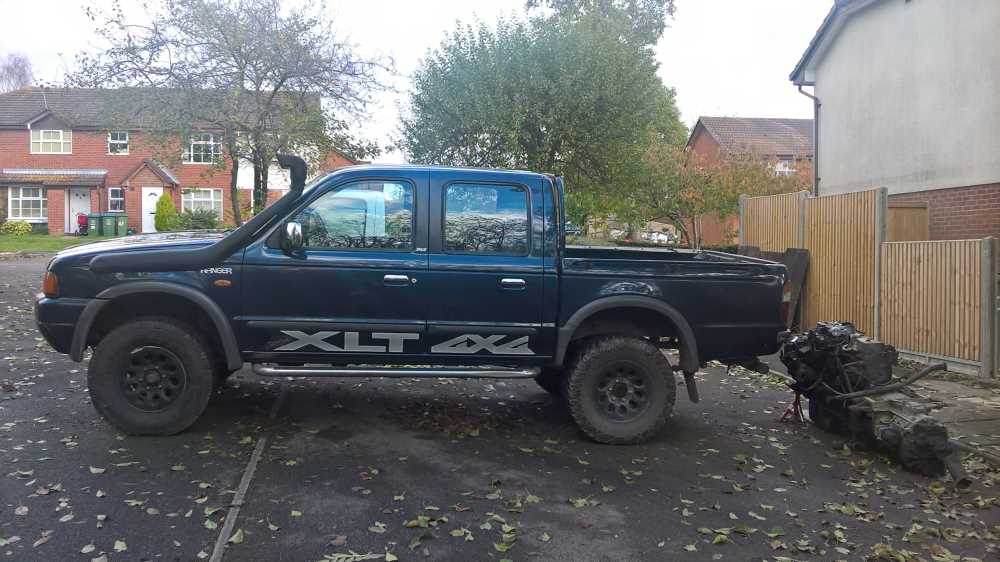

And here is the truck on 31" tyres (standard works out at 28") with 50mm of lift at the rear and 60mm lift at the front. Body lift and 32" tyres when I can afford it.
And a side shot. Side steps are coming off tomorrow or tuesday
