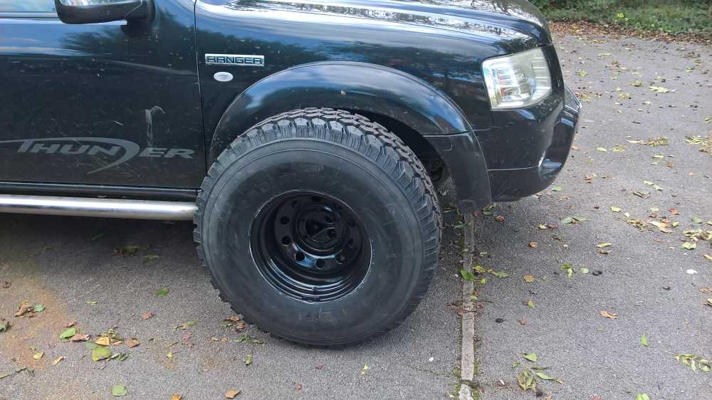

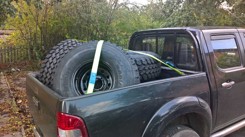

Went straight out and bought myself some 35" x 12.5" tyres on 15"x10" wheels.
They are genuinely huge and will give almost a 20% speedo error. They weigh over 40kg a wheel too

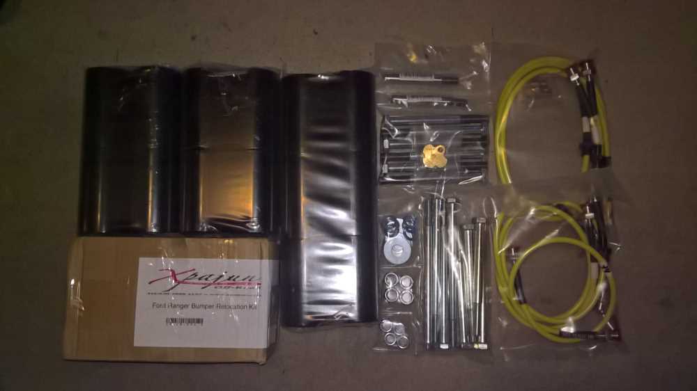

Obviously to fit the huge tyres I need more space in the arches so I had this 4" body lift kit delivered.

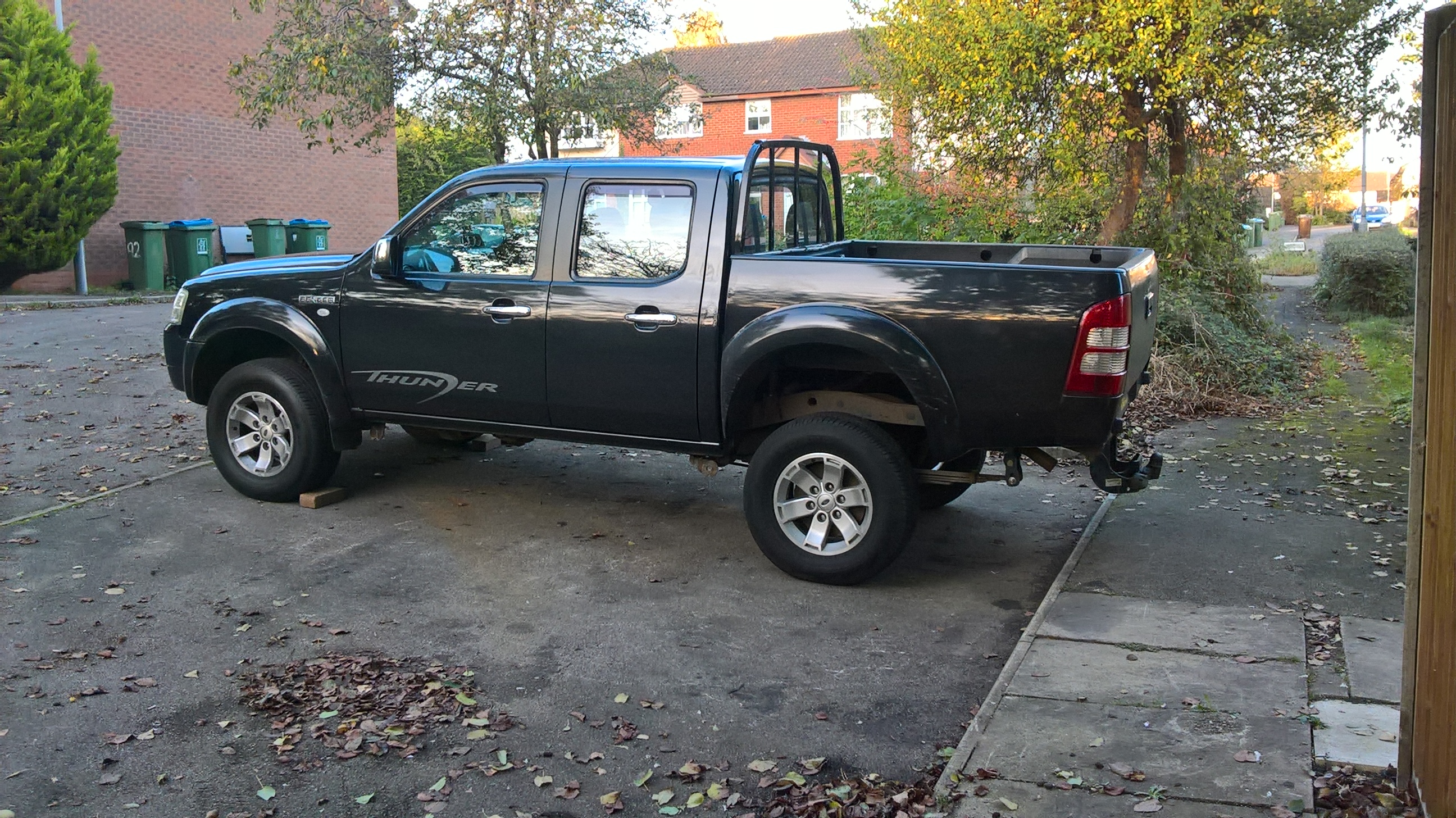

Busy day today, serviced the truck, did a 2" suspension lift all round and started on the 4" body lift by doing the rear.
Right pain in the cock in places not least as the spacers weren't drilled big enough but I didn't have the right drill bit to do it myself so had to file them out with a hand file.
I'm sort of thinking that I might have gone a tad far but in the words of Carol Shelby, "Too much is just enough"
Front lift tomorrow and I know it's gonna be a pain in the cock but it does mean I can get my huge tyres on.
That is some lift.
Wheels look small now.
Interested to see the finished result.
Sold in ....5.......4........3..........2.........
GTI6 Info
(13-10-2017, 08:33 AM)mr_fish Wrote: That is some lift.

Also I have big wheels, 35x12.5 on 15x10 ET-32 wheels

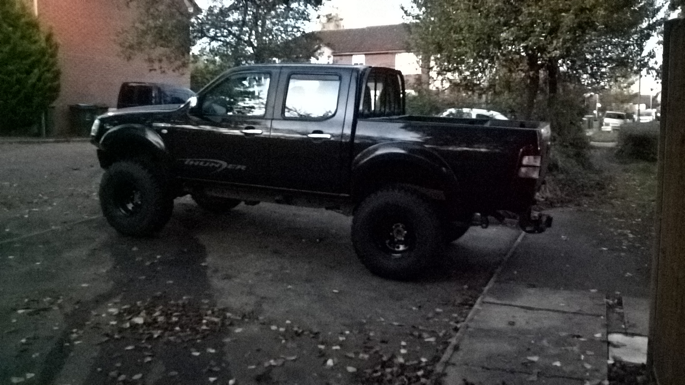

Another 8 hours on the truck yesterday got the lift kit actually fitted to the front
And as it was getting dark fitted the wheels for lolz
Still got some bits to do, mainly refitting the rad with longer hoses and praying my plan with the steering shaft extension works.
Needz bigger wheelz! Can still see the chassis ??
A few pictures in the daylight. Not finished it yet as I f*cked my knee slipping in the bath.
Main issues are sorting the steering shaft (lengthening and adding in a second UJ) and fitting the rad with longer coolant hoses.
There's just loads of little bits and bobs that all take an age to figure out holding it back from hitting the road.
my christ, high roller much?
whats happening with the front bumper? chopping up? or will it clear what you want to do?
(16-10-2017, 08:15 AM)mr_fish Wrote: my christ, high roller much?
Front bumper will need a slight trim of the arch extensions at the bottom edge but no more. I've kept it off so I can get closer to work on what I need to finish in the engine bay as it's so high now being able to get close matters.
