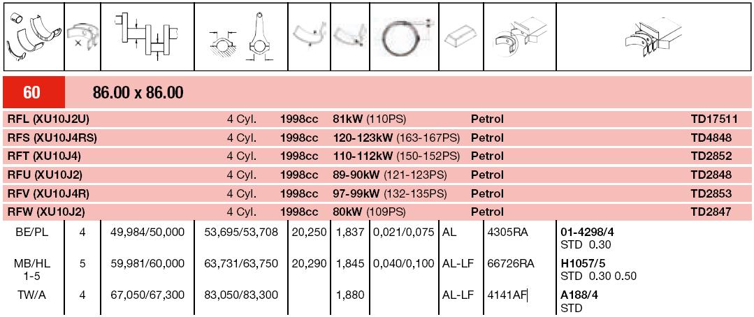

#44
welshpug do you know the tolerances + - for the crank big end and mains for std bearings?
GTI6 Info
#45
not offhand, they're in the Haynes manual though.
TBH seeing as you have it apart I would throw in a set of std bearings anyway, and see how it looks with some plastigauge.
#46
plastigauge? i will have to see what that is and how to use it i usually micrometer stuff up Wink
GTI6 Info
#47
its more accurate and very very easy, its use is actually detailed in the haynes manual too.
http://plastigauge.co.uk/
you need the red/orange stuff, for the closer tolerance ranges, and you simply build each bearing up with a strip of
plastigauge across the journal, torque to spec, dissemble and check against the gauge how much its been squished.
#48
for the big end (BE/PL) is that telling me the plastigauge should read between 0.021- 0.075 mm to be within std tollerance on new std bearings
and
for the mains (MB/HL) is that telling me the plastigauge should read between 0.040- 0.100 mm to be within std tollerance on new std bearings
GTI6 Info
#49
I've had new mains and big-ends turn up also the red plastigauge
ive been out and fitted the new mains to the block and plastigauged them all 5 main bearings
they have all come back to 0.076mm on the plastigauge
so if the tollerance for the bearings is 0.040 - 0.100 i would say the mains are within tolerance Smile
now to do the same with the Big-ends
