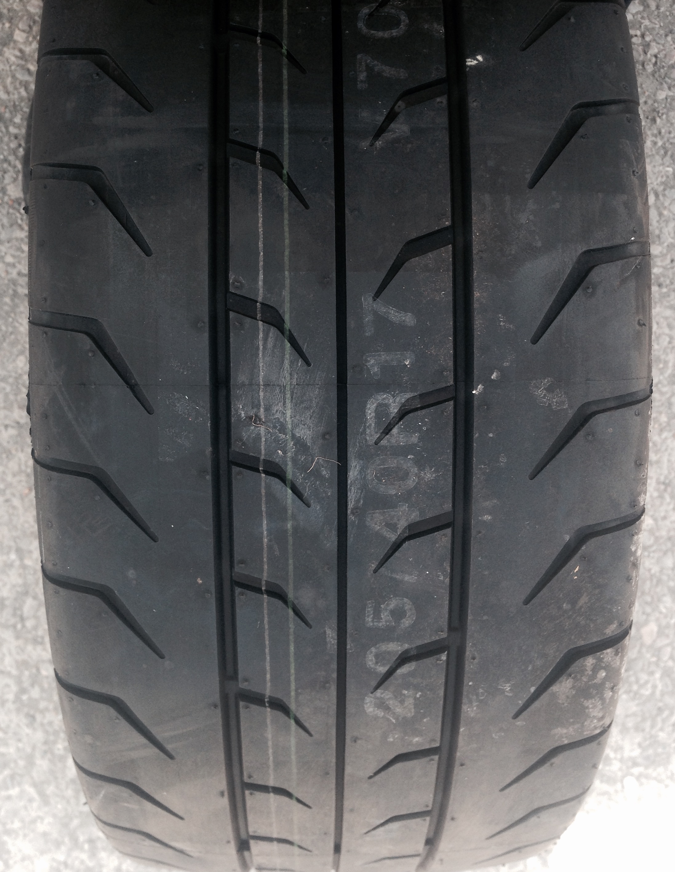

Well they are Supersofts & not much Tread ....have to wait for Pugfest to give them a bash

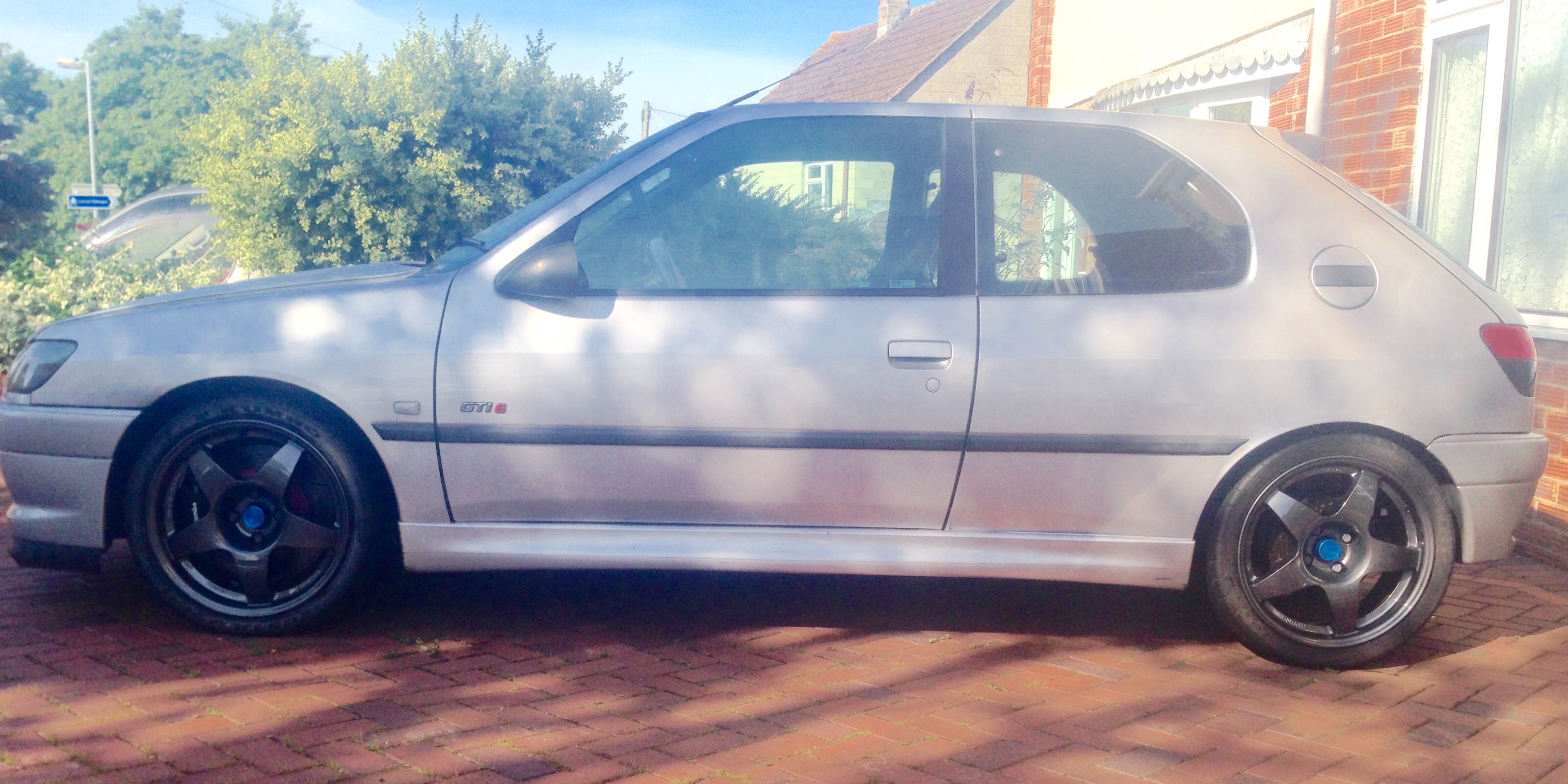

Got the Tyres fitted to the Wheels !
Don't like the blue anodised hub caps ?
The Tyre fitter remarked they were more of a pain to fit than the DZO3Gs

Just took the car out for a 3miles fast lane drive & Tyres gripped instantly....set them all at 30psi & stopped to check them after 3 miles 32-33psi & they have picked up all the lane Debris sadly !
I recon I'm going to need to put a pair of my old wheels back on the fronts to get to Pugfest next week or the tyres will be bold by the time I do 38miles  Speechless

I loved them when they were White but just to high Maintenance with DS1.11 brake dust ....the greys much more subtle for my age & they look clean 80% of the time now ....
Not so flash !!!
They look much better in the flesh than in the picture !!!
Not sure about the blue centre caps may put silver ones back on ....not buying chrome / Plastic ones !!!!

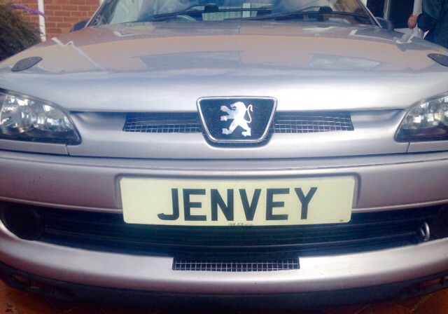

Just got given loads of Jenvey asst stickers & a Temp No Plates for Pugfest  Inlove
With what Nigel from Jenvey UK has done for me how could I say No ?

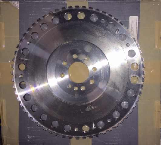

1. Helix 4 paddle clutch & Helix cover ...big thank you Rich w
2 .Rich W flywheel ....big thank you Rich w X

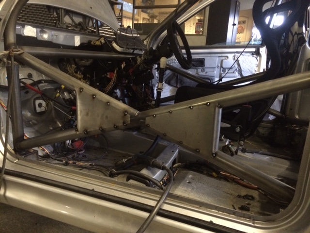

7 Mike Edwards Full welded in cage ...big thank you Sandy x

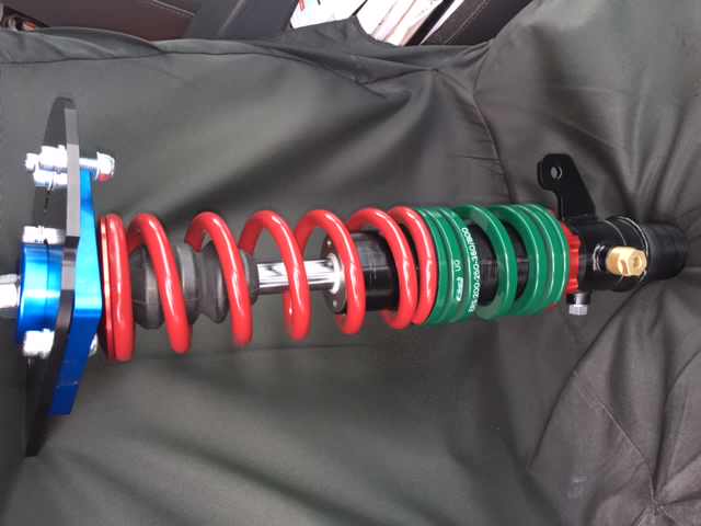

New Fromt Suspension
Lightened flywheel ...exactly half the weight of my standard 6 one !
Nothing really special here lots of you have seen or fitted one from Rich W ...LOL

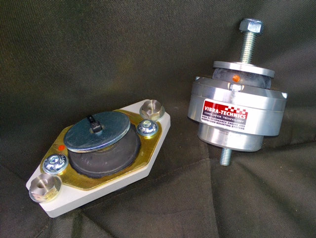

Forgot to post these two items ....competition engine top mount & Gearbox ones not the Fast road ones that look the same ...As Roland Rat said ..better hope I've got no fillings LOL
Got the gearbox mount one fitted already Thumbs up

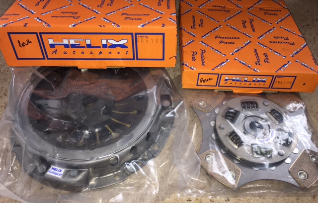

Helix sprung 4paddle with Helix back plate
Mike Edwards fully welded in cage with door bars

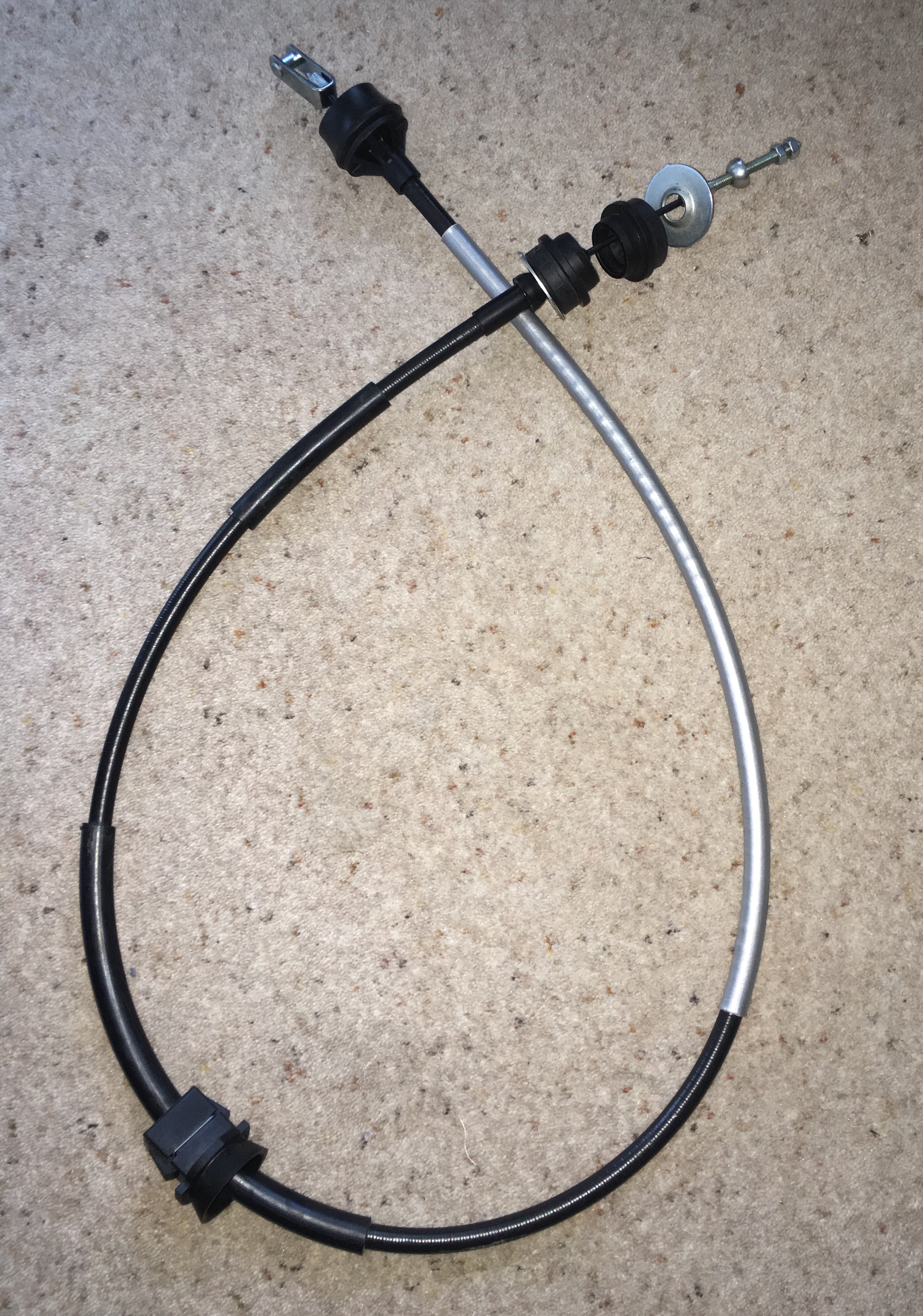

Right small update ....collected my new remanurfactured clutch cable .
All ready for my Helix Clutch & Pressure plate ..
Speedycables in Swansea took a new 6 clutch cable I bought from ECP for £24 & made both metal ends & took the automatic adjustment out & used most of the outside stuff ....
Charged me £59 inc vat & delivery ...
Hopefully that sorts out the weak spot on the cable ?
Now also have metal ends for the throttle cable to the pedal also similar to the clutch end .
