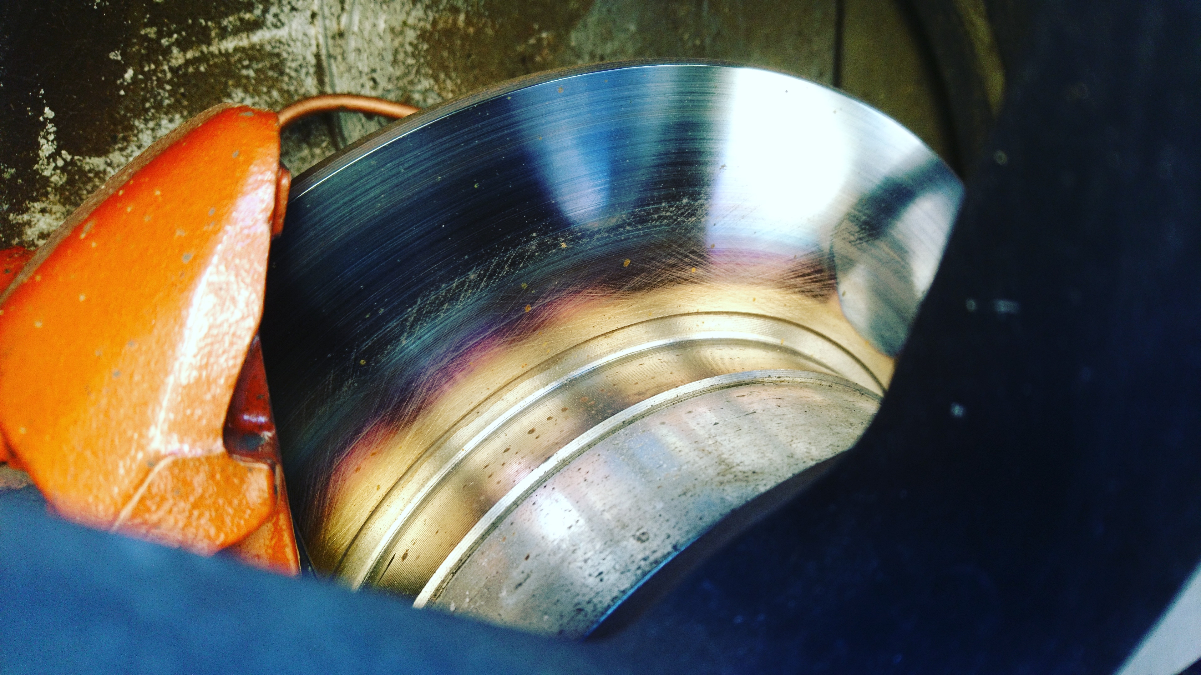

Rear brakes "bedded" in;

been doing some rapid stops?
some blueing there. often seen on m/c exhaust headers.

Yeah... Quite a bit.. plus fronts are not up to it .. so ABS system is obviously compensating by using rears a lot
Yep, those brakes got nice n warm!!
