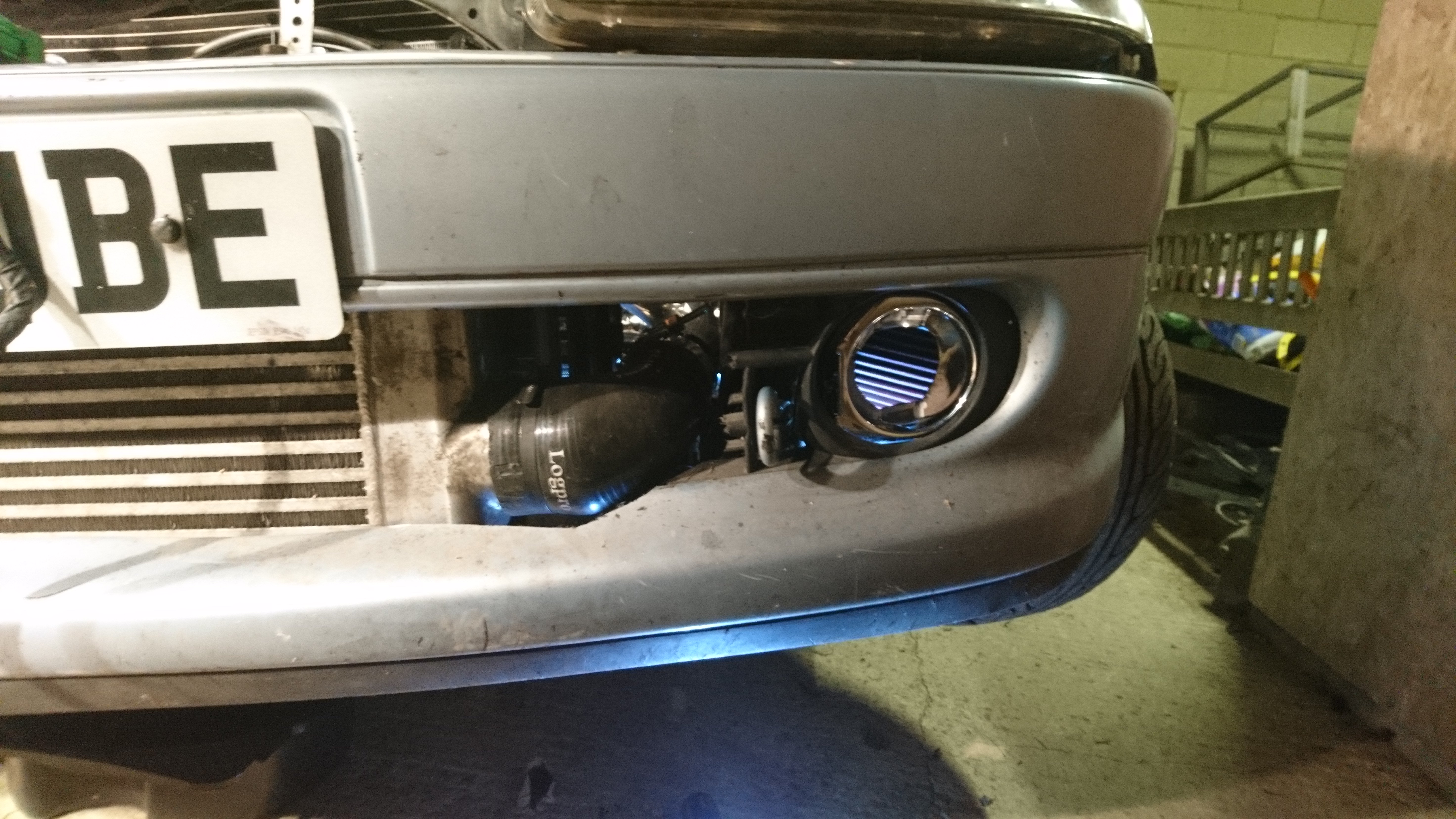

Now I know what's what.... I'd definitely consider dropping a 16v head on any 8v HDi before considering a turbo upgrade.
Couple things done today...feels like we are nearing the road testing!
Air filter/intake setup done, minus two jubilees.
Aux tensioner replaced - very noisy.
All arch liners and splash guards trimmed and fitted.
Washer bottle 'trimmed' and fitted.
Need gauges, service rear brakes couple other things and limp mode fix obviously...and ready to go
