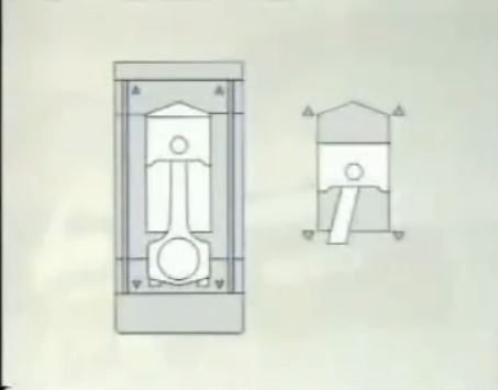

Thought it was like this, because the bolt channels also allow oil through them as well ?
Edit: Went full retard, just watched a documentary video on the k series. didn't mean the sump meant the bottom part
http://www.youtube.com/watch?v=8f8NfAfqev0
[Image: mcetg0.png]
