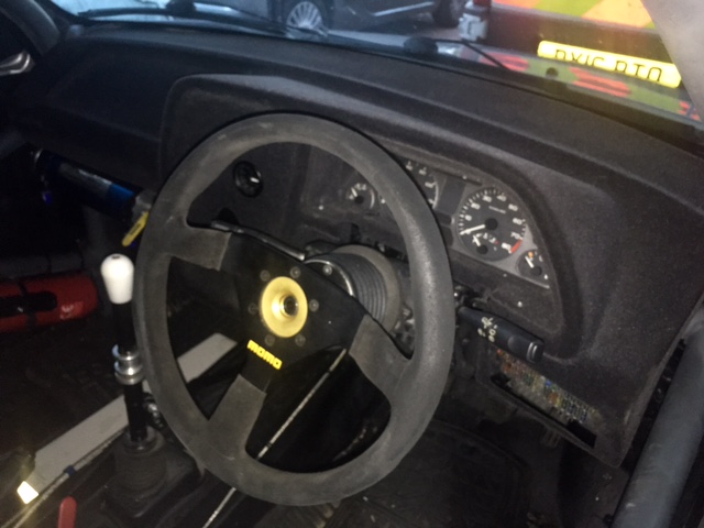

Been asked about fitted pictures of Ryan's Fibreglass dashes ...he's on Facebook & mainly The 6 forum ....
Another
Another
Another

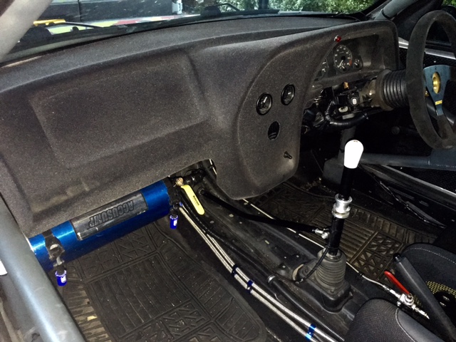

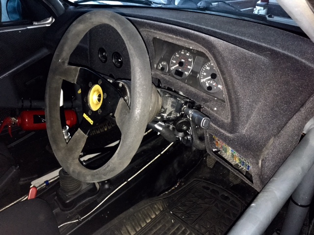

love the look of that dash!
(03-11-2016, 09:16 AM)bilboaustin Wrote: love the look of that dash!
Well thank you ..it looks nearly standard but 19kg saving but no heater sadly ..Ryan ...Pug_306 sells them
They are Now on Ebay or half dash version or contact him on 6forum he bought the mould off me ....it was a one off NOT now  Rofl

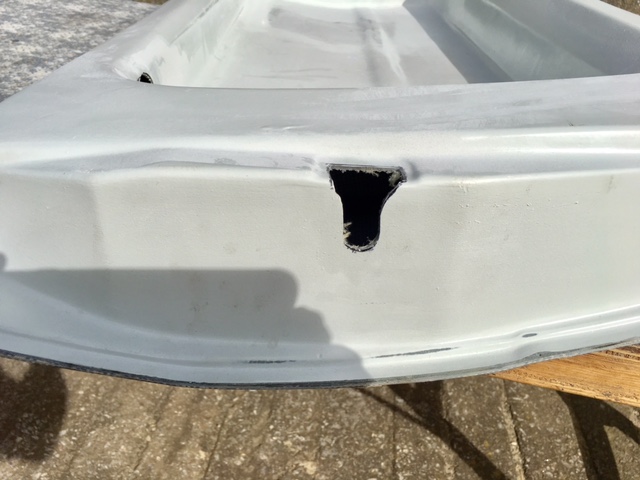

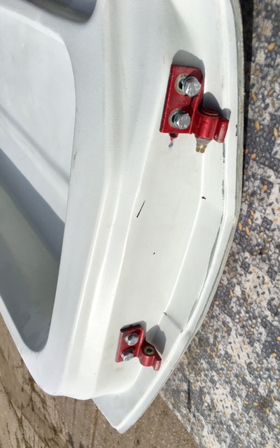

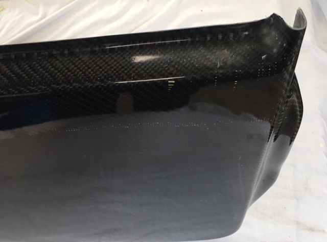

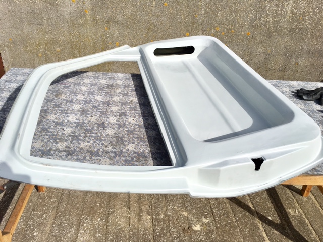

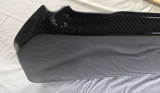

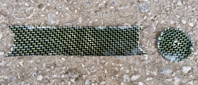

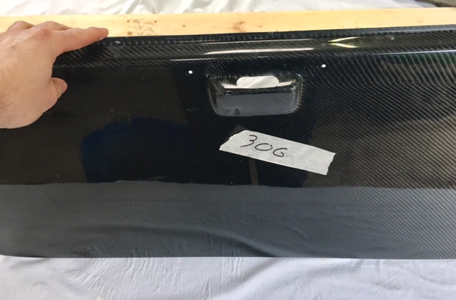

Kevlar/ carbon composite doors & Carbon Fibre door panels have arrived & ive been working on Passenger side first ...
They have alloy 8mm plates I've had to drill through that are sandwiched between Kevlar where hinges bolt for extra strength...
It was a ballach getting the hinges located in 95% correct height as no real template from original doors matched ...I got them just out height wise by 5mm meaning I had to drill x4 more holes again ...no big issue ....amazingly & im shocked the doors fit as good originals & are even stiffer at the top where the thieves normally bend them out...

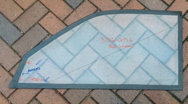

I'm going to be running Polycarb AR windows with 210mm square sliders bonded & bolted to the front doors & the size is much smaller than standard Polycarbonate standard door windows so I've made a template without opener just to make sure they are 100% made right all pics below

Hinges
Door side view
Lock cut out
Trial fitted on my m8s scrap 306 ...fits so well
100% Kevlar / carbon mix ...good to know
Each door weighs 6.3kgs instead of 27kgs each standard ones so 40kgs ish saving

Completely shaped to fit around the sides of the doors
