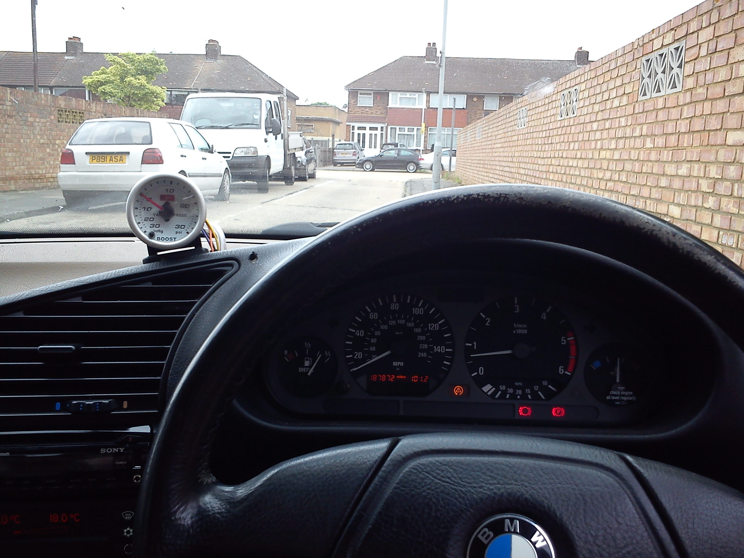

Boost gauge is fitted and Im glad I did as Ive found out why it was trying to stall on gear changes when cold. Basically the boost hose from the manifold to the MAP sensor wasnt plugged in. So thats all fixed now and Im peaking at 18psi and holding a steady 16psi all the way past 4500rpm.
[attachment=0]
Just gotta work out its random cutting out problem.
