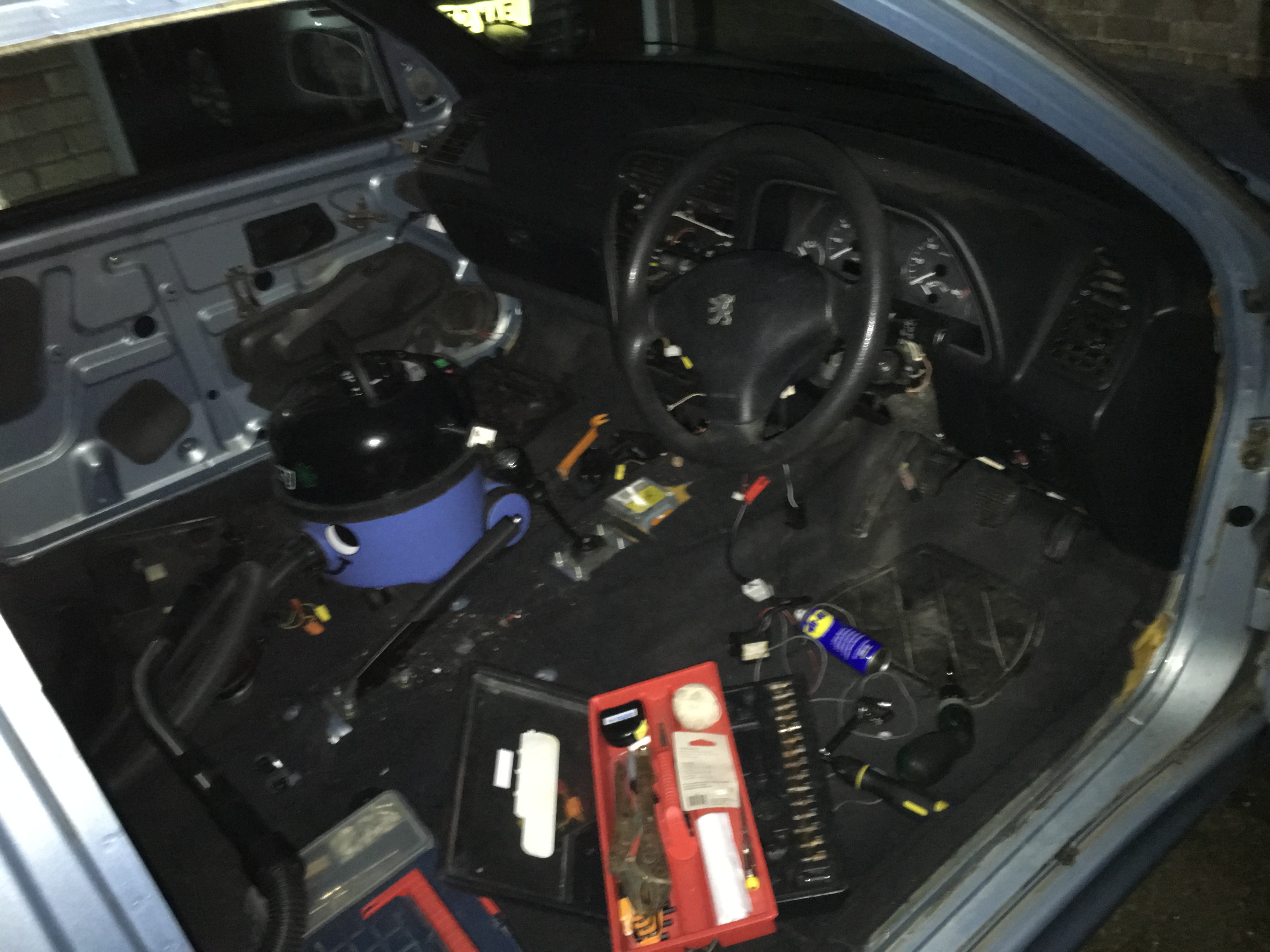

So I spent a couple of hours on Friday and pretty much all of today removing the interior.  It wasn't actually that difficult as I'm used to torx screws shearing off and bolts being seized on the Clio yet everything seemed to run smoothly until removing the last bit of carpet which I cheated on and cut with a stanley knife as it will be hidden when the centre console goes back on.
I started by unbolting the rear seats followed by the fronts hoovering as I went.  As it turns out the front set had a bolt missing and the rest were pretty loose so I'm glad to have found that out now.   I made sure I bagged up all the parts separately so I can have half a chance of putting them back where they came from.

It started getting dark so this was how I left it on Friday evening.
