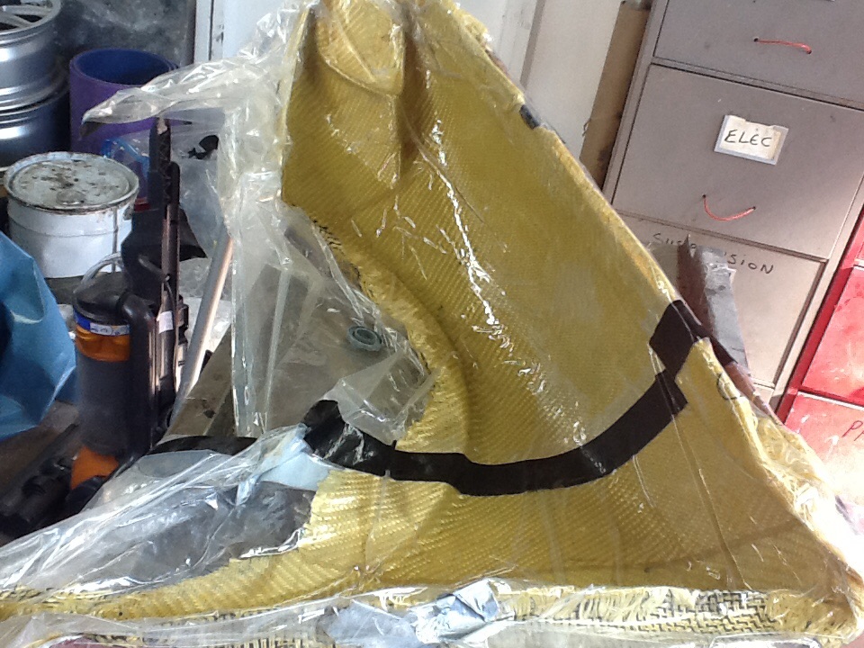

    Productive weekend as mate gnrlee from gti6 / rallye forum came over with his newly acquired dimma/ maxi moulds , so manage to make both back quarters and both front wings , these are vacuumed and made of carbon/ Kevlar and Kevlar cloth , vacuuming uses less resin and takes air pocket out so make mega light as well as mega strong , gnrlee will be producing these using same technique but in fibreglass which will be available for any one wanting to build dimma/ maxi, will add more photos as remove from moulds
