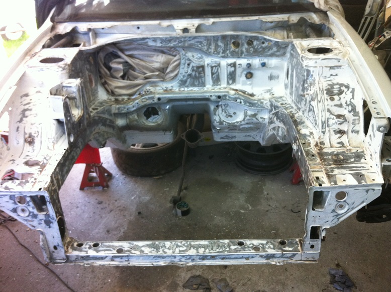

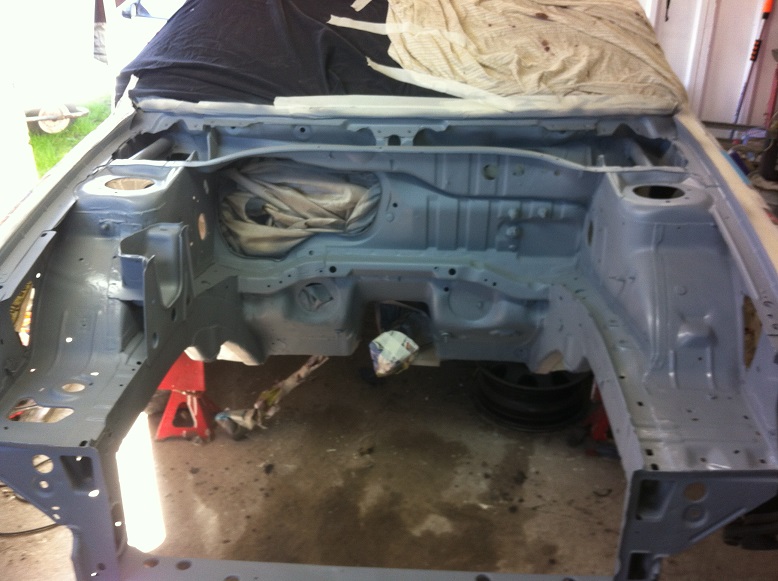

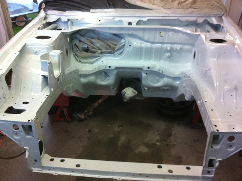

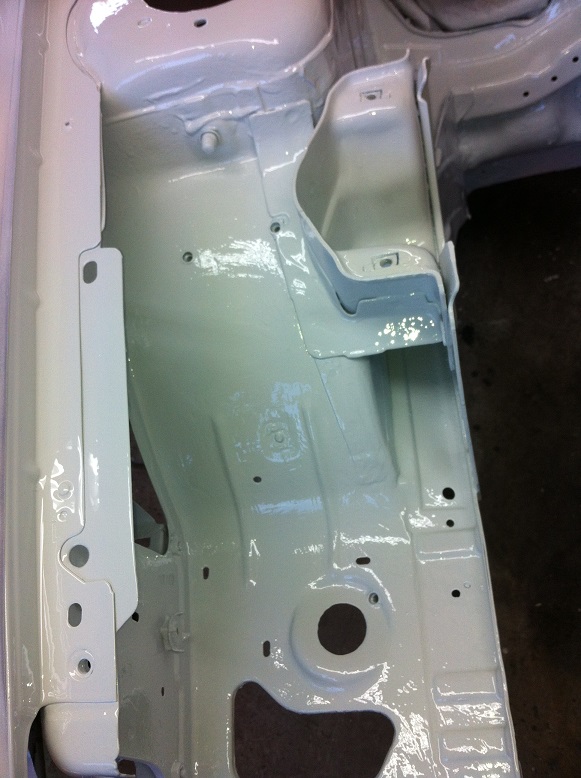

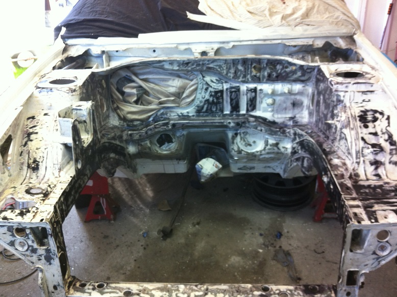

started on engine bay other day , removed engine and box , so engine ready for rebuild now , and soft disced engine bay , then coated with a rust proofer , and gave bay  a good few coat of high build primer , and then scotchied ,then on with the 2 pack bianca white , so all ready for fitting back up anytime , so can clear the man cave of all the bits all over the place
