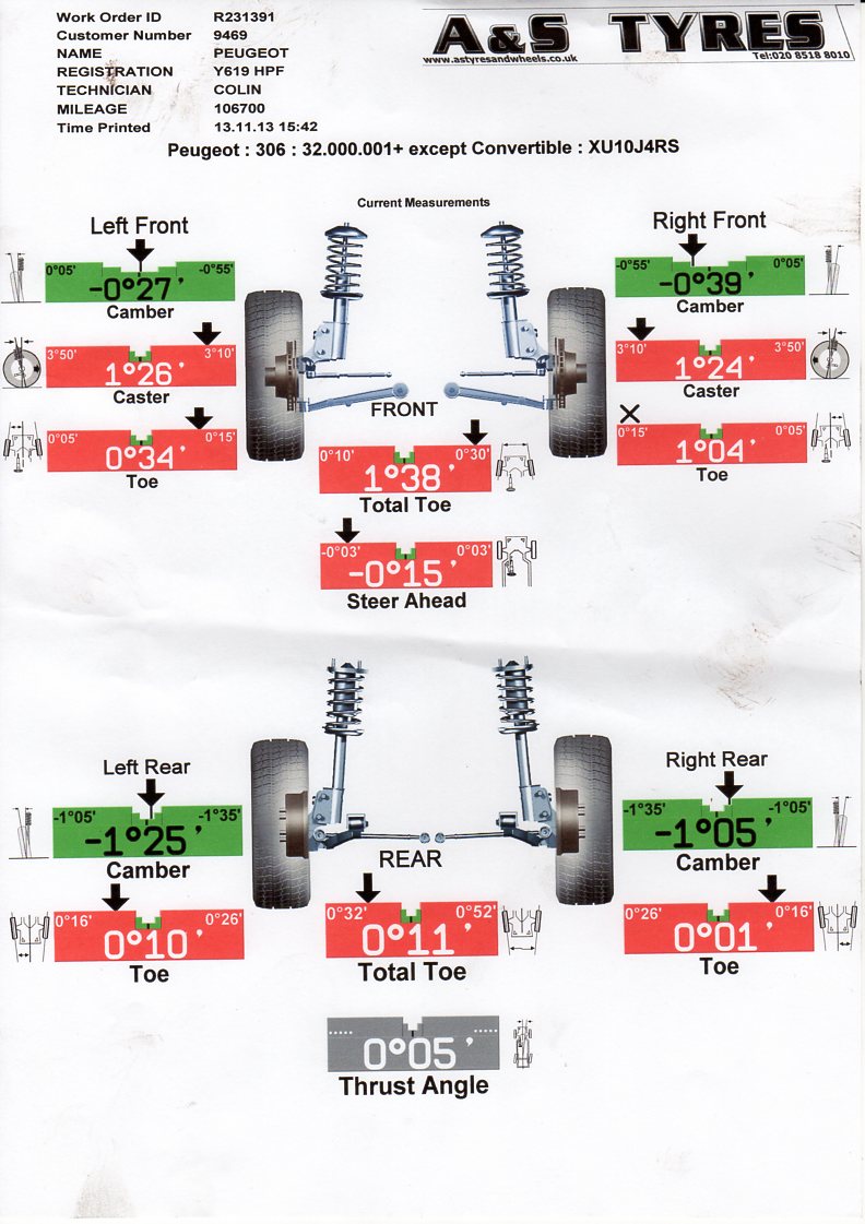

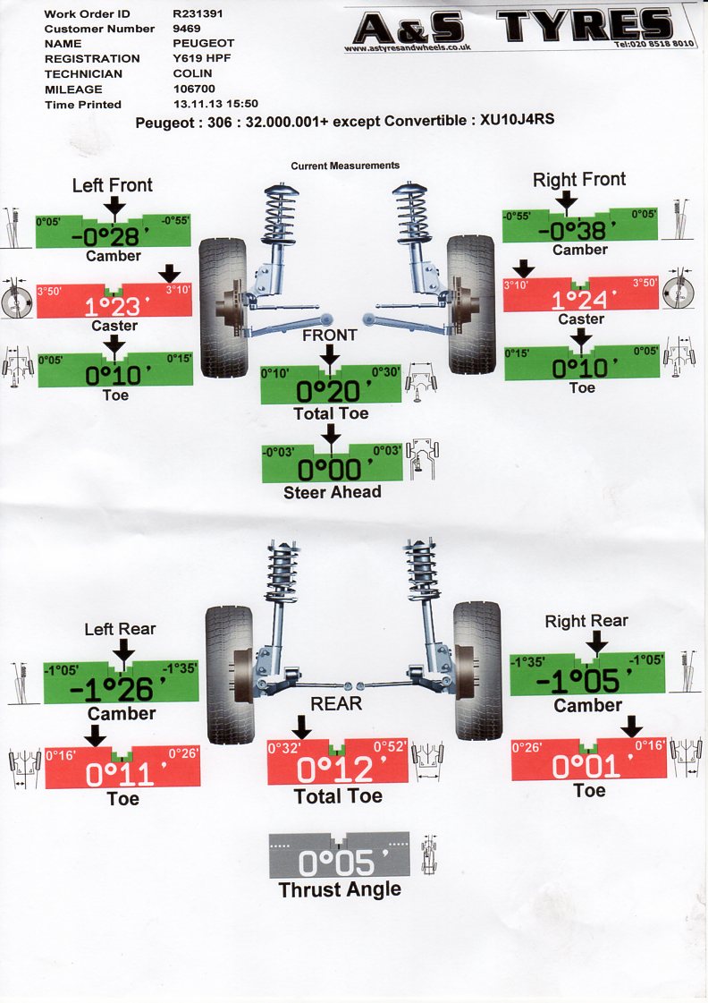

I got the alignment done it's a lot better but its still pulling to the right. Huh
I asked them about the rear thrust and they stated that it can't be adjusted and because it's front wheel drive it won't make any difference.
Anyone got any ideas where I should be looking next?
I am hoping I am not looking at possible bent chassis I haven't seen any signs of damage.
