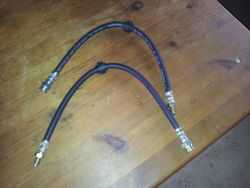

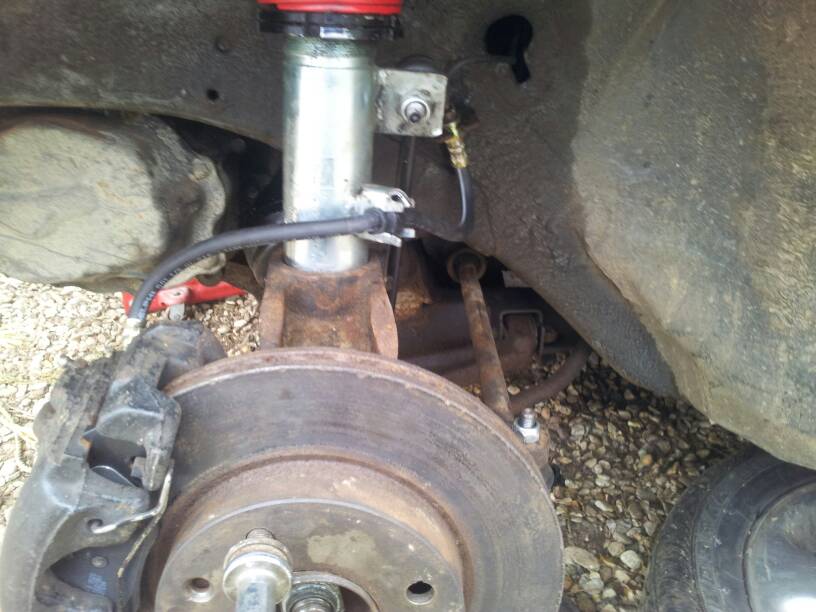

. Have put the loweres axle on from the 205 cti I had all new axle bushes, brake lines and hoses all the way through and also some 306 247mm calipers and discs I had kicking about atleast there vented lol.
Also I was having issues with gear linkages I kept the 306 selecter on the gearbox when I put the engine in what a bastard it is to get out in the bay lol.

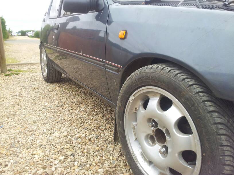

Also im looking for some 14" wheels for this as 15" just look to big but I only have 15's here apart from a set of swallows thats on the mrs car
. Have put the loweres axle on from the 205 cti I had all new axle bushes, brake lines and hoses all the way through and also some 306 247mm calipers and discs I had kicking about atleast there vented lol. Also I was having issues with gear linkages I kept the 306 selecter on the gearbox when I put the engine in what a bastard it is to get out in the bay lol.
