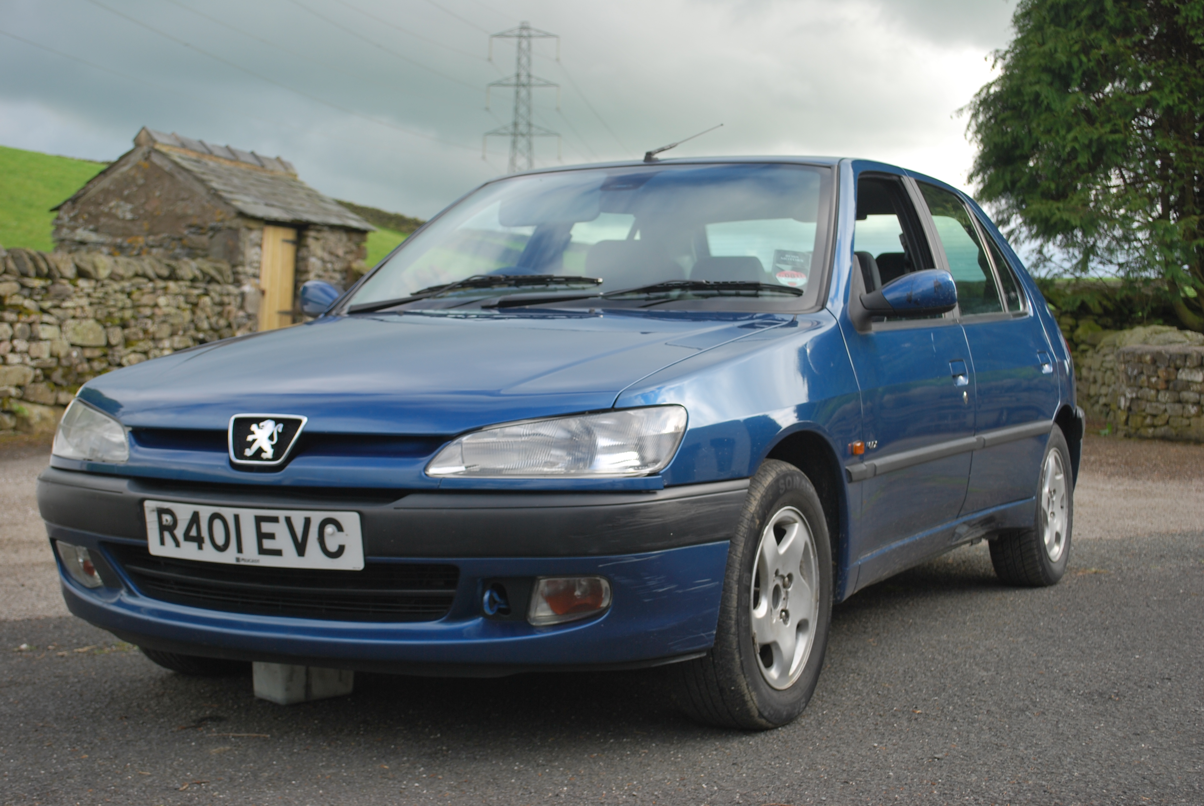

I finally got round to picking up my 306 earlier this week.
It's an R reg, 1.9 TD on 67,817 miles and everything is completely standard, even the brakes unfortunately, as it would be nice to actually stop.
There are scratches here there and everywhere, so will probably need a total re-spray at some point. Will also need to change the seats, think they are a bit of a bio-hazard at the minute. Only cause for concern at the minute is someone decided to take it off roading and has buggered the sump, which is leaking through two bolts as far as i can tell. Should have replacement by this weekend though.

Looks alright, low mileage too!
Those wires in the bay by the fuel pump don't look to standard though :-P
lol Do I spy a tub to catch the oil in??
The wires have something to do with the immobiliser packing in lol I dare not touch them!
Nah mate, comes standard with all of them, doesn't it?

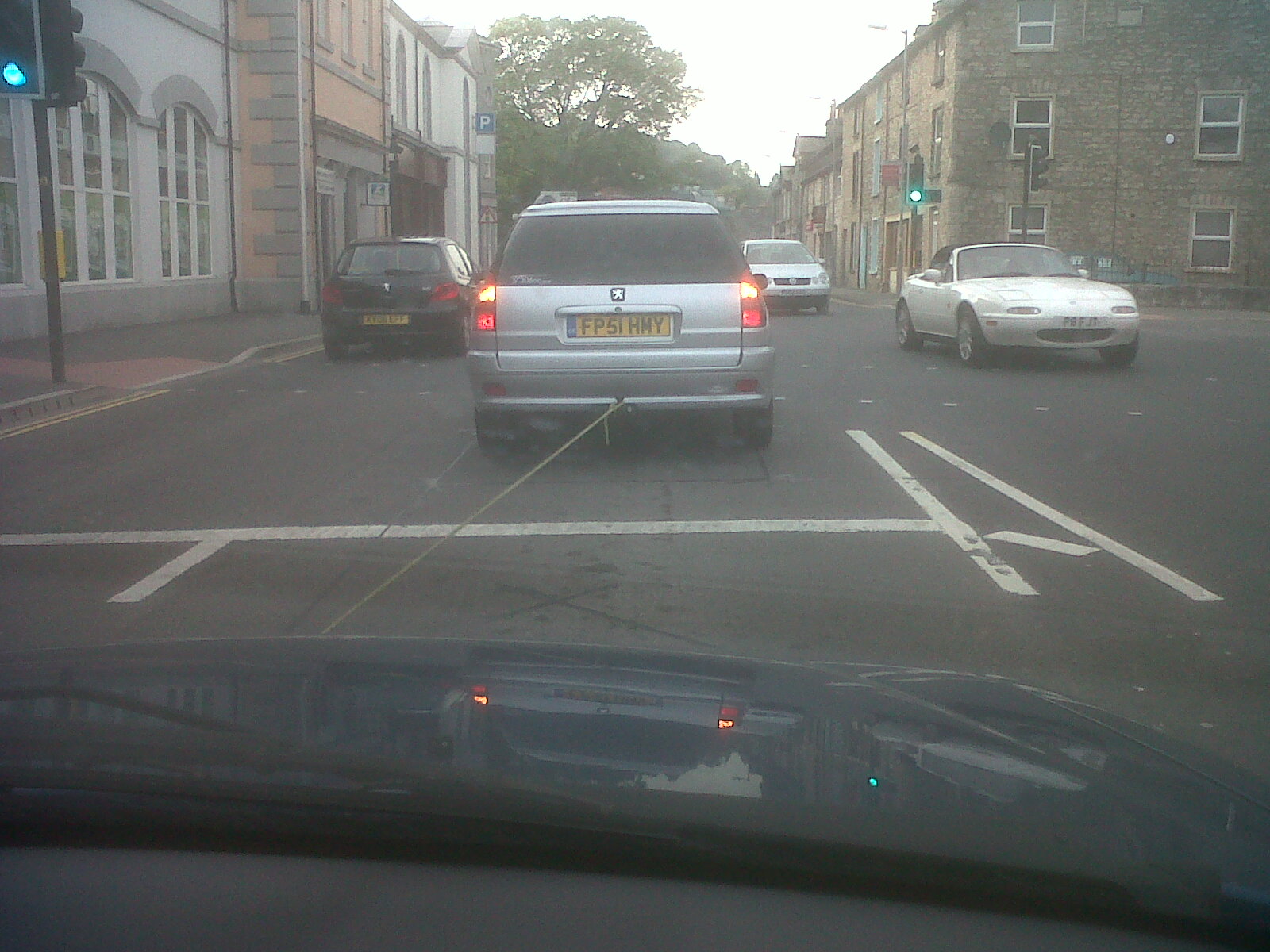

Went to accelerate earlier, then lost all power. Rang Jonny and we had a good look, it seems there's a fuelling restriction as there's no smoke but no power. The injection pump's making a funny noise too :nope:
So we towed it to my house and I'm just going to leave well alone until after FCS, then try changing the pump over for a bosch.
See you all at FCS, I have a stand pass going if anyone needs it.
Jonny towing me through town Sad
[attachment=0]
Fooking gutted mate, I have been thinking about this since you rang,
try locking the timing as the belt may have jumped which would explain it running but no power!
