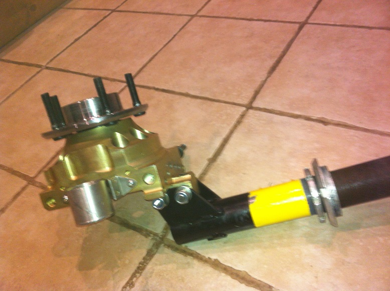

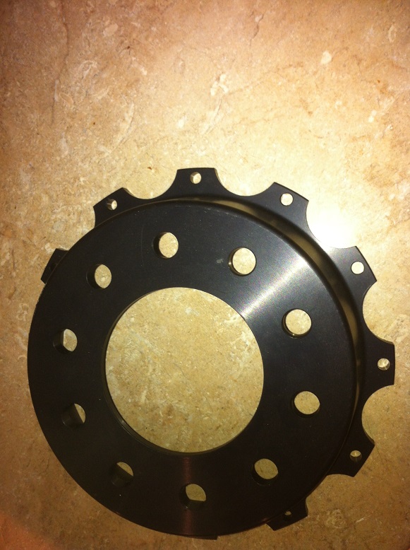

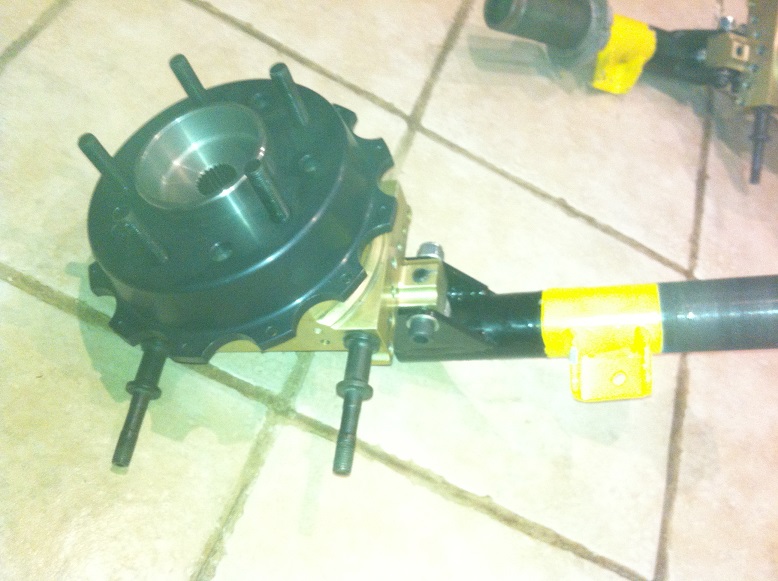

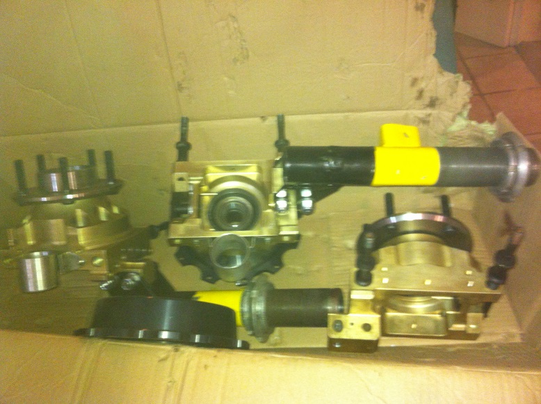

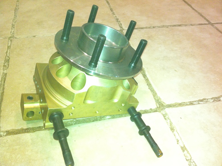

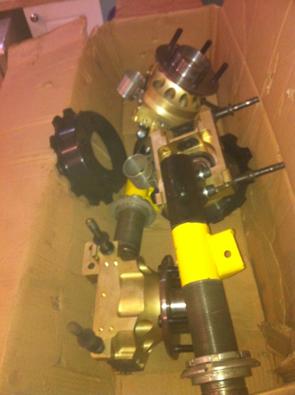

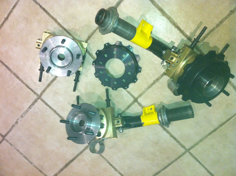

picked up box of front suspension upright for car , all fabrication done and ready for fitting to car , pretty sexy id say complete with new disc bells , hell of alot lighter than the standard uprights
Thats some x rated porn there.

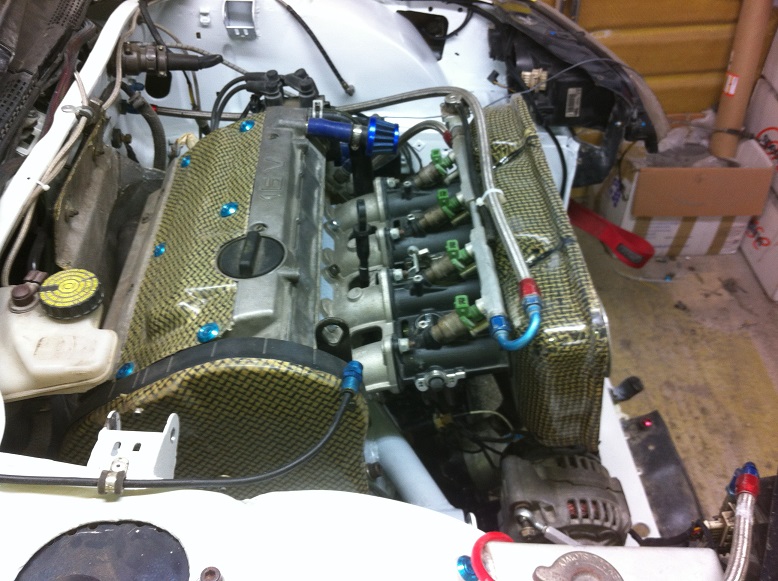

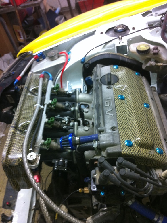

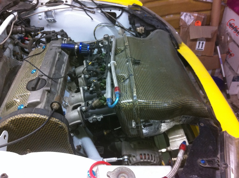

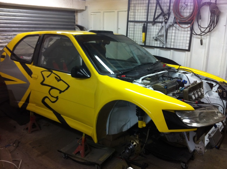

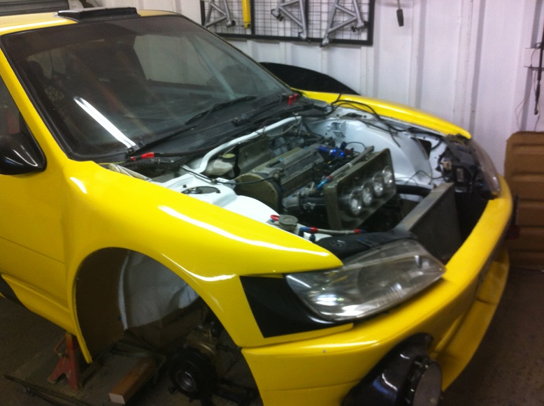

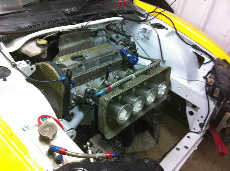

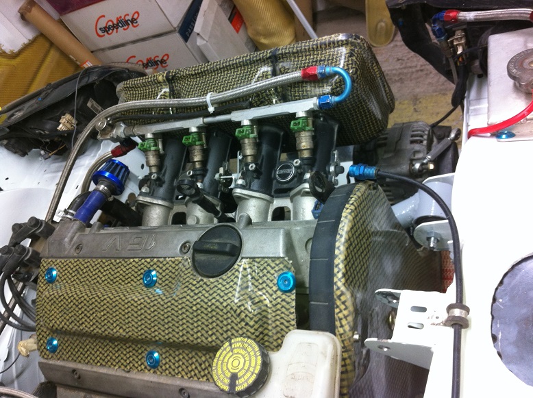

managed to fit engine and box to car , as made new engine mount to suit the chassis mount that i fitted when i tubbed the front inner arches, due to having to remove the original standard mounting point
started  to get a load of engine fitted up over the weekend , starting to come together nicely

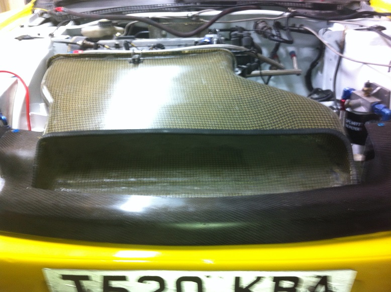

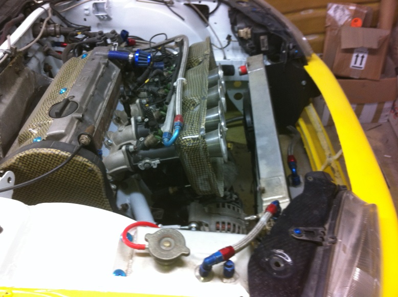

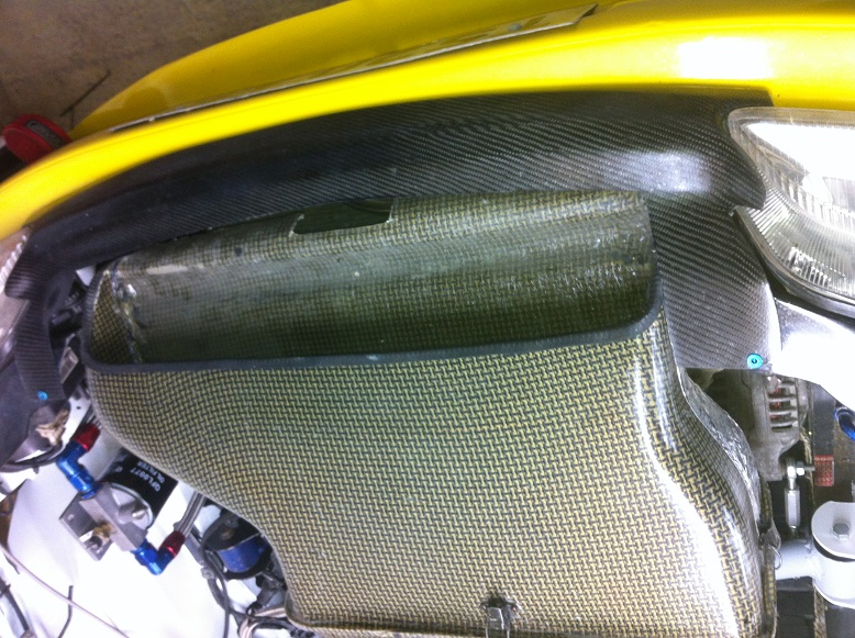

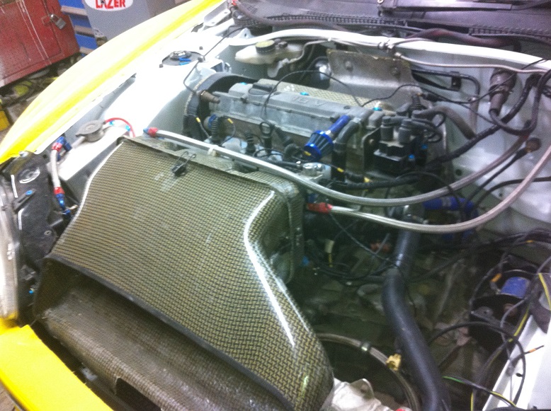

cheers eeyore , have started to fit  carbon /kevlar maxi airbox that i made and fitted radiator and am starting to finish wiring engine bay and fit up all parts  tommorow
Looks good Wayne - how was clearance from your air box to the rad?

(09-12-2017, 06:39 PM)RallyeRed Wrote: Looks good Wayne - how was clearance from your air box to the rad?
Cheers
Iain
Cheers Iain , good clearance from airbox to rad mate  , can be seen in 3rd picture down . Have also heat reflected taped underside of front airbox section

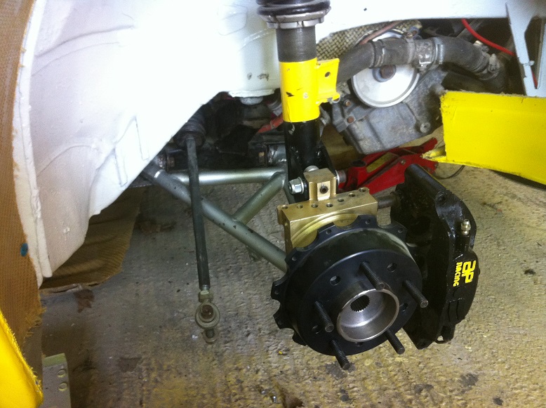

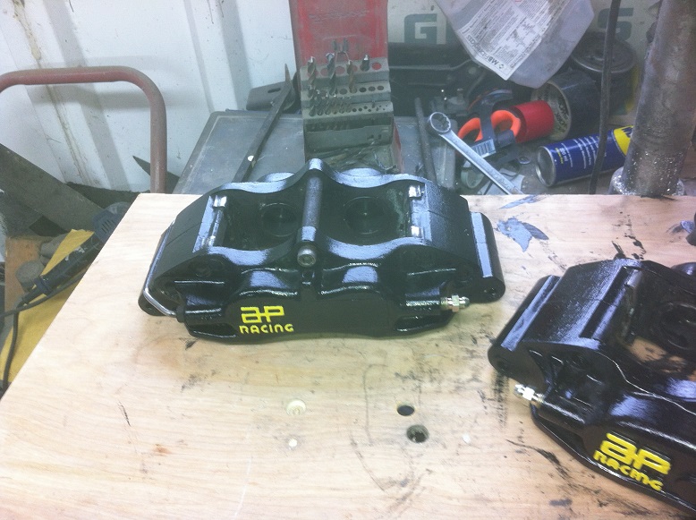

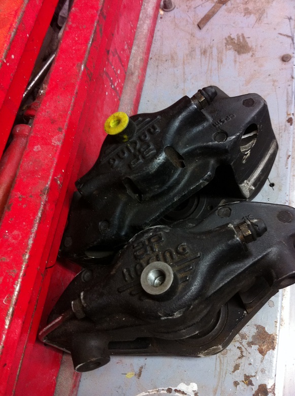

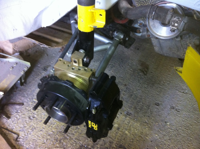

Santa has come early for the car , ap 4 pot brakes for front , and hopefully 2 pot ap for rear , also more new tyres for car to put on rims , this weekend will be doing more wiring , rear beam is getting widened as we speak , will post photos over weekend

(16-11-2017, 09:58 PM)twangy Wrote: picked up box of front suspension upright for car , all fabrication done and ready for fitting to car , pretty sexy id say complete with new disc bells , hell of alot lighter than the standard uprights
What are these made from?
The car looks beautiful by the way  ThumbsUp
the upright are made of alloy , or mag/alloy , not 100% on what material , they are genuine work kitcar item though , also got front and rear calipers now , just waiting on the new pads to arrive and disc rotors

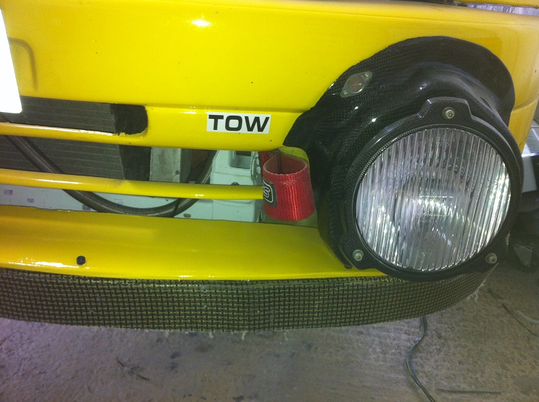

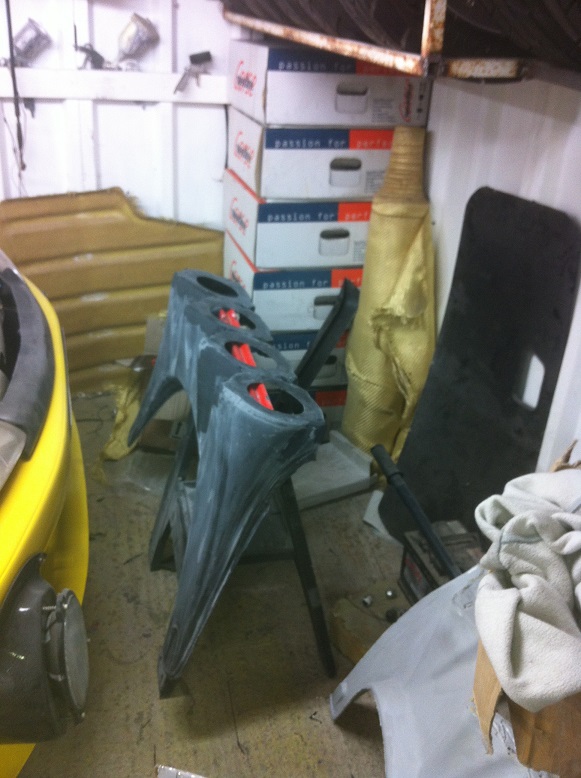

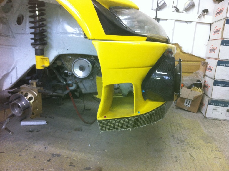

little update  , managed to make mould for bonnet lamp pod  and layed up a carbon fibre one ,  just in middle of finishing flatting it  and fitting lights  ,also  made a carbon/kevlar  maxi bumper lower lip and fitted to car , also fitted rear bumper to car properly and have now removed primed and painted ready for refitting , so thing are still getting done on car
How loud is the maxi airbox set up? Really want to go for a enclosed system on mine to lower noise

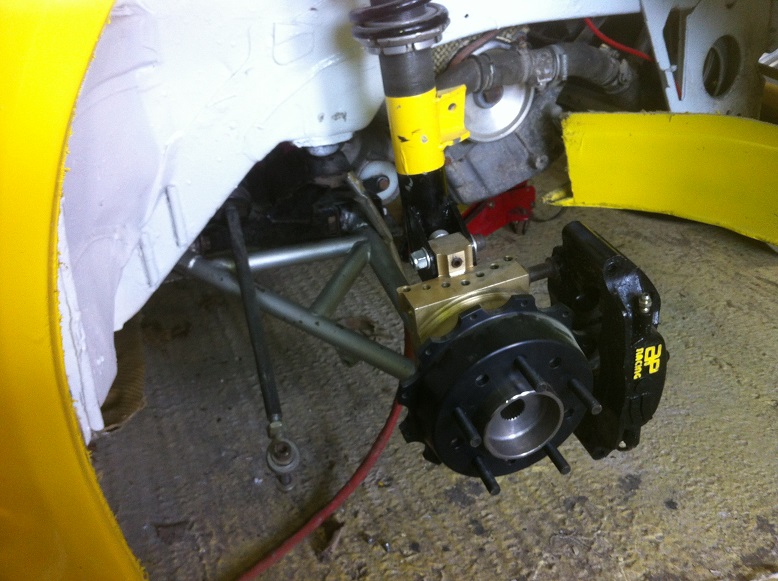

those hubs look magical!
This really is some project! Thanks for the regular updates Smile
(21-01-2018, 06:04 PM)Eeyore Wrote: those hubs look magical!
Cheers eeyore , hell of a lot lighter than standard 306 ones

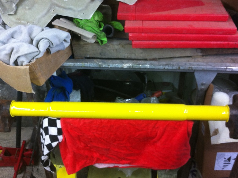

How is the beam being widened?
(28-01-2018, 09:50 PM)PugLee Wrote: How is the beam being widened?
Lee beam is getting widened with new pins made out of higher spec material and alloy spacer and new bearing mounts and drive flanges as on 5 stud  , as soon as arrive will post on forum , also using  bells and  ap rotors and ap 2 pot calipers

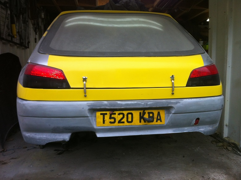

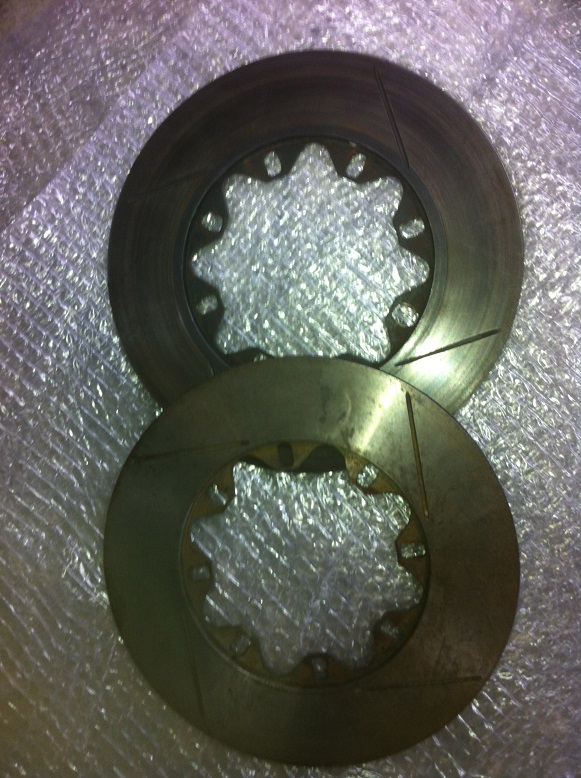

been a bit busy lately for car , but still trying to get the odd hour or two when i can , managed to prep and paint rear bumper and fit , also prepped light pod and painted , put graphics on before paint then removed so its in carbon fibre also front of pod is carbon fibre , outer lights are fitted just waiting on finding inner two ,picture of fully floating solid 260mm rear solid ap racing discs , and painted rear beam ready for rebuild , hopefully get more time on car shortly

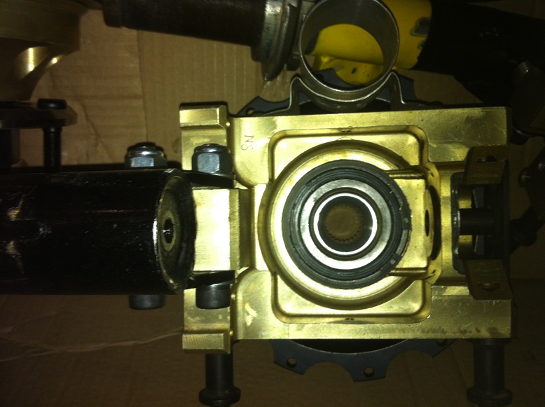

cheers danny , managed to fit the  maxi width tubular wishbone ,just waiting on front rotors now ,and then set up front steering arms , few pics added
