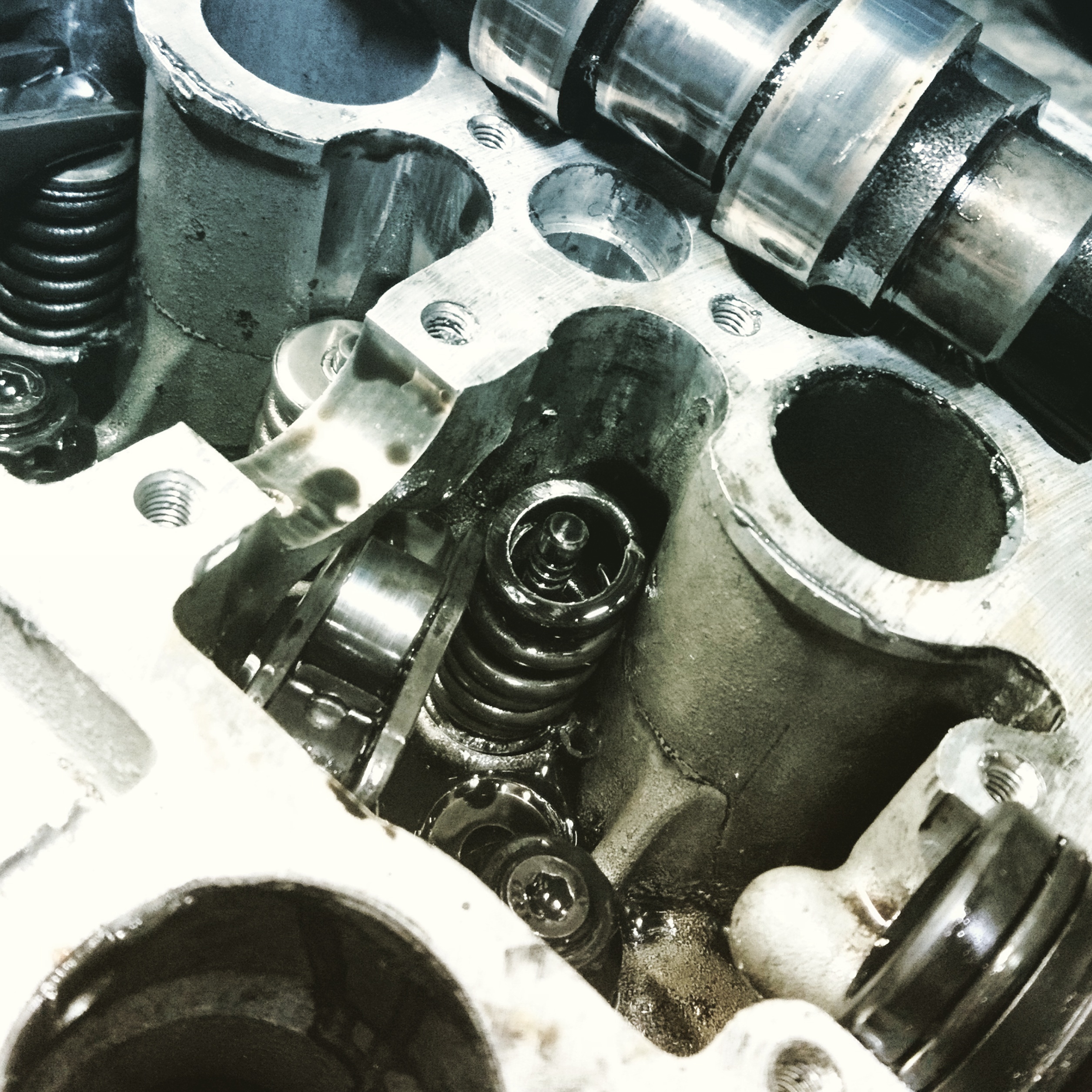

ahh that would do it.
collet unseated/not firmly fitted and pinged out?

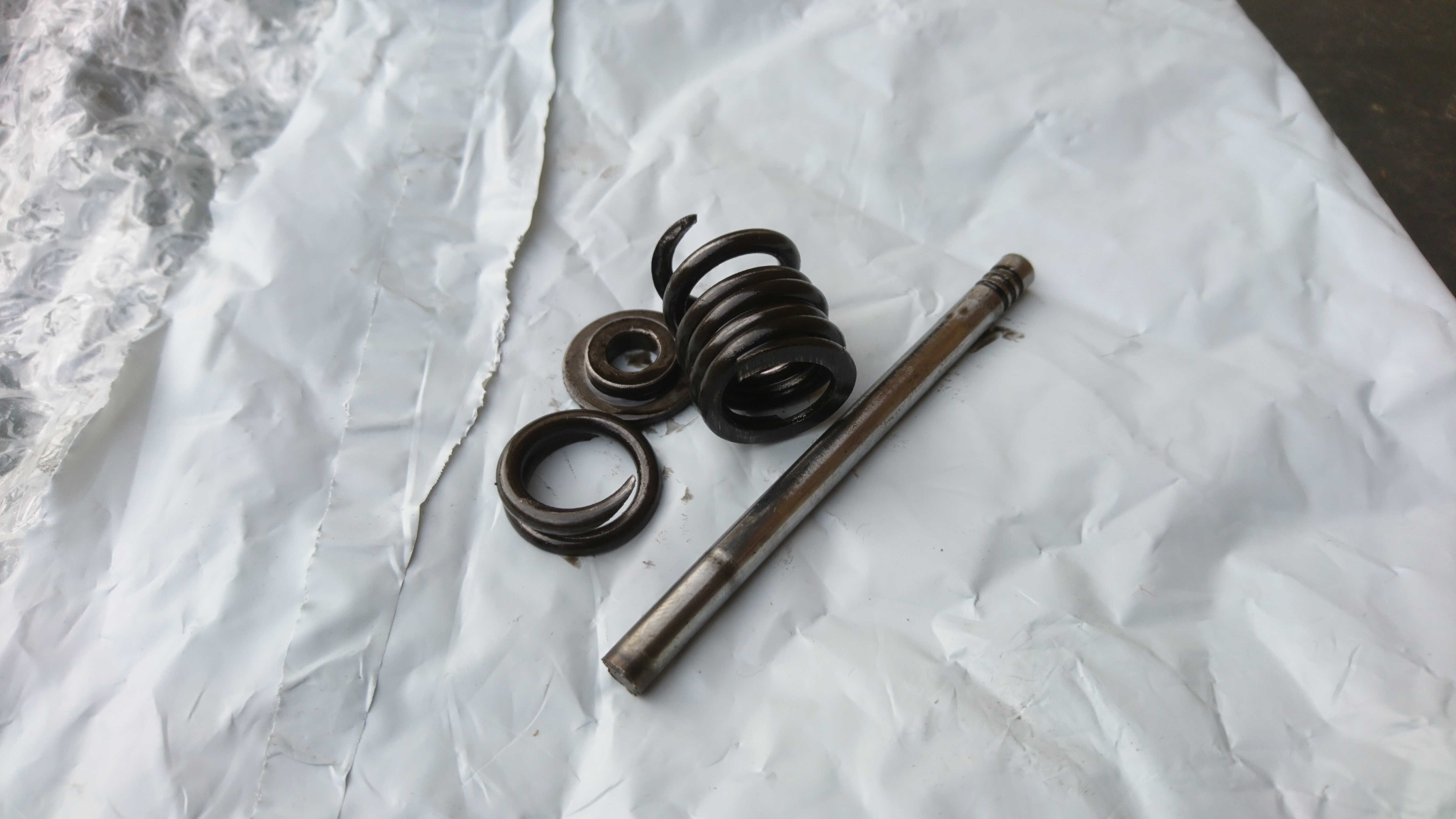

Valve springs cracked FSR - two different engines with different springs had the same failure mode.
Really sorry to see that Piggy. Another set-back you really didn't need. Sad
Oh s**t! Doh   Significant damage to head too I guess?
Head badly damaged. Injector nozzle destroyed.
Valve seat cracked
Any idea why?
Mate... Sad
Genuinely gutted for you mate. Hope this doesn't deter you and you keep on going

Had many offers of parts which is super kind and may indeed keep this going. Company who supplied springs has been good and on inspection of the snapped spring has seen its a material fault
They have asked for a price on parts to put right.
Next step is finding a different company to make springs!

Head not worth repair, valve seat is destroyed but so is the head behind the valve seat.

what kind of spec were the springs? anything from another engine suitable?
seems for the 16v xu's the piper spring set is the same for vauxhall and ford cosworth engines.
(16-11-2017, 11:35 AM)welshpug Wrote: what kind of spec were the springs?   anything from another engine suitable?
Not as yet no, a lot of checking, measuring etc was done to see if same found elsewhere but no joy.
