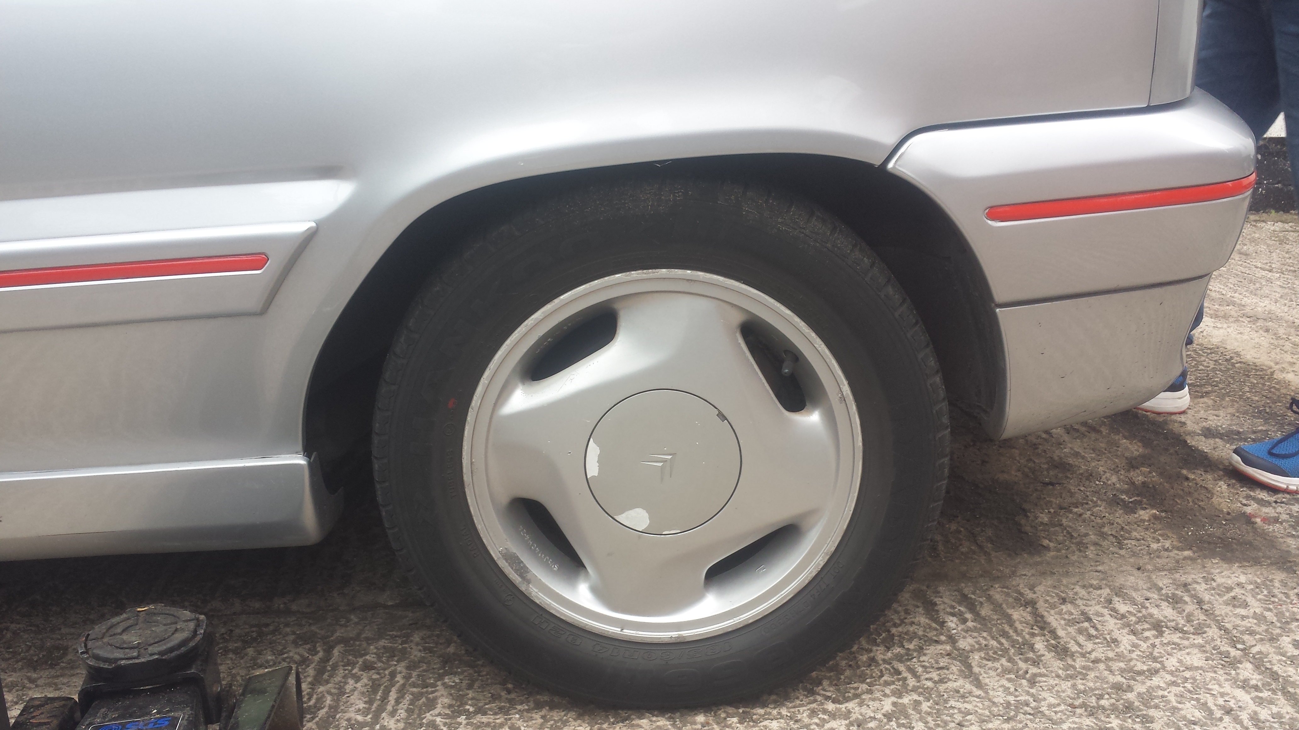

Needed something to do to cure my bordem so lowered the rear to match the front lowered around 30mm
Before
After
It's slightly lower on the drivers side even tho they both measured the same when it was in the air.

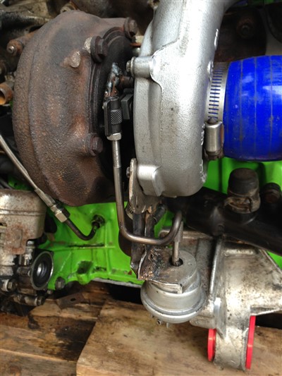

vnt - did you clock the hotside? should be able to rotate it so the actuator points in a different direction and clears the UJ
(16-08-2017, 05:55 AM)zx_volcane Wrote: vnt - did you clock the hotside? should be able to rotate it so the actuator points in a different direction and clears the UJ
Yer I did I clocked it to the point were the oil lines in and out would be as standard. And that's were the actuator sat after that. If I clock it more the oil lines won't be vertical.
Need to get the actuator/boost can/whatever-you-use mounted right underneath the turbo.
The main issue I had with that '56v
But then the oil lines wouldn't be right I think the drain would be pointing directly at the block. Unless I'm missing something? Because the core has to twist were ever you go with the actuator meaning as it sat there the oil in and out lined up right but if I moved the actuator to a different positions it'd mean the oil in and out would be In completely the wrong direction.
Bet you've not seen a lash like this before (for the record, it was made better after i knew it fitted)
(16-08-2017, 10:53 AM)mr_fish Wrote: Bet you've not seen a lash like this before (for the record, it was made better after i knew it fitted)
Ingenious
That's pretty epic ha ha so I see what I've got to do now lol well the waste gate 2052 will be going on for now I'll revisit going vnt at a later date (if I keep the car long enough)

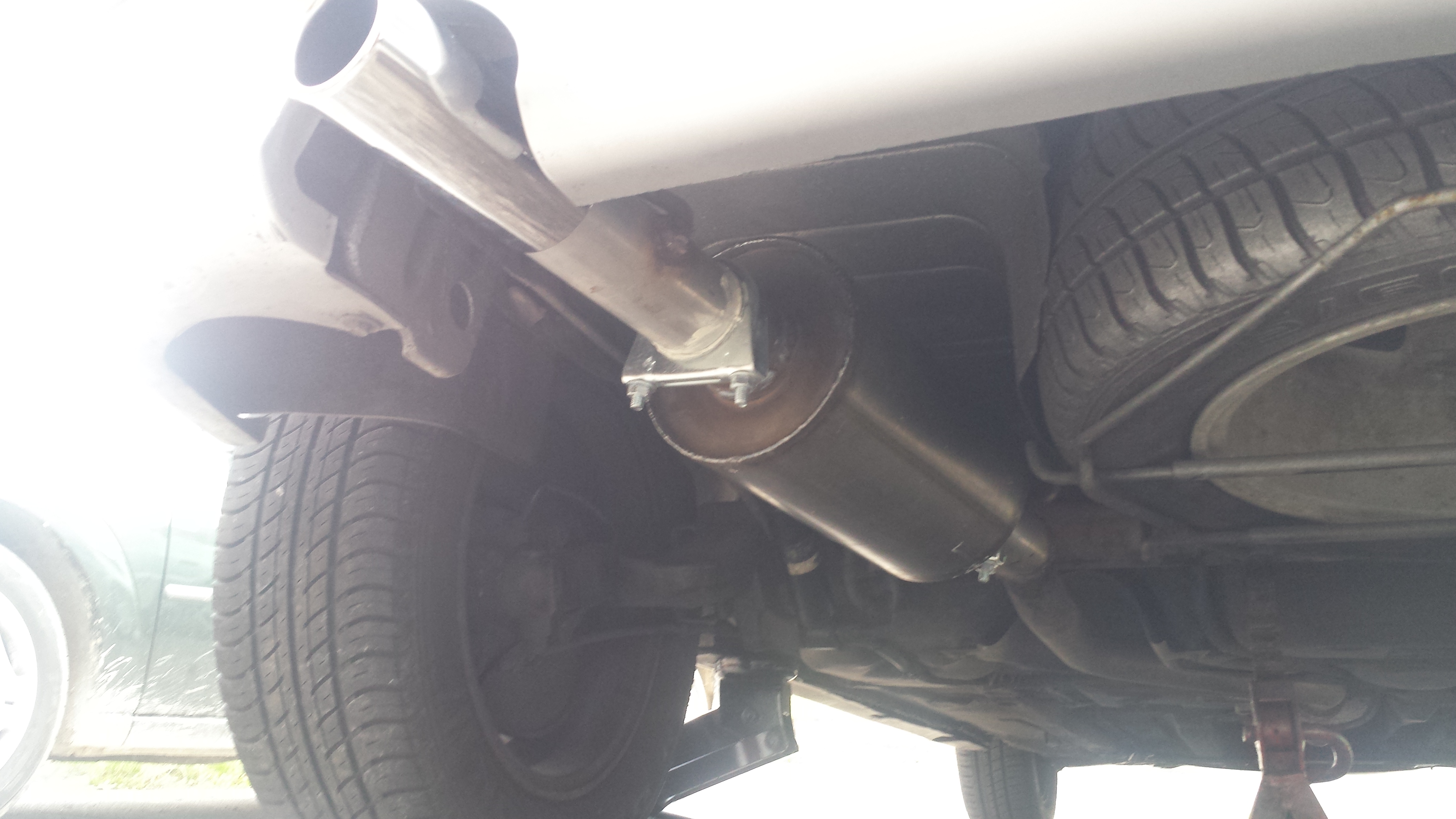

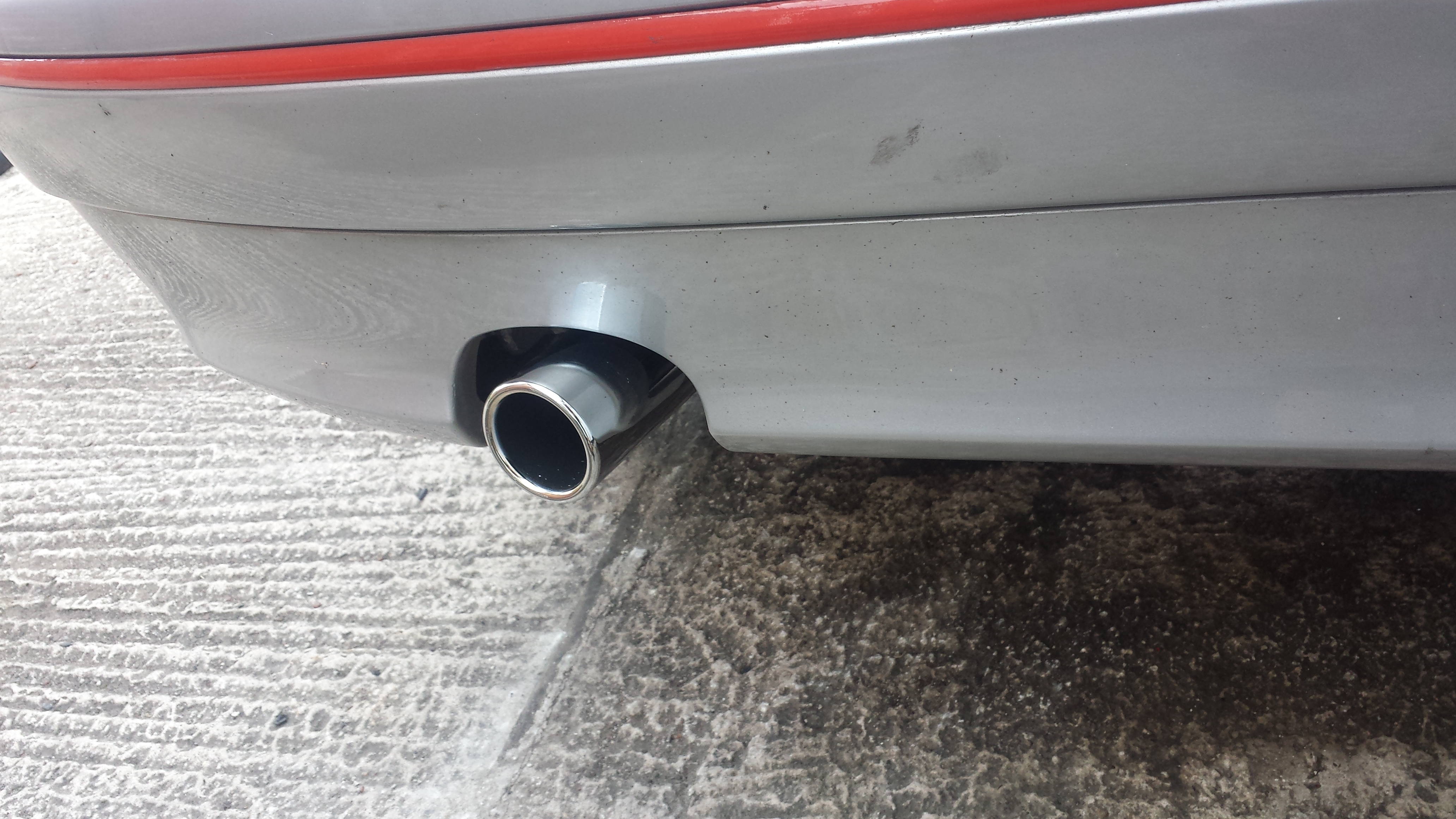

Silencer came today, fitted it straight away amazed in the sound difference almost silent now happy on the exhaust noise and nice and free flowing to. Also fitted a chrome tip to make it look better than just cut off pipe.

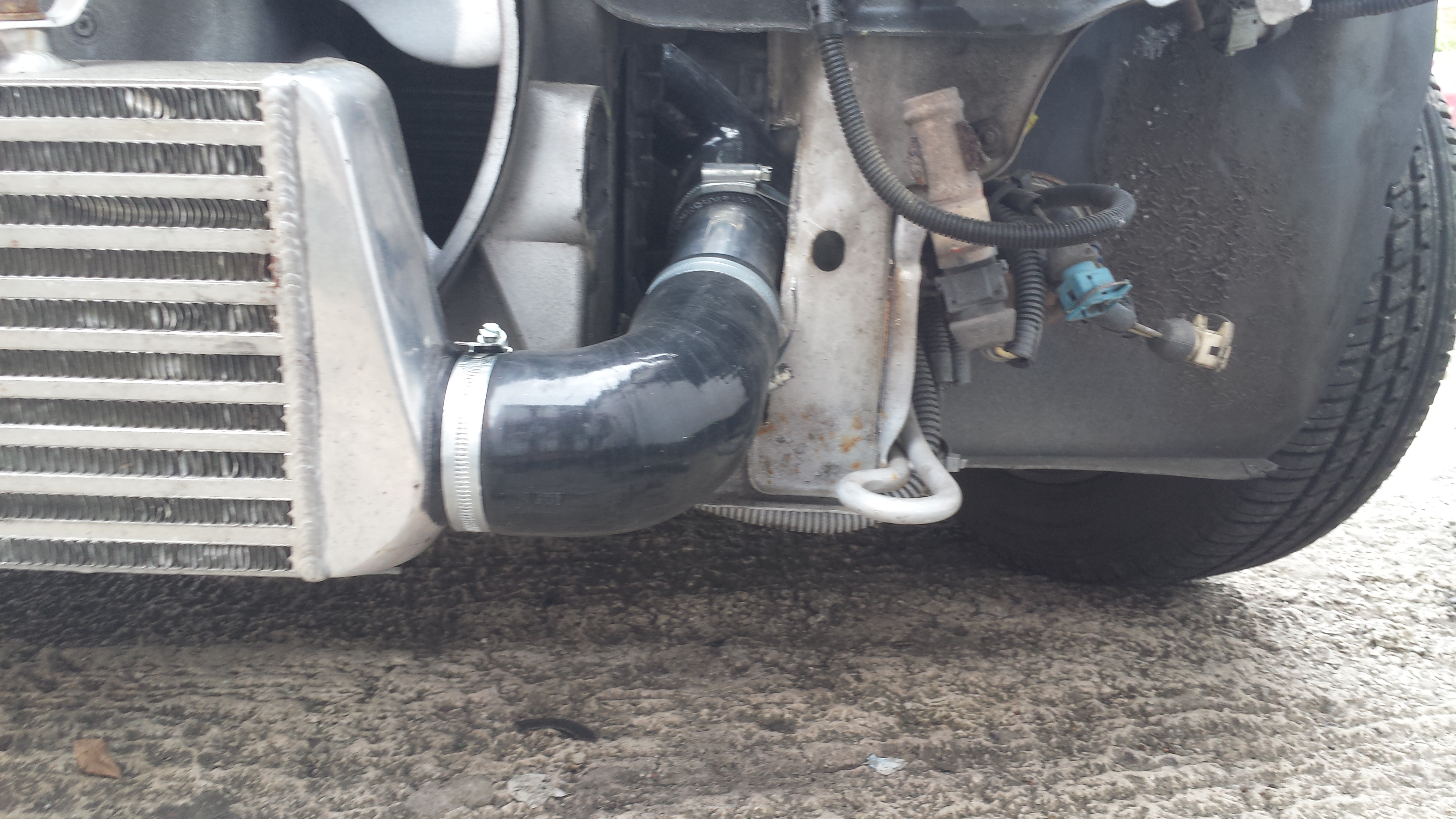

Started to plumb fmic in and fitted xantia inlet.

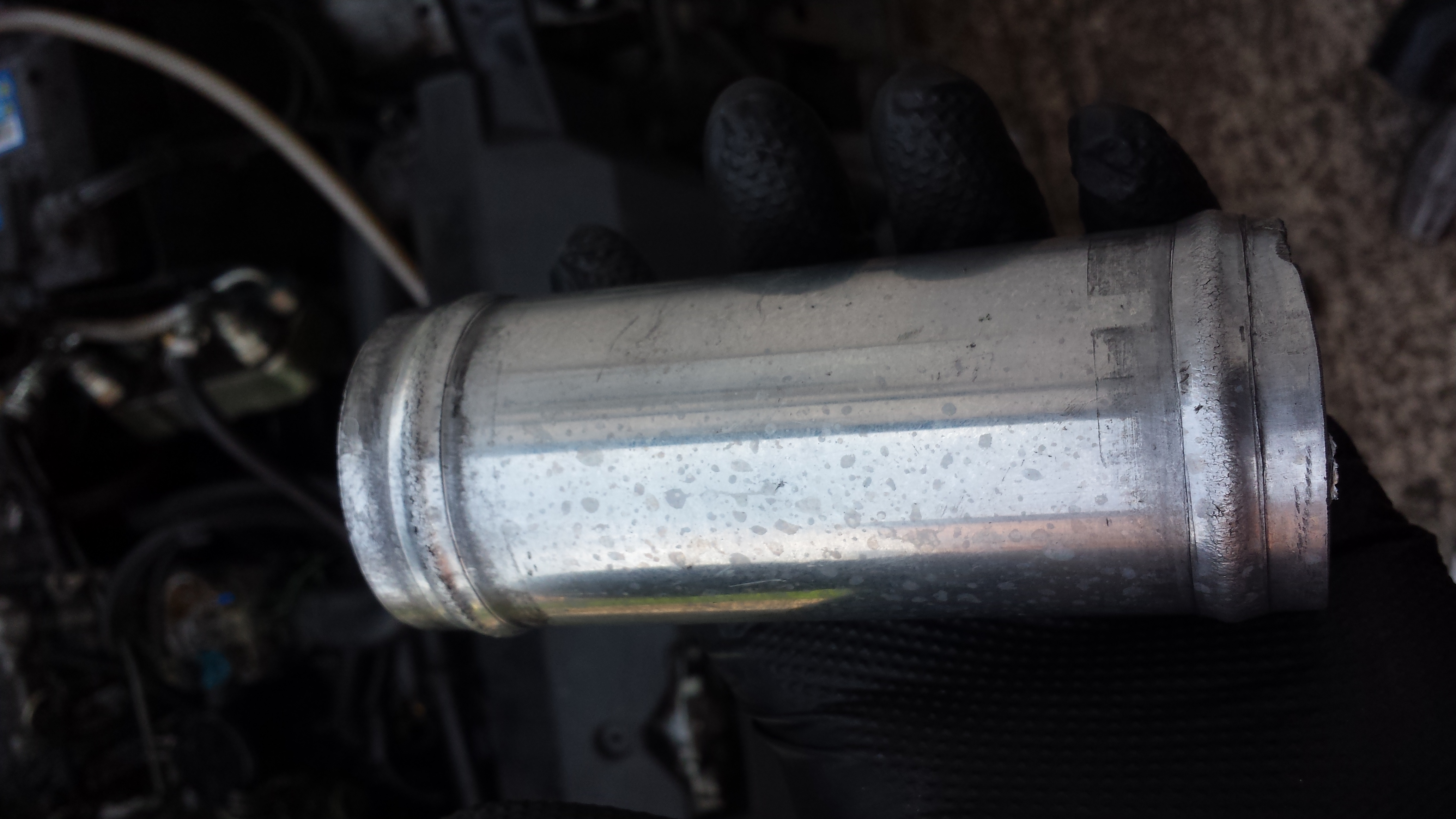

Beaded my own pipes..... took some doing to say the least!
Then the next day after finding a load of random pipes in the shed I manged to complete the one side.
So thats were I'm at now waiting on more pipe work to come for the other side.
