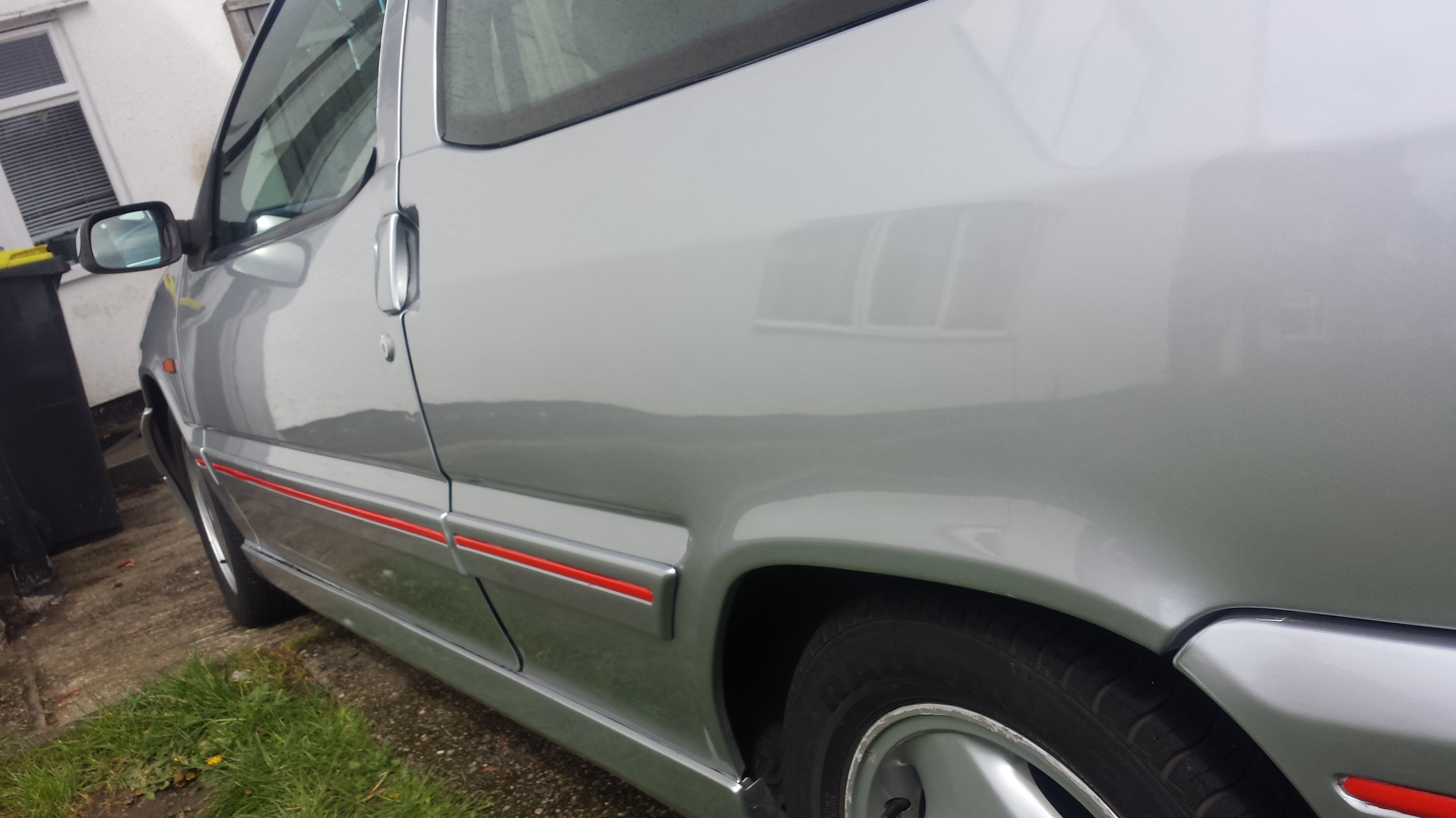

Paint chip on rear quater  (about size of my finger nail)

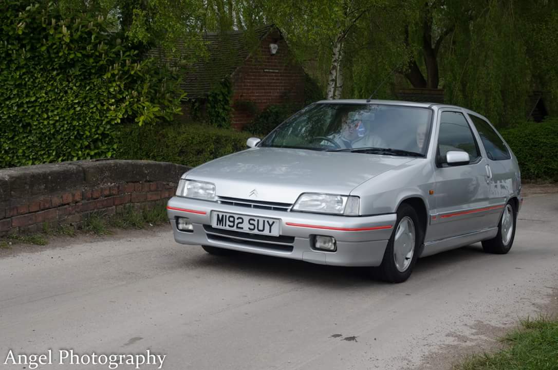

Here's how the car looks now it's home.

Not sure how that was a write off. It looks great! Big Grin Do you know how it was meant to be damaged?
I don't, I had a quick flick though the history and can't find any thing in there about it, it did have a near full respray list year tho.

(28-02-2017, 09:07 AM)zx_volcane Wrote: looks very tidy
It is very tidy apart from the chip in rear quater and crack in front bumper it's pretty much spotless. But I suspect that's because of the near full respray it's had.

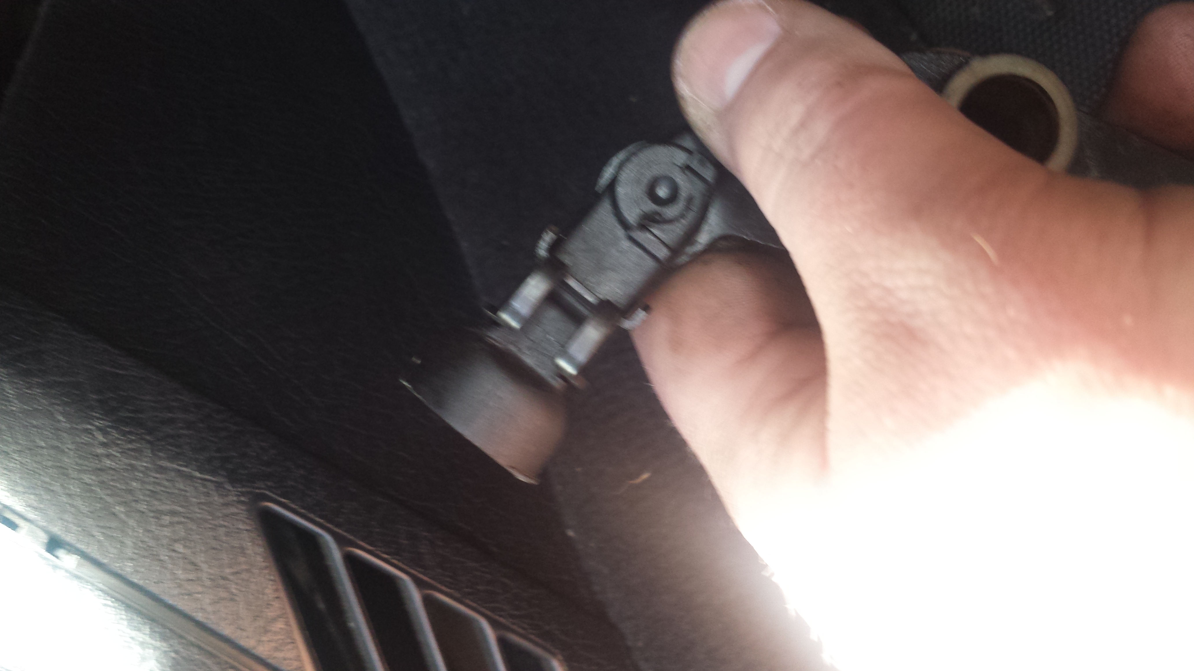

So couple of days ago I tought the clutch cable had snapped peddal had gone right to the floor, was just about to get a new cable when I thought I'd check to make sure I'm getting the right one, when I got under the dashboard I found out that it had unclipped it's self, looks a propa rubbish design tbh.
The tiny metal clip holds the cable in place, so my mate manged to get it clipped back in and it's good again, but can't help thinking that it's gonna pull out again as there's not much metal there holding it in place with a fair amount of force to move it.

(27-03-2017, 04:27 PM)welshpug Wrote: now wrong with that design of pedal as long as the fitter knows how to do it, check the two tabs are not bent.
Well I bent the clip before refitting it made sure it was a tight fit to make sure it doesn't come off again...... hopefully.
