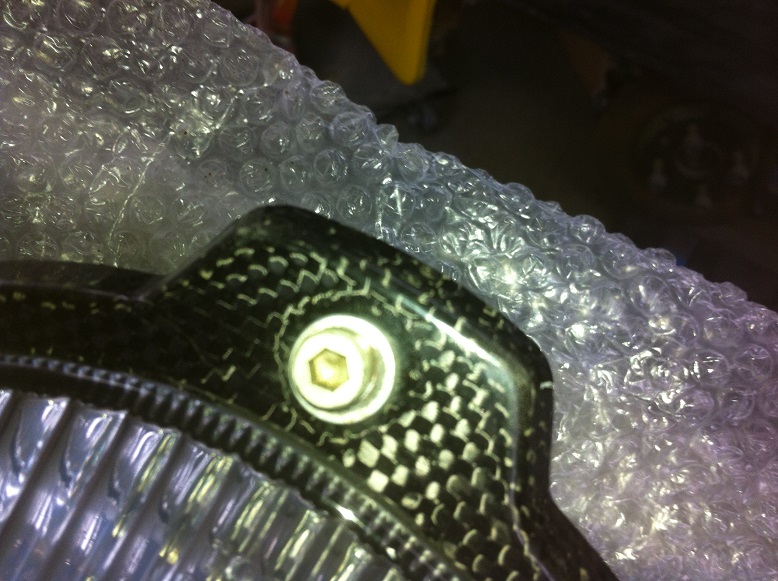

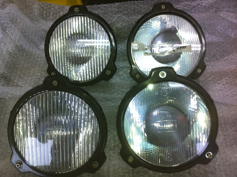

got delivered some brand new wrc gas discharge lamp pod lamps aswell , with carbon fibre mounting rings , as will be needed for when start rallying again
Loving the lamps! what pod have you got to mount them in?

(20-03-2017, 12:01 PM)Matt-Rallye Wrote: Loving the lamps! what pod have you got to mount them in?

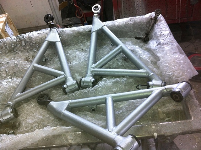

i am getting  a proper maxi lamp pod matt ,  also these are the rosejointed maxi width tubular wishbones for the car , they are a good 40mm wider than my other pts tubular ones and 10mm more castors,

40mm wider either side or overall? that should improve the front end! Big Grin

(27-03-2017, 07:23 AM)Matt-Rallye Wrote: 40mm wider either side or overall? that should improve the front end! Big Grin
Matt the new wish bones are 40mm wider either side compared to the pts tubular ones I had on the car , with adjustment in outer rose joints , so can go wider for more camber , there was photos of the pts one on my thread , but not sure if they were messed up when had problem with forum photo downloads so will post photos of others later

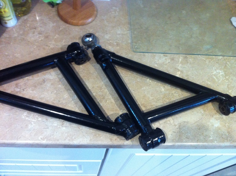

standard width pts tubular wishbones photos ,
This is a stupid dumb question from me but what makes these better than the original shape wishbones? How much better and why? Smile
(27-03-2017, 10:18 PM)MY95 Wrote: This is a stupid dumb question from me but what makes these better than the original shape wishbones?  How much better and why? Smile
not a dumb question , the black ones in above photo are peugeot talbot sport grpA ones wich are a adjustable rosejointed outer , so can run more camber , they are tubular as a lot stronger and also use alot harder inner bushes to cope with rigours of rallying , the silver ones higher up page are maxi width ones , again adjustable outer rosejointed , and tubular for strenght , with harder inner bushes , but are 40mm wider either side and run 10mm more castor than pts ones , so wheel sits centre of maxi arch , hope this answers your question mate

(27-03-2017, 10:37 PM)twangy Wrote: the silver ones higher up page are maxi width ones , again adjustable outer rosejointed , and tubular for strenght , with harder inner bushes , but are 40mm wider either side and run 10mm more castor than pts ones , so wheel sits centre of maxi arch.
