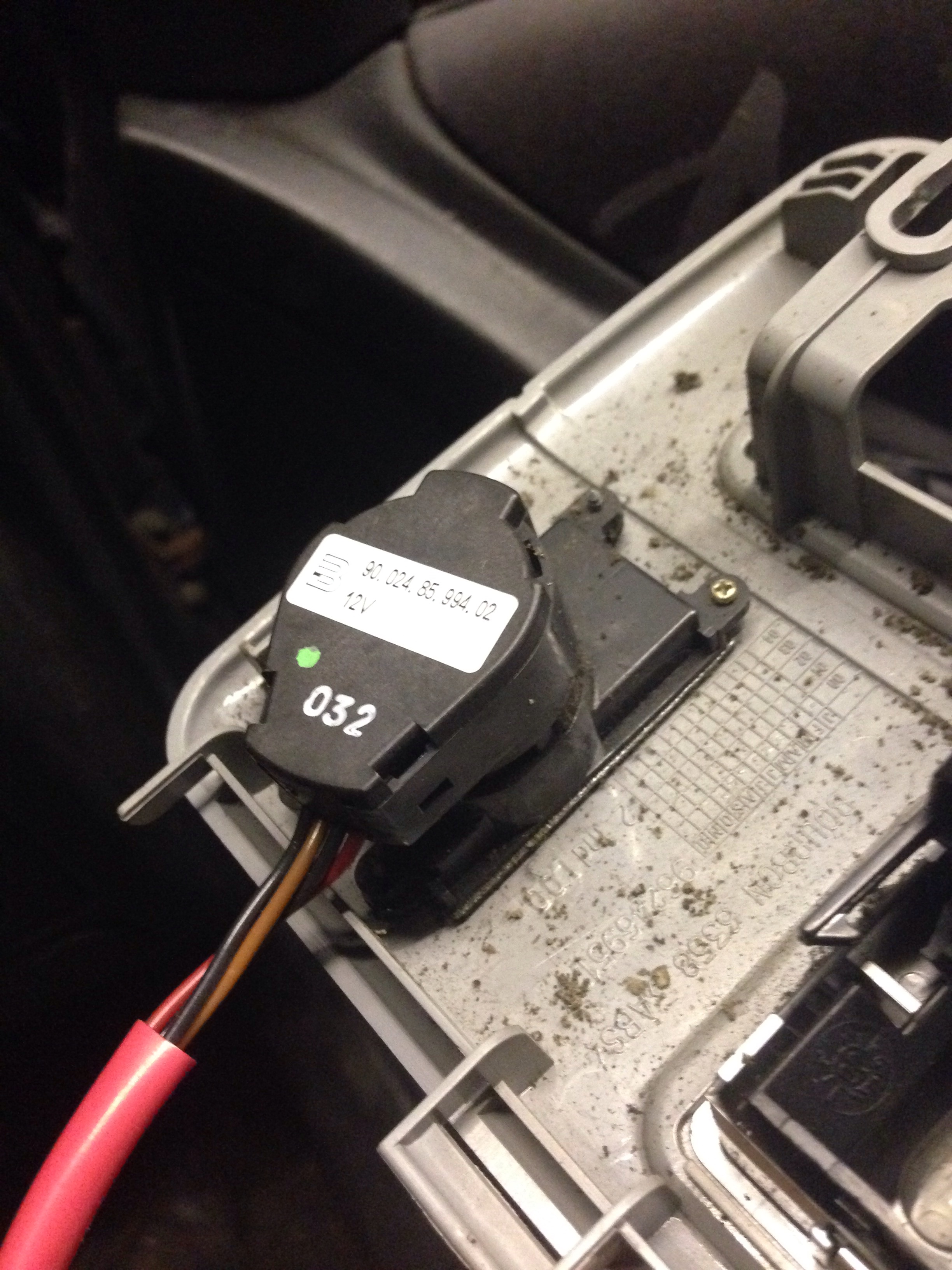

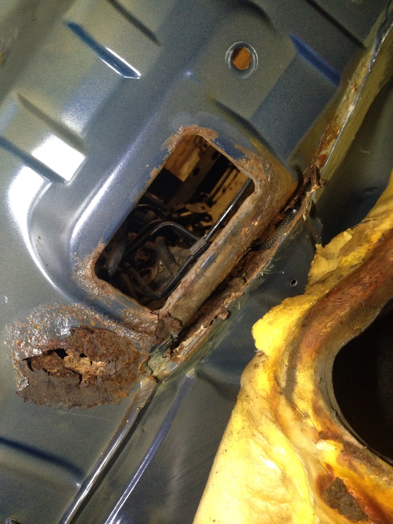

So a few things today. Pulled out some god awful alarm that was in the dash [Image: d157c8049bbc1528edfa36ddf2308ff5.jpg]

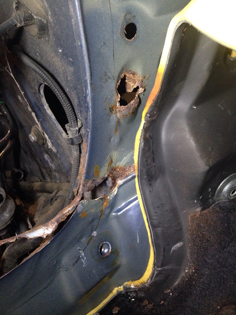

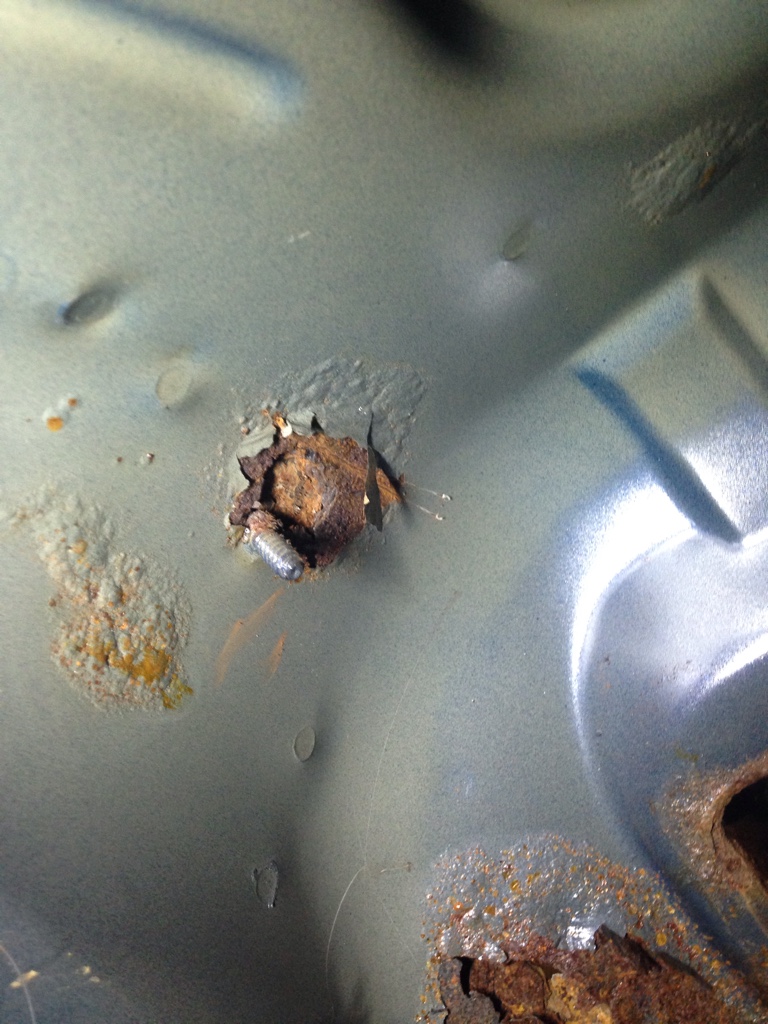

Then i started to inspect the rusty bulkhead
This is rusty. Now i havnt givein the rear arch a look yet but its solid round the carpet.
What do you guys think.
#39
Looks like a pain in the balls tbh. You've come this far. I'm sure you can just weld it up. No worries if it's going to become a track slag in the future anyway!
#40
(20-09-2016, 08:33 PM)Eeyore Wrote: Looks like a pain in the balls tbh. You've come this far. I'm sure you can just weld it up. No worries if it's going to become a track slag in the future anyway!
not the point. ill weld it up no doubt but even if its going to be a "track slag" id still like to do it properly and well like everything i do. The only issue i can forsee if the plate that holds the servo on is sealed onto where the rust is and if i get that wrong my car will leak water. which i dont want

Mate, that's scrap.

would love the 205 but i cant really use it to ferry my boy round in. this is fixable still. its just a pain. plus i have a lot of 306 bits and no 205 bits. if a shell comes up local i may jump on it but if not this is geetting fixed.

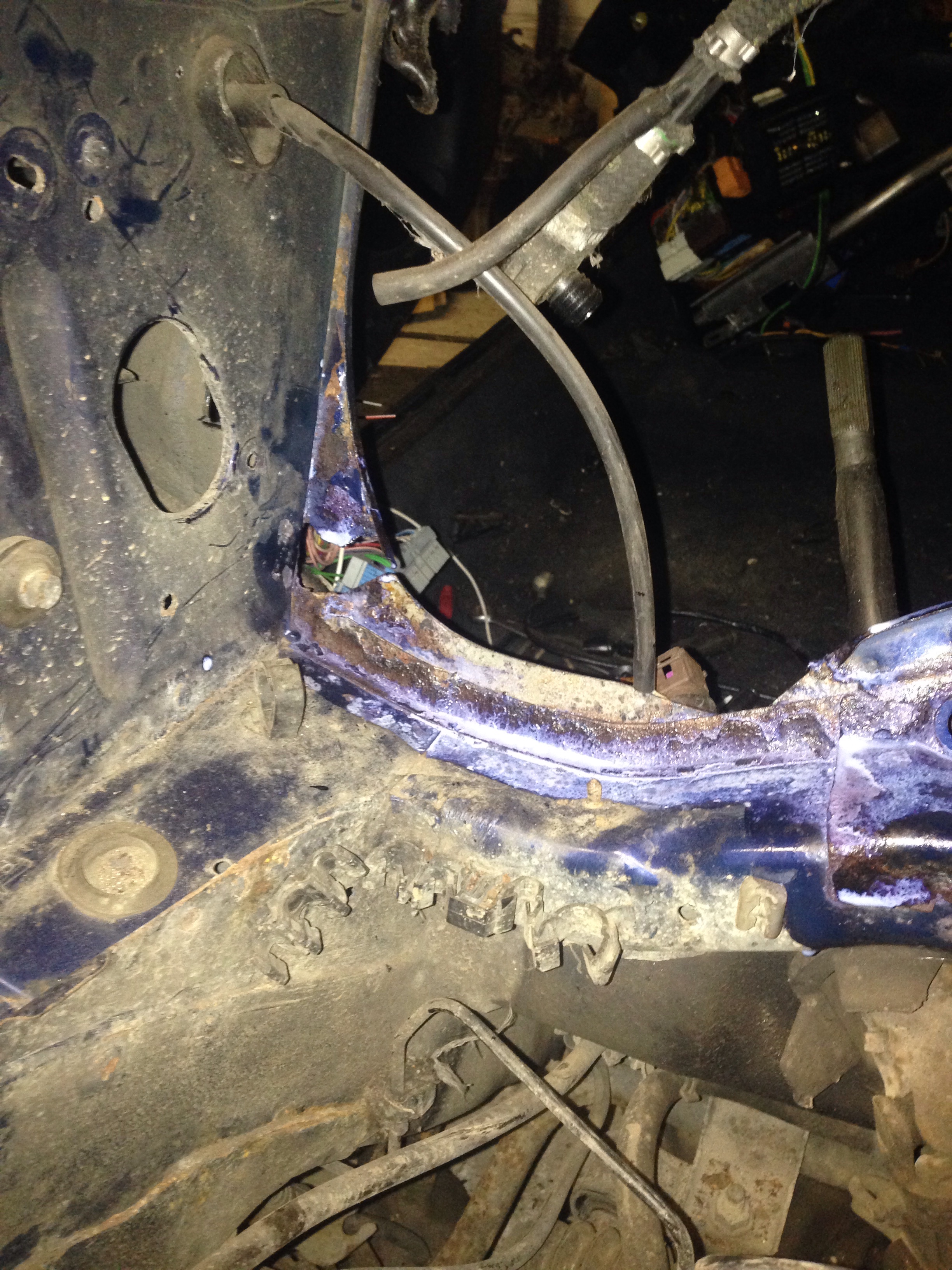

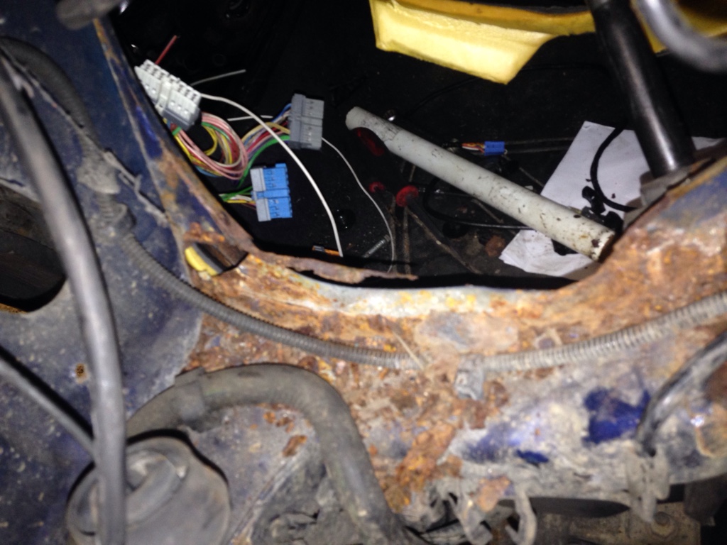

So before i made any rash decisions and scrapped the shell i cleaned off the worst of the rust tonight with various power tools, brushs and screwdrivers. Most of it looks a lot worse than it is. Hit all of it with a hammer and chisel to check. 99% is surface rust. Think a good clean down some sealing and a repaint. Plus the three patchs ive got to put in to the bits that are actually rusty. She seems ok. Anyone know how to treat surface rust once scrapped off? Bit of kurust and repaint??
On a side note as this is taling a little longer than expected i do have a gt2056s laying about and i am wondering if it will actually fit down the back of this!!
Figure would make gti6 sorta bhp plus a few torques with it on. Make a nice little daily for a while untill i go mad later on
#47
I just wire brush it back to largely bare metal and then hammerite it or if your really concerned hammerite rust killer and then top coat.
#48
Well that's an awkward spot for rust... Meh, weld a patch in and spend a while tweaking it, you'll get it close enough to seal properly, especially with a bit of silicone added around the problem area.

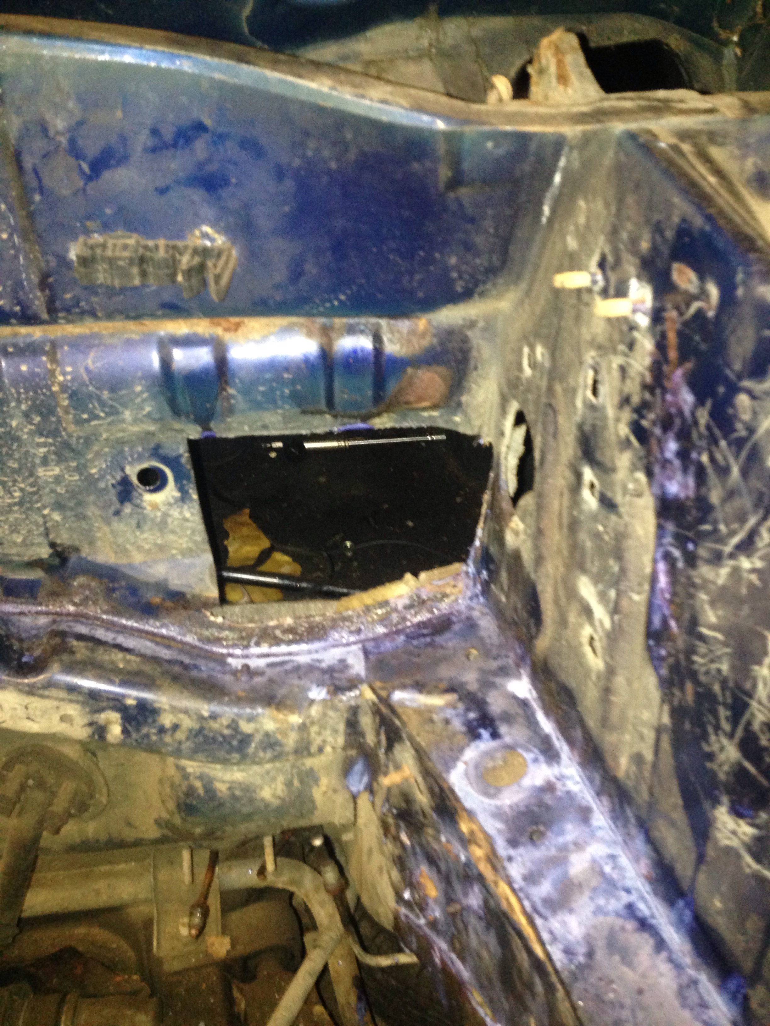

So ive not had a good week this week. Had to take a day off work ill and my cat has gone missing since tuesday so conecerted efforts have been into trying to find him. However tonight it got dark and i had nothing to do. So i cut the rust out of the problem areas and cleaned the remainding sirface rust from the bay untill i was happy and coated with kurust rust neutraliser. Seems to be doing the job.

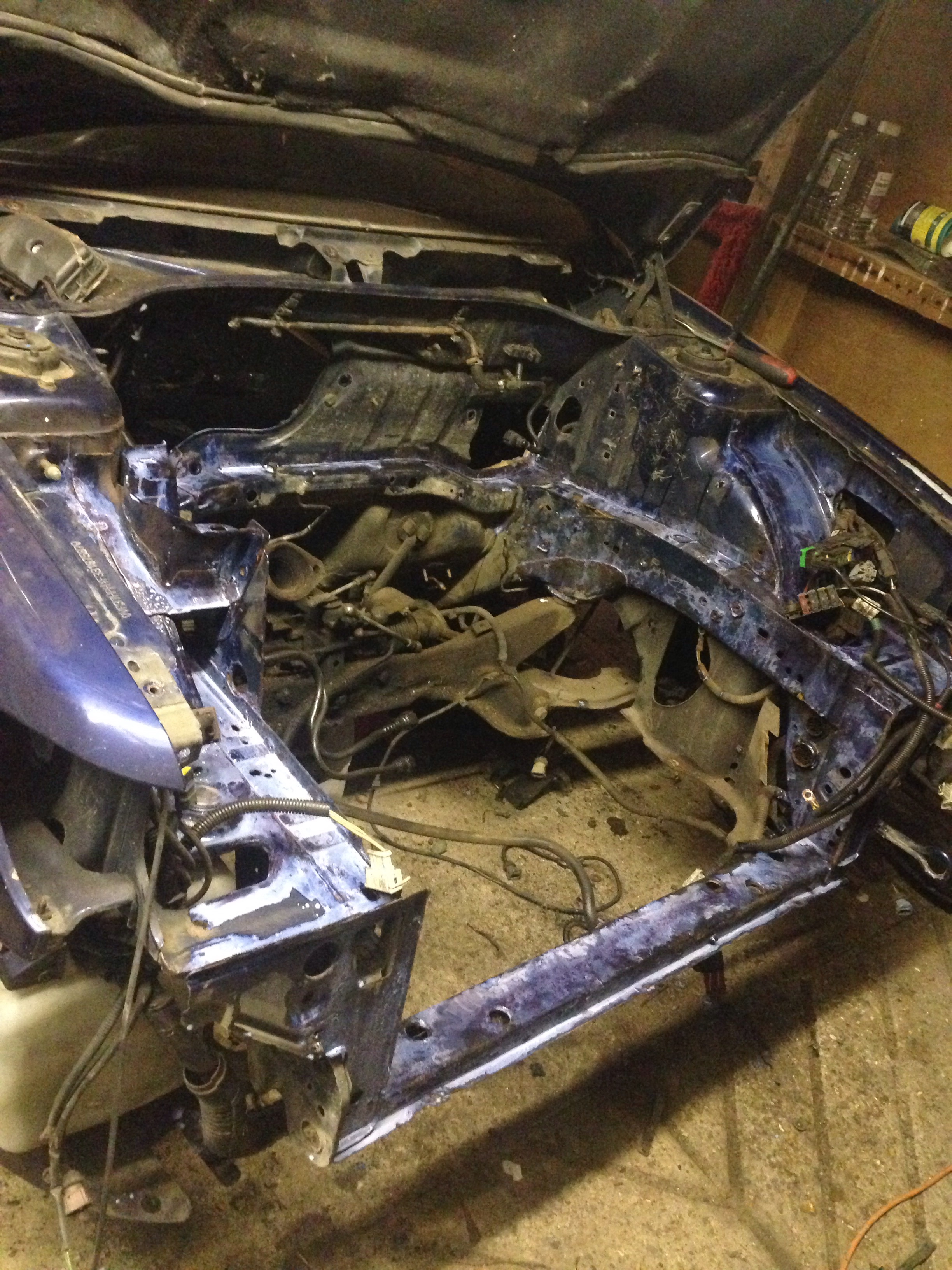

So since the last update i stripped this down further to have a look and boy was she rusty. Boot floor, round the tank, sills it got bad, real bad. But thank fully i waved my magic wand and it grew two extra doors and fixed itself. I was astounded

Few last bits to strip off tomorrow before she goes. Got the axle done tonight which wasnt to bad but had some issues like no locking wheel key. Got a nice list with this one being £250 however most is off the 3 door hence the purchase. Still got to swap ecus and bsi just so i can keep a "stage 1" map. Front brake hoses. Top mount, tyres, clutch and heater matrix.
