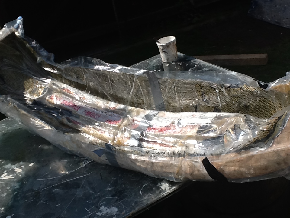

Front bumper made of carbon / Kevlar and vacuumed bagged,, so will remove over weekend and show photos

 Matt it's a dimma carbon Kevlar front bumper mate , will start fitting some of body kit over weekend , so will post pictures as go along, only got to make rear bumper now , so nearly there with making kit  , photo of rear quarter inner

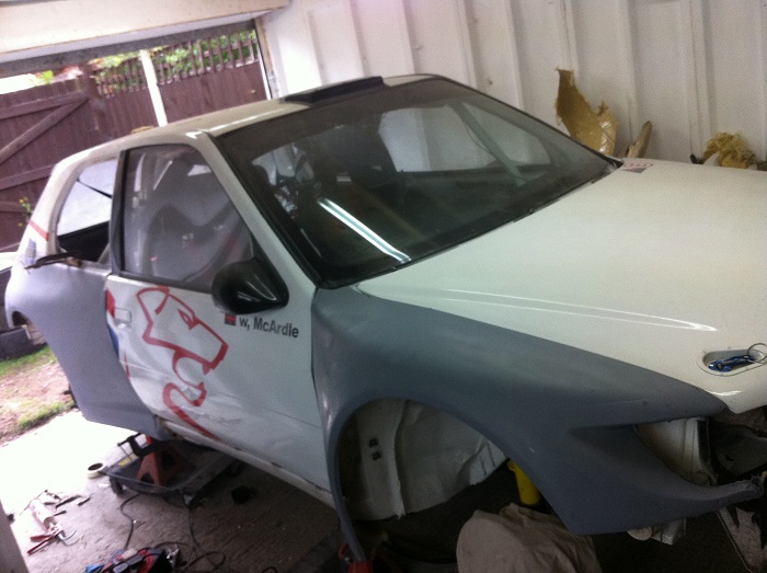

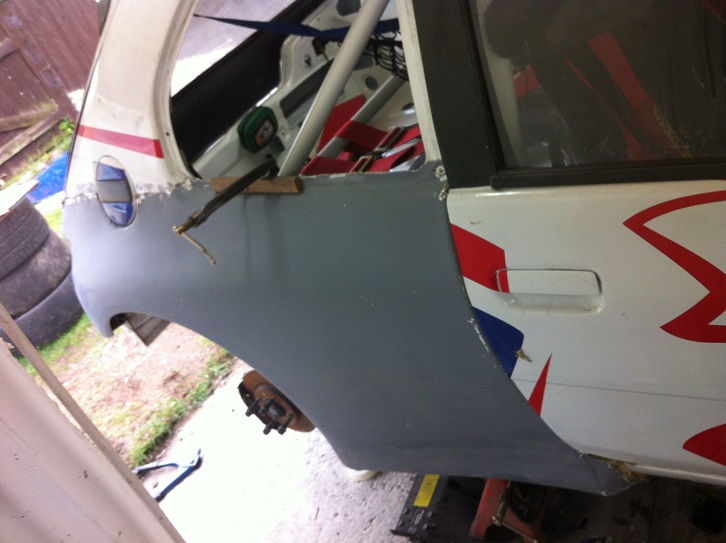

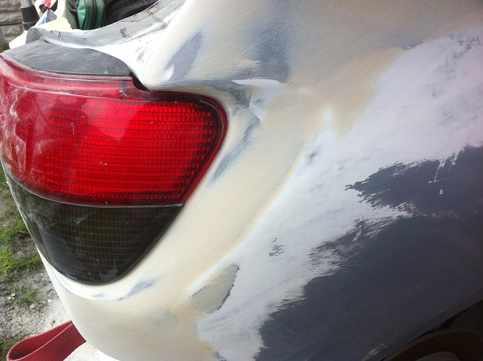

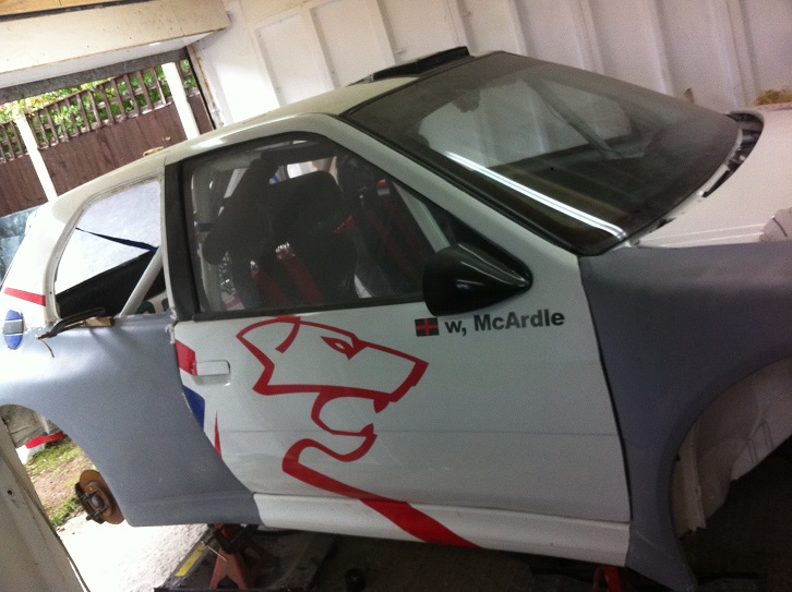

cheers damien , managed to make start on fitting kit today , so heres a few photos to view
front bumper ready for trimming , will also try and fit other rear quarter and front wing  today

had good full day on car this saturday , had mate round who works in body shop , so he started on body work and fitting front wing and bumper , so starting to get there , also picked up engine after rebuild ,  just need to get and fit a 4.9 cwp and can be put back in car , hopefully will get a bit more done this week by doing the odd hour afterwork

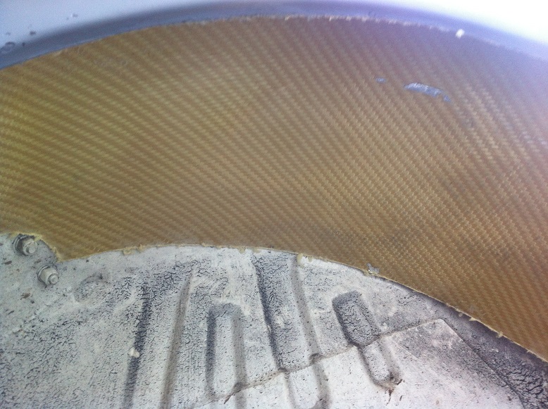

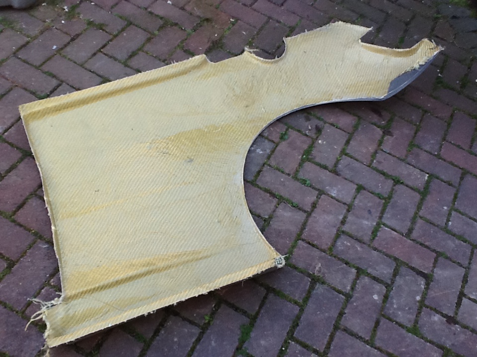

started making kevlar arch liners this week  , used hardboard covered in tinfoil to get profile as shown in photos . both fronts and passenger sid rear made, this weekend me and bodyshop mate will try and get load more done on fitting body kit so will update as go along

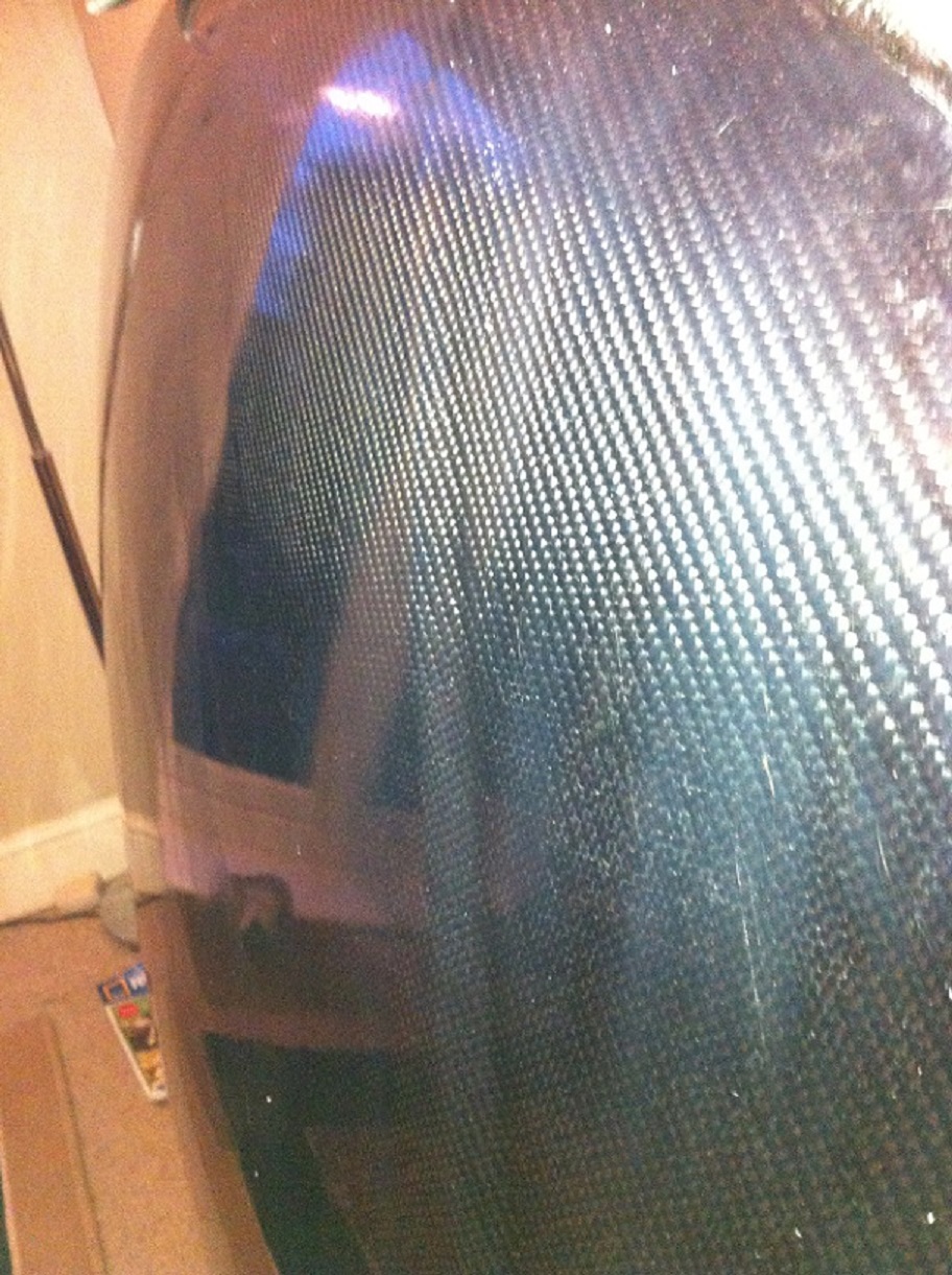

                                             [Image: 2ljm03k.jpg]

cheers danny , better picture of front arch

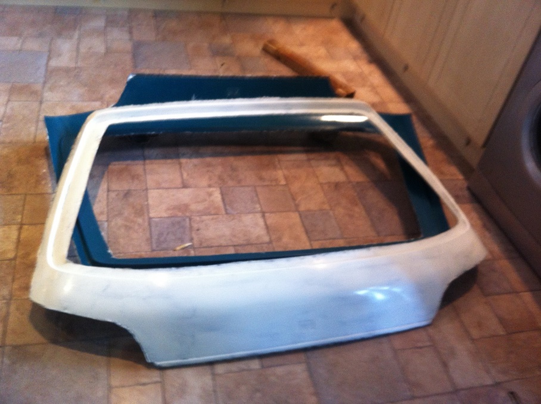

The bonnet and hatch and also both doors are already made of carbon fibre ,as shown earlier in thread only roof is still steel , have mould for making roof but sticking with steel mate

allways looking for new stuff to make the car lighter , have allready made carbon front panel and rear spoiler aswell , so got to make carbon /kevlar rear bumper and have a look at carbon rear diffuser and a few other bits that im thinking of making , then will take good look at car and see what else , few photos of the carbon bonnet /hatch and doors when i was making mate

(02-09-2016, 08:12 PM)twangy Wrote: started making kevlar arch liners this week  , used hardboard covered in tinfoil to get profile as shown in photos . both fronts and passenger sid rear made, this weekend me and bodyshop mate will try and get load more done on fitting body kit so will update as go along
how well does tinfoil work with molds & releasing? (i fancy knocking up some arch liners using oe ones as a basis)
With the original plastic one , would just release wax them , then use a load of hairspray on them as gives a release film , gel coat with minimum catalyst so goes of slowly and doesnt create to much heat then glass them using minimum catalyst again mate
