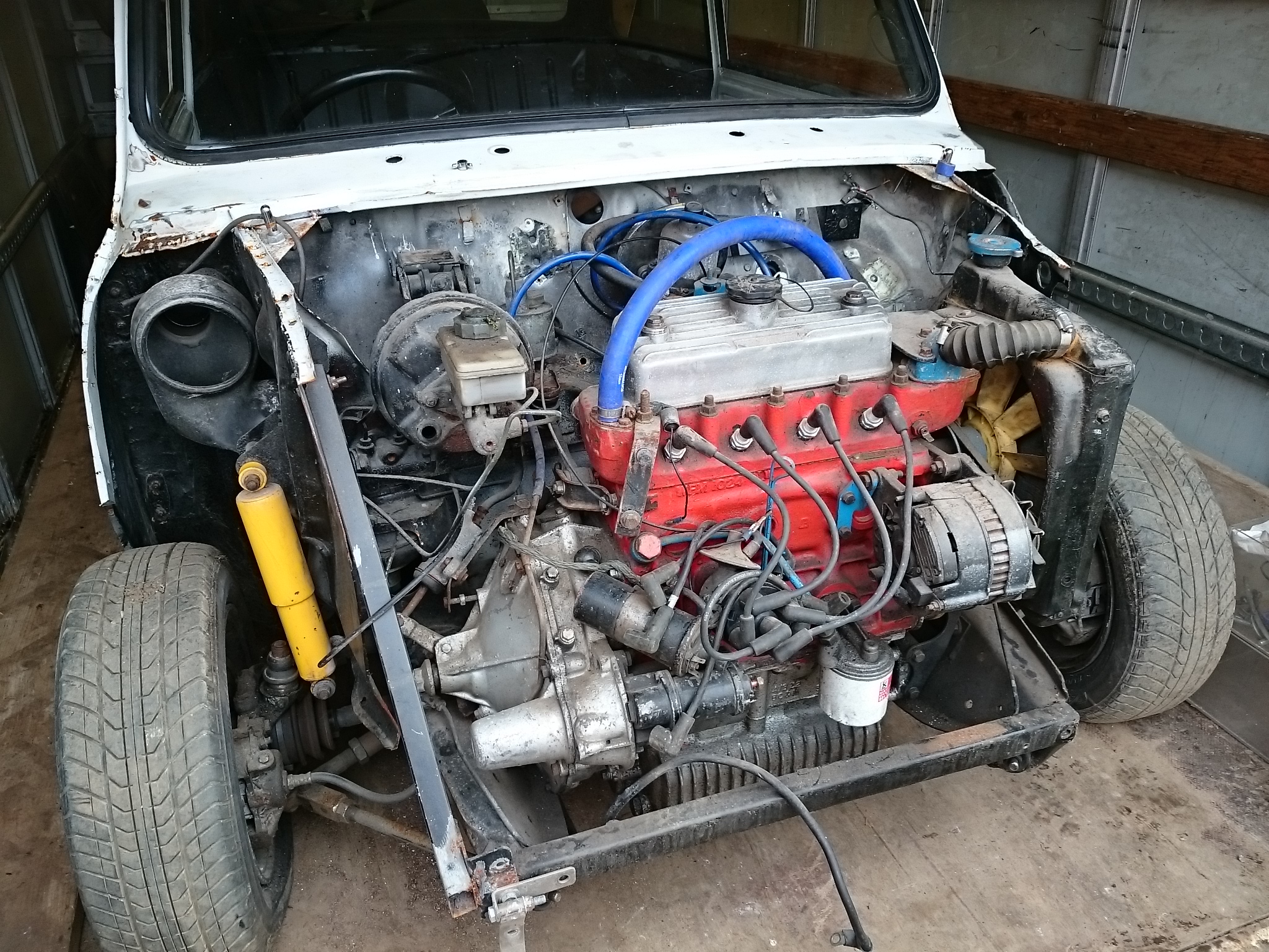

Actually do something to this tomorrow...I took some boxes down and labels today and bits to make a big shelf to help with storage.
Tomorrow its strip and asses time.
Already know of a few main areas that need a pro to do.
New sills badly welded on..may cut them off and start again.
A panels over filled...for the cost...may get new
N/s boot floor...bad repair...needs cutting out and redoing...same with n/s/r aarch.
And a weird bit on the sill lip o/s/r. I'll get pics tomorrow

Seems the more I dig...the more bodges I find...could bodge a bodge...but want to do this right...so it will come into workshop when mickys escort goes for paint...get a proper assement...then do each large job properly.
Interior all out...and engine loom all gone.
So so many little parts missing though....like air ducting and wiring bits...Can see that being a right pita later on.
Front brace bars are welded worse than even my worst efforts which...again...annoying.
Next is remove engine/box.
Then get wire wheels out
#41

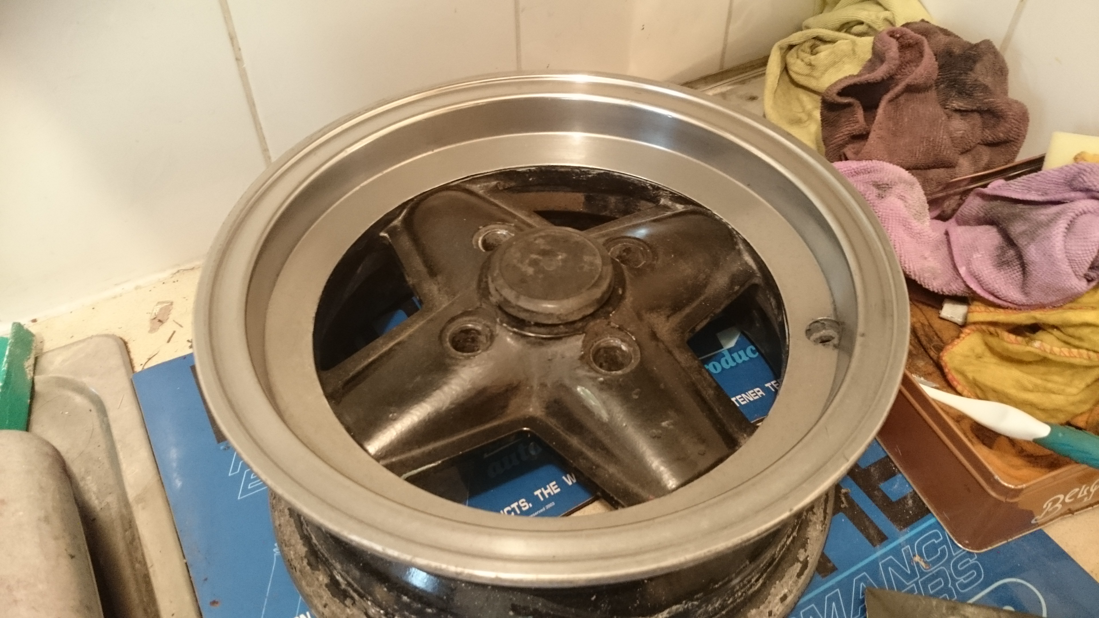

So.
Stripped it a bit more.
Got a buyer for the Aseries.
Got wheels off and stripped the tyres.
Time to get polishing...
They are a couple of dings and scuff marks...but alloy restoration places want MAD money for repair. So I will get at them with wet n dry n autoglym...
Open to suggestions to get a proper shine, how to protect the shine and how to mask it off to paint! lol
Also booked in at Mickys...once his mk2 rallye escort goes to paintshop...the mini rolls in for Pavo to cut rust and weld metal ThumbsUp
#45
Any pro's for polishing those rims and then sealing them to help keep the shine??
#46
Lots of work with sand paper and a decent compound/cutting pad?
Never done it personally so couldn't really say from experience but would guess at 1500 / 2000 /2500 / 3000 then compound for a decent polished finish? Maybe further depending how much time you want to put to it

Dont say that!!
Took the wheels to a blasters today...wanted £35 PER wheel to blast the paint off...so they came back with me! Nitromors time
#50
Its a mini piggy, these rot everywhere!
are you not going to get them power coated and the rim polished up?
#51
(11-08-2016, 08:53 PM)procta Wrote: Its a mini piggy, these rot everywhere!
I want to paint them a particular colour. Them polish the rim meself.
