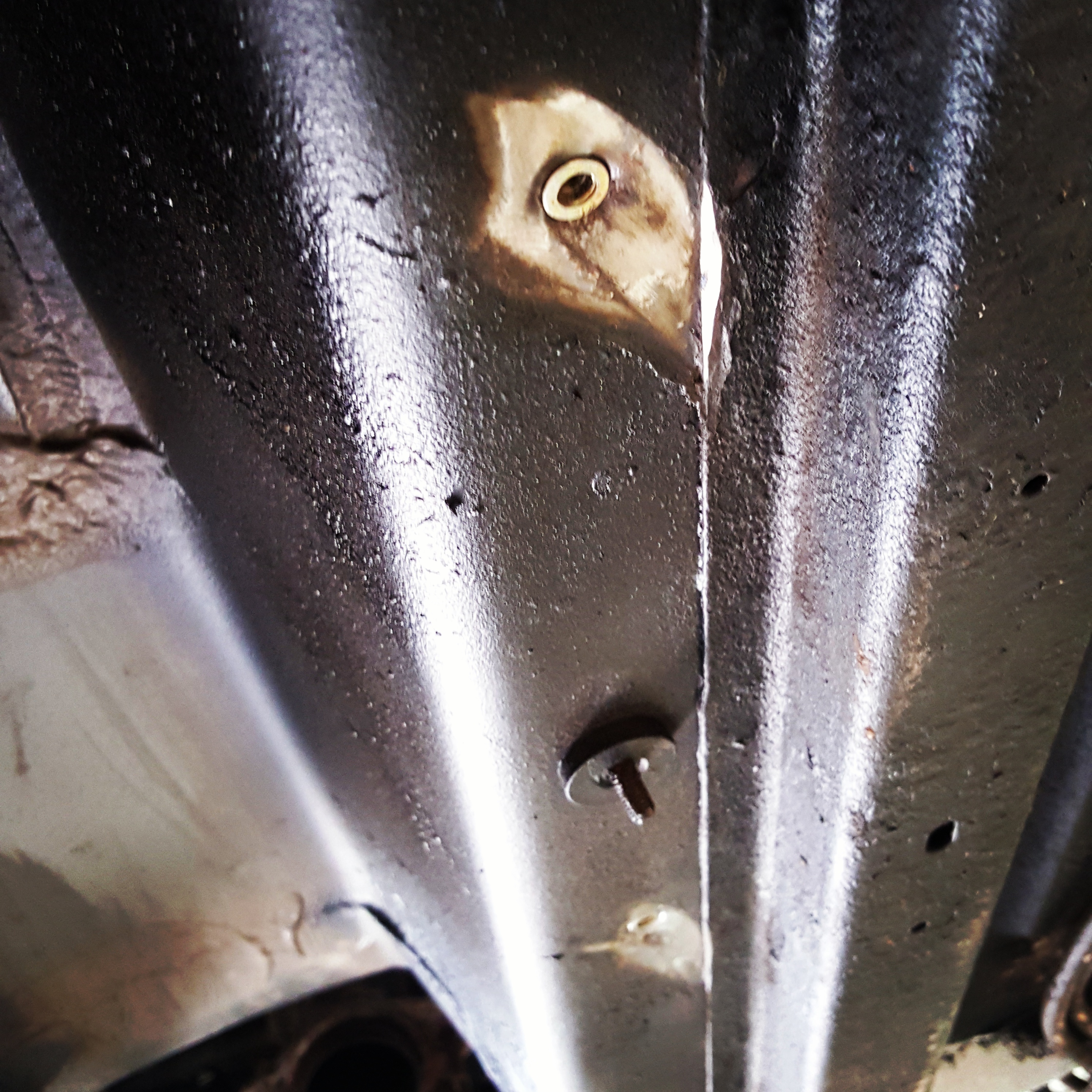

Had a big clean of the remaining underside and engine bay today, not much progress in getting it closer to being roadworthy but I'm waiting for parcels and for things to be powder coated so ideal time for cleaning the bits that never recieve attention.
First job, removed all the heatshields, primed and painted then undersealed the exhaust tunnel again as it was getting a bit scabby and while I was there, made a big improvement to the shitty little studs that always snap when you try to take the shields off. Studs drilled out, replaced with rivnuts. Way better, just attach the shields with stainless caphead bolts now.
Ideal that ThumbsUp
