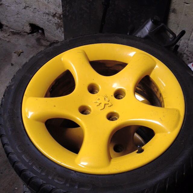

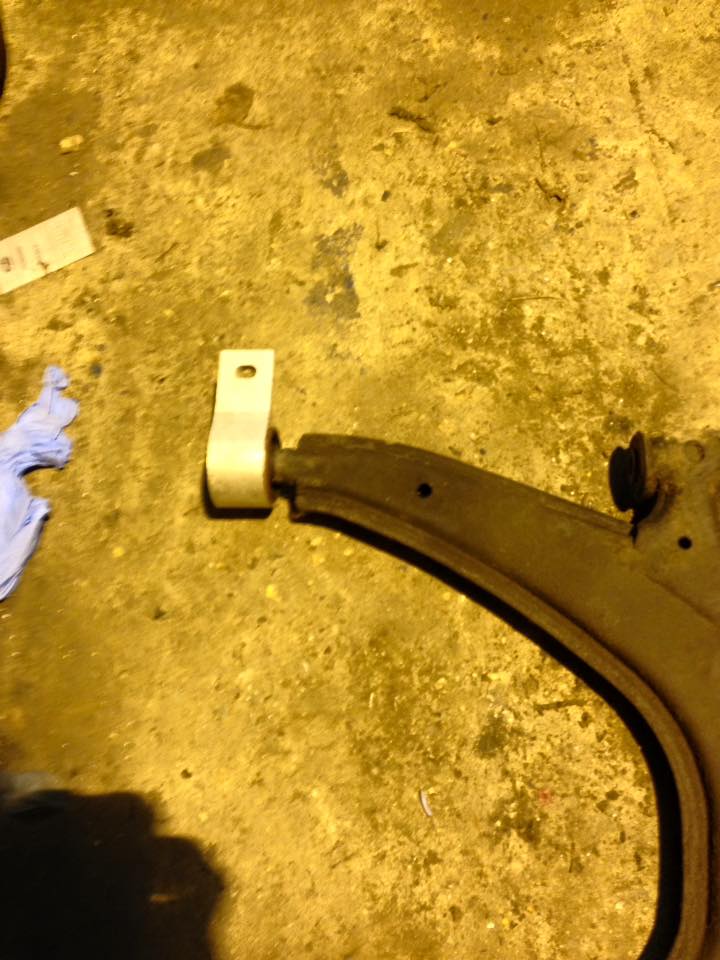

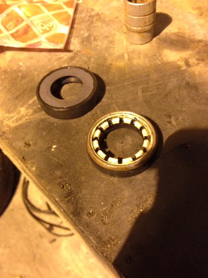

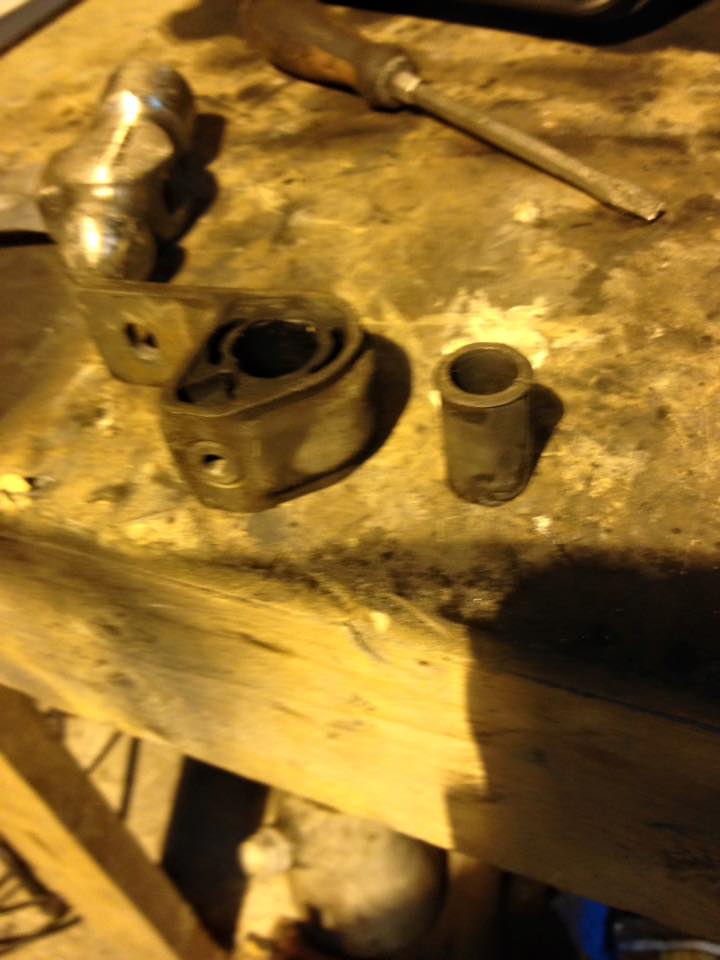

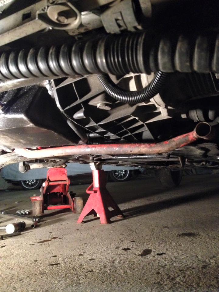

so a few things have gone on this week. ive fiddled with the pump again to get it dialled in right just didnt feel "right" to me so spent a few hours over lunch breaks getting that correct. but tonight was my workshop night so popped up there. got a driveshaft seal fitted. new p bush on one side. lower brace on to test clearance. it is currently knocking so will need some adjustment. got the passenger air bag removed and fitted one of cullys air bag resistor things. so thanks for that cully. so i now have a top glove box. thats about it at the moment. the exhaust is still blowing that needs the 2 1/2 system remaking for this one. other side p bush to do. rear calliper still to do. as always comments questions and general banter welcomed.  Also the track wheels in the photo off sams raylle
Nice yellow wheels bro

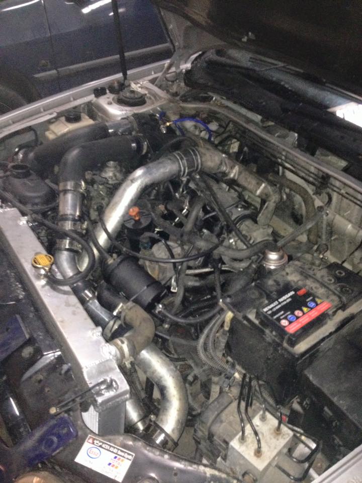

So i cant quite place my finger on it but to me it doesnt seem to be going hard enough!! the gt20 on the 9mm on the last one used to be epic. this is a fricking good turbo on this dont get me wrong but it doesnt seem like enough to me. i know the exhaust elbow i built was restrictive so im going to redesign that and stick a 2.5 inch exhaust on it as well hopefully improve the flow of it a bit. I dont think the turbo will take a bigger fuel pump though. i get a little haze on boost now. any ideas?
Needs 4 more inlet valves.......
Thought i'd accidentally strayed into one of dumdum's project threads looking at that engine bay. lol
(Disclaimer: the above is a joke and no offence is meant by it, joking with you is a sign i enjoy the social relationship i share with you and wish to develop it further. Apologies if you don't find it funny, but please don't assume that means it is a personal attack. Heart )
If you've got a restrictive downpipe elbow you will probably find fixing that helps a lot. Could quite possibly just be that the rhf5 won't perform quite as efficiently as a gt20 tbh, it's old tech.
There is a lot going on in the bay atm that needssorting need to get her going faster first. Just slap a td04 on it probably spool a bit faster right.

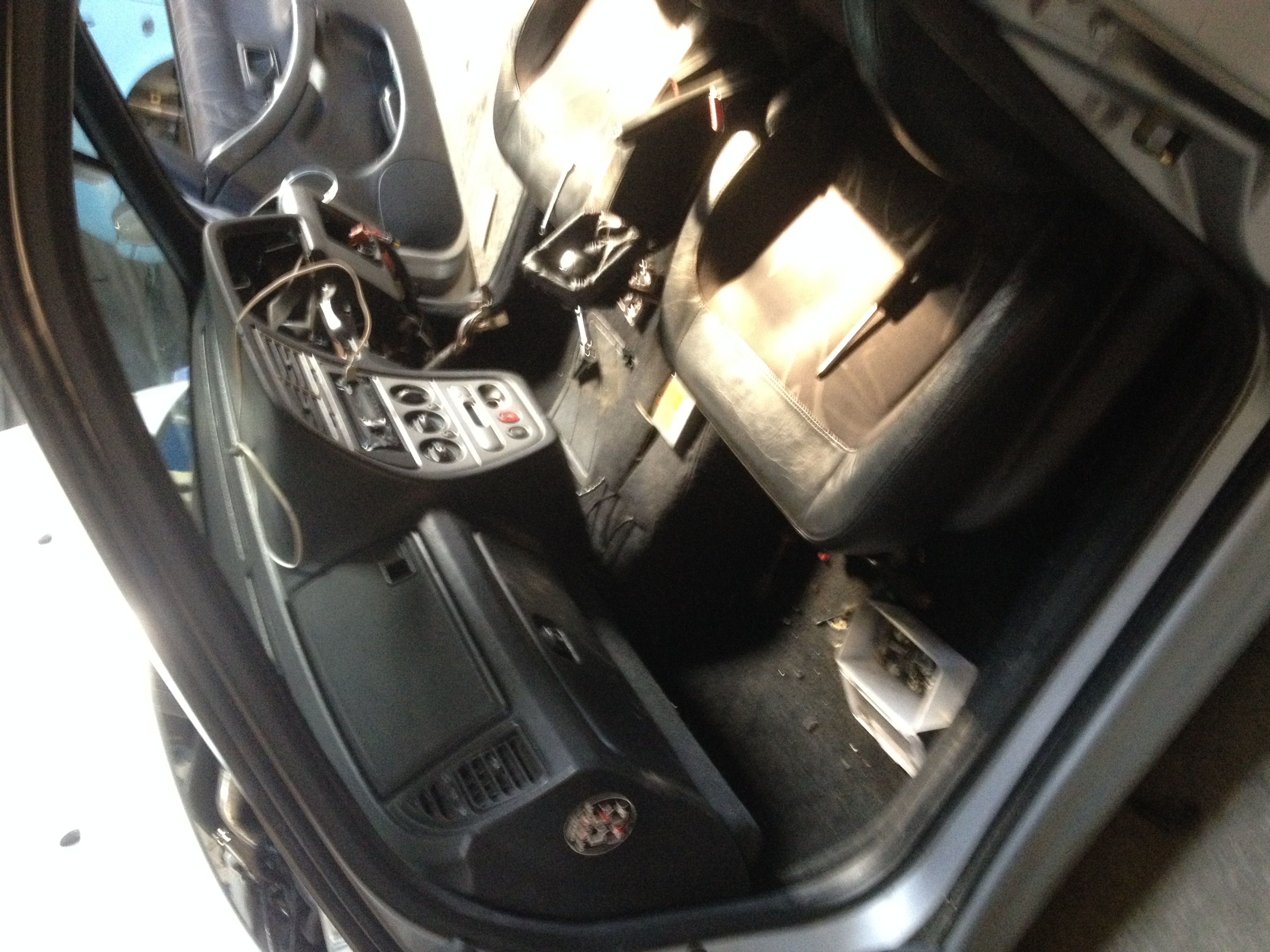

So among many other things that are stressing me out atm this thing has decided to start misting up the windscreen when the blowers are on. which in my head only means one thing. heater matrix. if this is the case. i am not impressed
So amoung the heater matrix going which sucks i am neither impressed or blown away by the rhf5 dont get me wrong its a bloody good turbo upgrade but due to my last build being epic i have come to the conclusion that there is no replacement for the gt series turbos imo. So ill be putting a new blower on come next week and maybe shifting the rhf5 onto another build or i may sell as a "kit" havnt decided yet

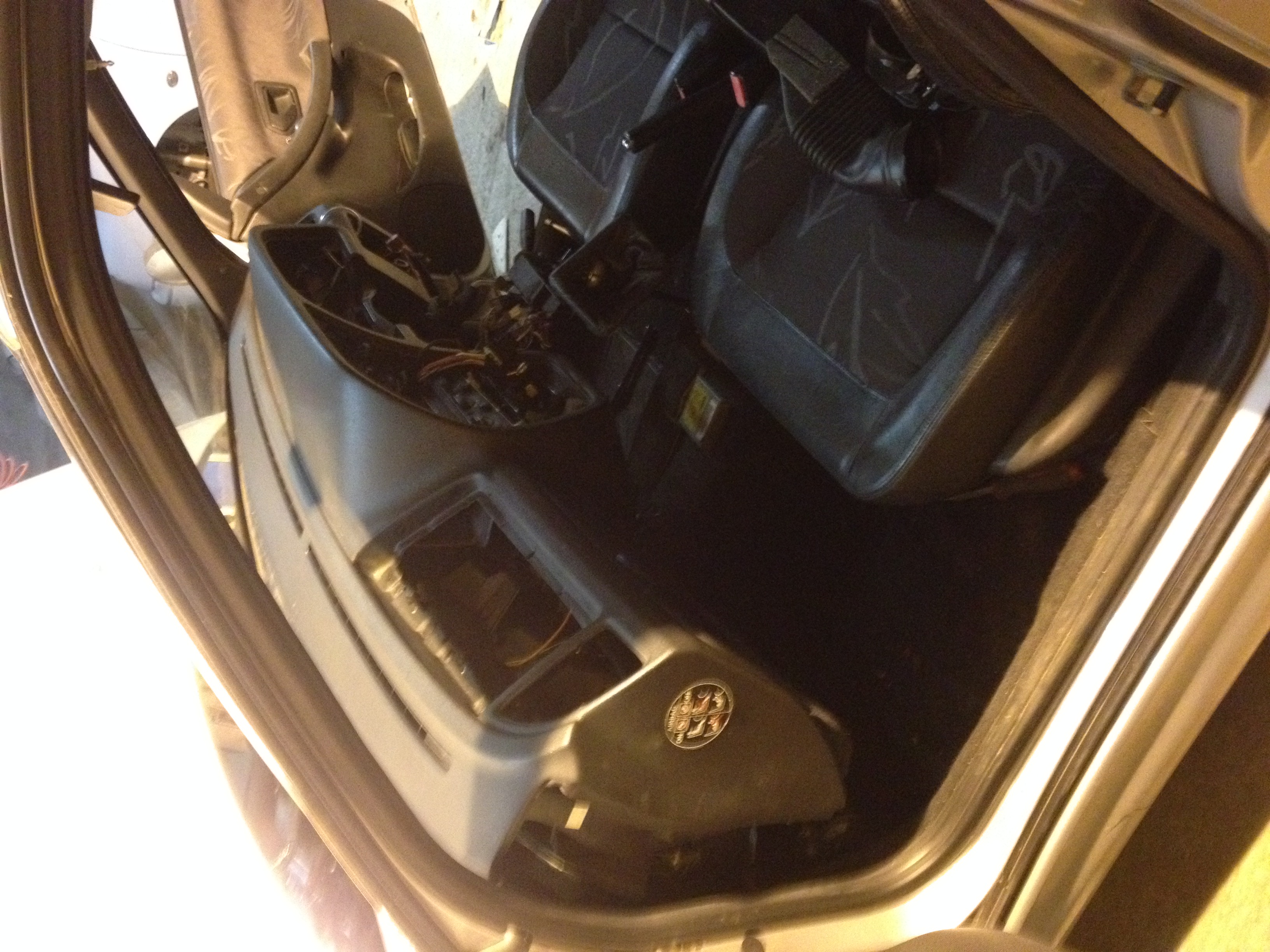

Got to the workshop this afternoon and whipped the dash to one side. removed broken heater matrix. slung in the bin. fitted new valeo unit and this is where im at.

Then proceded to rip out the engine bay to mount the new turbo. had to turbo in bits so i could clock it to get it where i want it to be mounted and got a spare actuator that will fit. also made some stencils of the turbo flange and the k14 flange to make into metal at work this week so i can then make a relocation pipe. hopefully wont have to buy anything else except a diffrent banjo bolt to fit the gt2056s.
