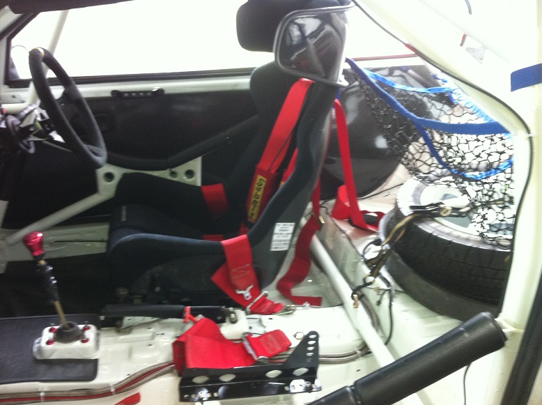

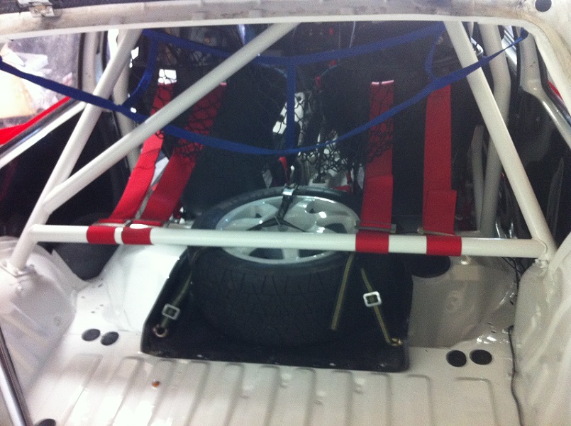

managed to do a few hours today as finished work due to rain stopping play , so started fitting car interior  , manage to get  fuel  lines back in , wiring to rear  and a load more bits in  as shown in photos

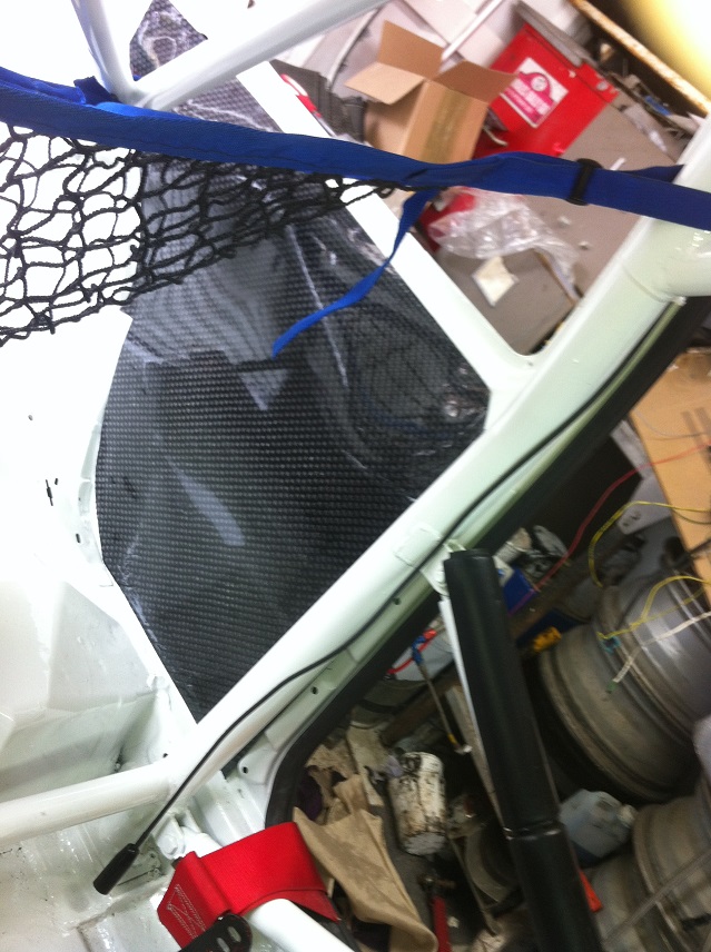

not had alot of time to do much on car this week as been mad busy , but managed to make new carbon  drivers side floor plate  and fitted battery , also managed to fit plumbed in extinguisher and co drivers footrest

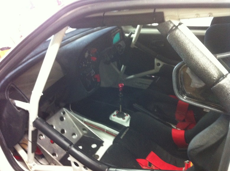

also received  pectel dash for car with loom and all sensors  , will try and fit dash this weekend , but will have to wate till engine rebuilt before fitting all sensors , ,also got quite a few of new bits bourht for car wich will add pictures as go along with rebuild

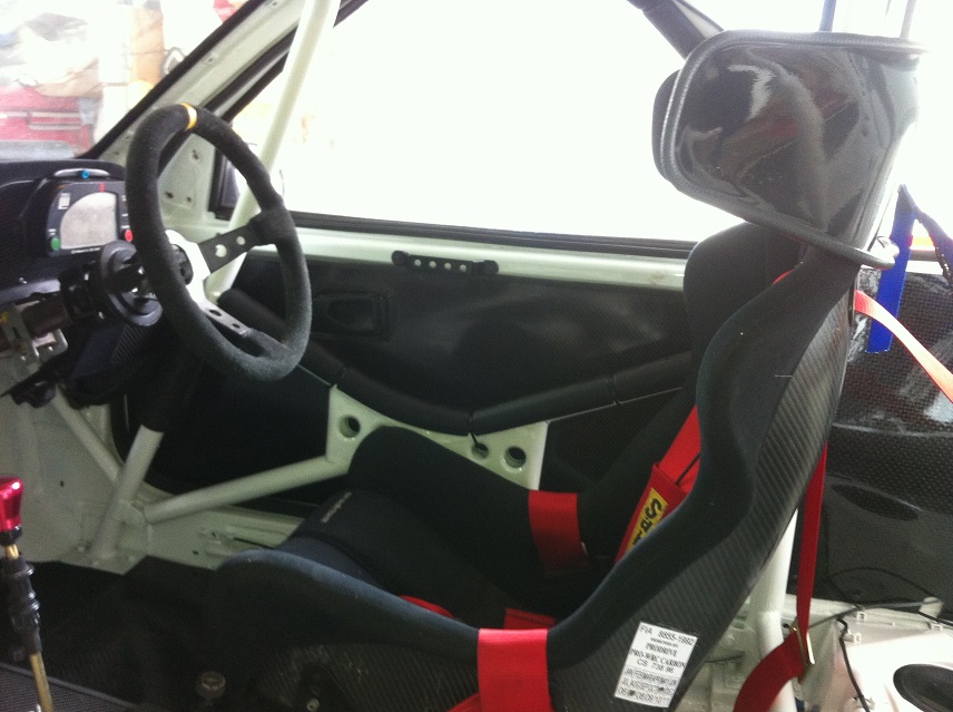

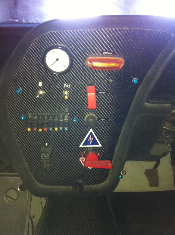

nearly all finished fitting the inside off car up , have finished making braided motorsport  loom and fitted , just got to rewire rad fans when engine bay gets painted , so all going to plan ,also made new carbon rear quarters and fitted digi dash , so a few photos to show progress

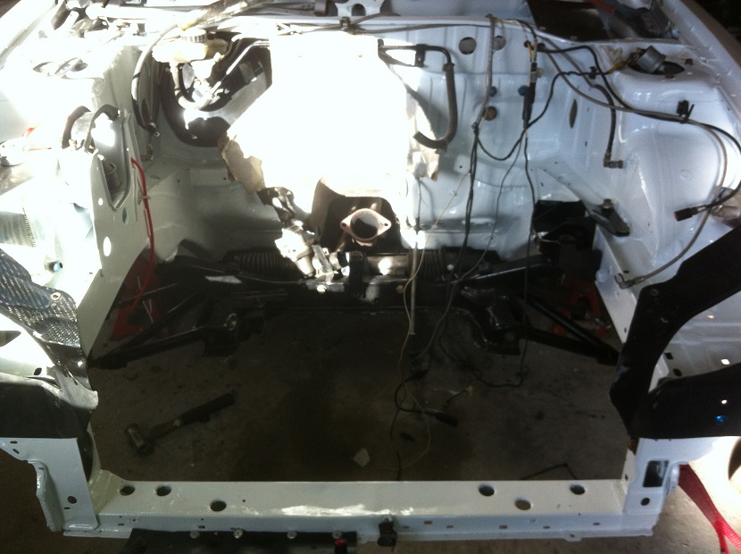

started on engine bay other day , removed engine and box , so engine ready for rebuild now , and soft disced engine bay , then coated with a rust proofer , and gave bay  a good few coat of high build primer , and then scotchied ,then on with the 2 pack bianca white , so all ready for fitting back up anytime , so can clear the man cave of all the bits all over the place

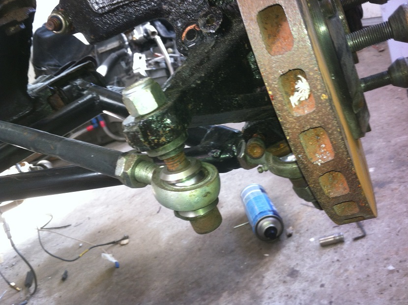

havent had a lot of time to post progress on forum , or as much time as wanted to spend on car , but have got a fair bit done but havent had chance to do upto date photo , have mounted all front suspension and rose jointed vts rack , all wiring done in engine bay now , and all aeroquipped , so all ready to fit engine and box when engine comes back from rebuild , so a few photos , but will add upto date one shortly , hopefully will have all finished and mapped in next few month , and get it out for some testing

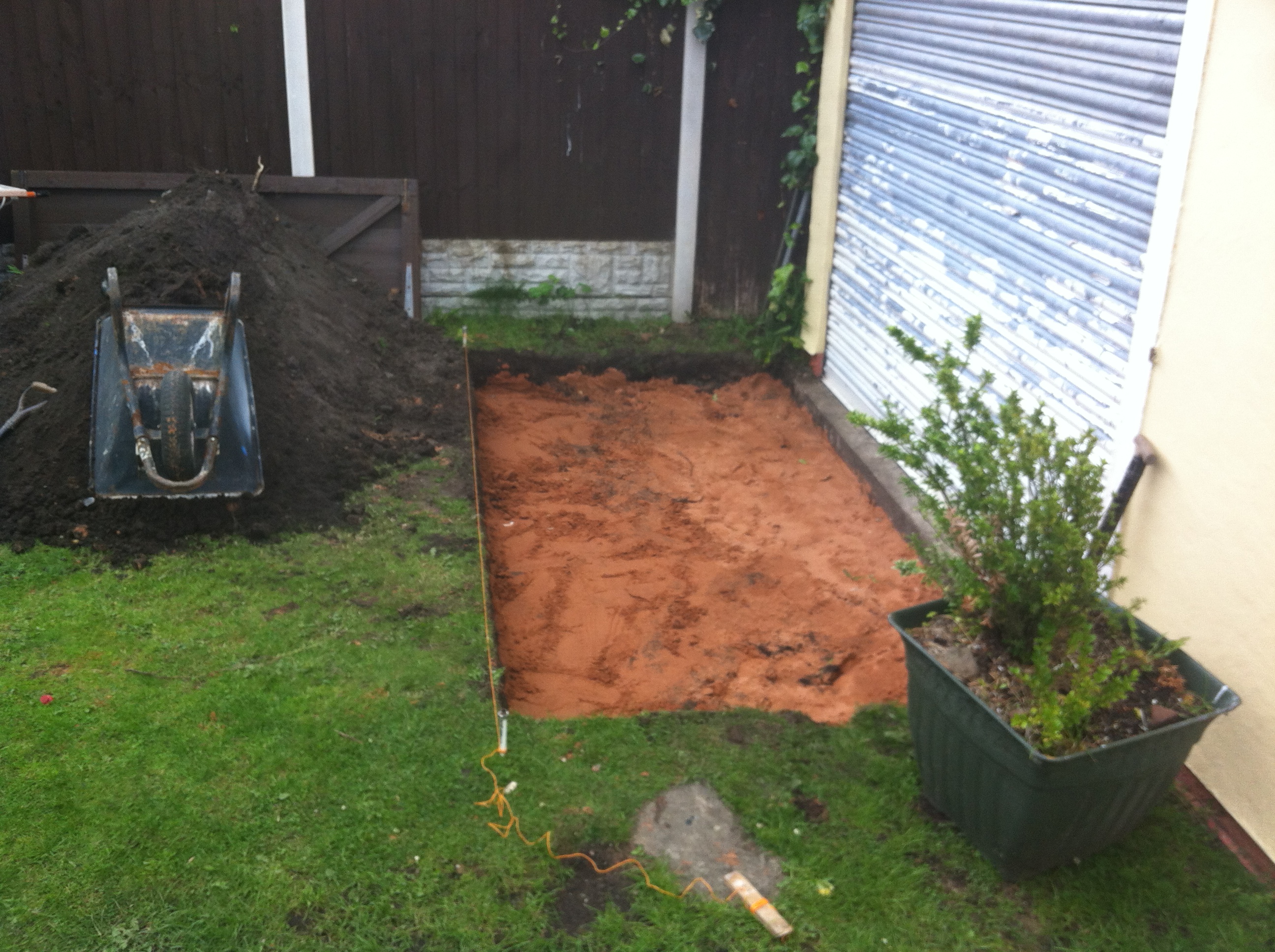

finally  finished  playpen extention and started sourting inside ready to start on maxi kit , just got a few more items to clear and can start getting on with car
Wow what a garage!

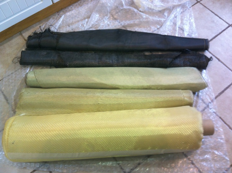

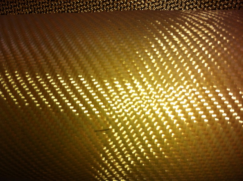

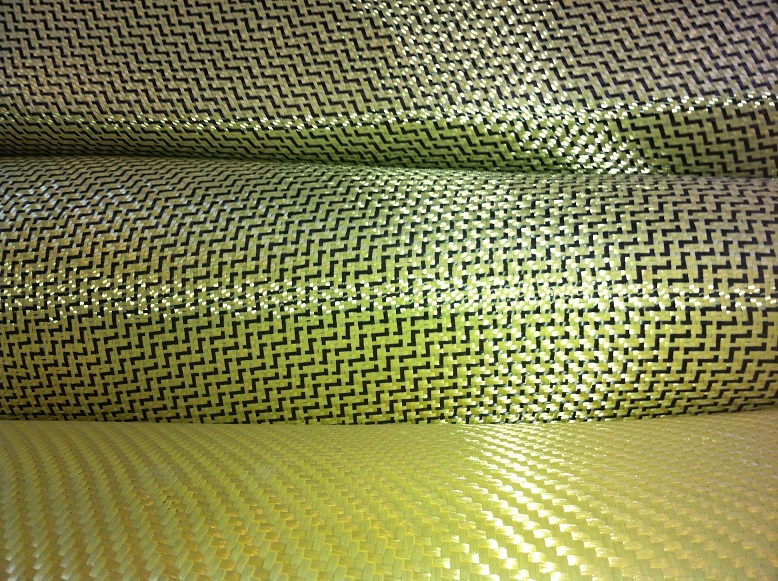

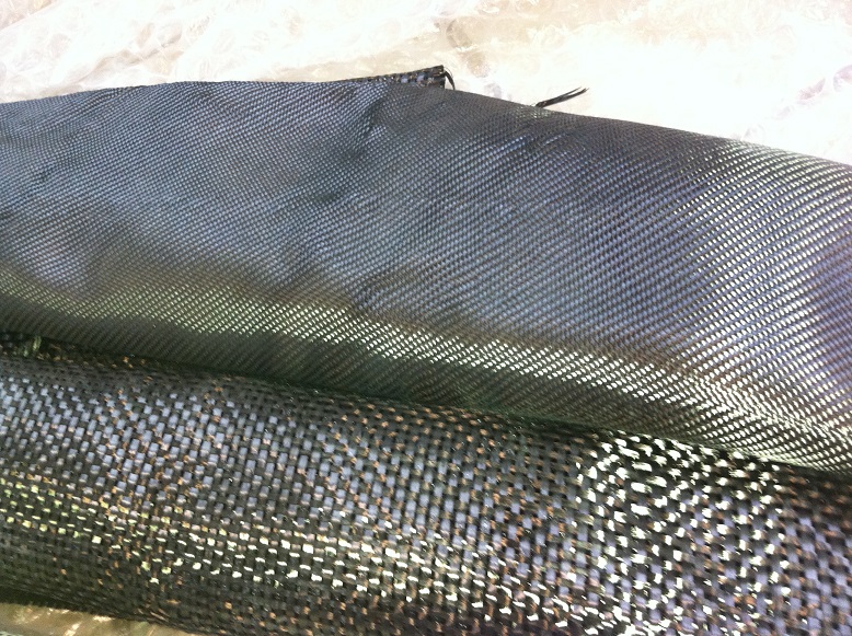

took delivery of all composite today , ready for making dimma /maxi kit for car and other light weight bits as for phase 2 , will be making next weekend so will post photos as going along , have got  kevlar, carbon/kevlar and just carbon fibre , about 80 sq/mtr in total so plenty material to make whatever ,so should be nice and light
I'm potentially interested in light panels when you do get round to making some mate. I know you're busy, and I'm not in a rush.

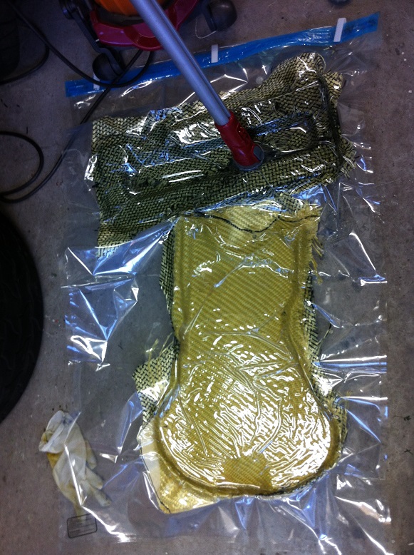

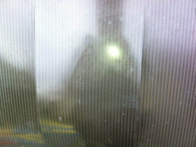

dont no what everyone elses missus are like but mine is forever buying stuff and never using it , well the girl done good this time as found parcel that she had bourt and never used , then she blagged me into buying here a new hoover over weekend and gave me dyson for in garage , so hay presto  ,had a few hours spare this afternoon and layed up carbon kevlar cam cover and coil pack cover and put item to good use , basically vacuumed  items of any air and came out without any air pockets and mega light and can make up in no time at all , so result

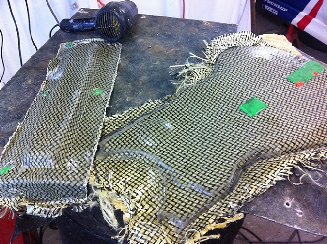

    Productive weekend as mate gnrlee from gti6 / rallye forum came over with his newly acquired dimma/ maxi moulds , so manage to make both back quarters and both front wings , these are vacuumed and made of carbon/ Kevlar and Kevlar cloth , vacuuming uses less resin and takes air pocket out so make mega light as well as mega strong , gnrlee will be producing these using same technique but in fibreglass which will be available for any one wanting to build dimma/ maxi, will add more photos as remove from moulds
