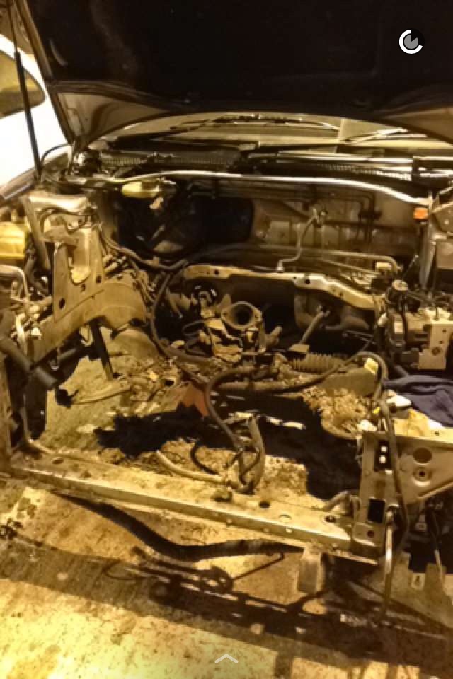

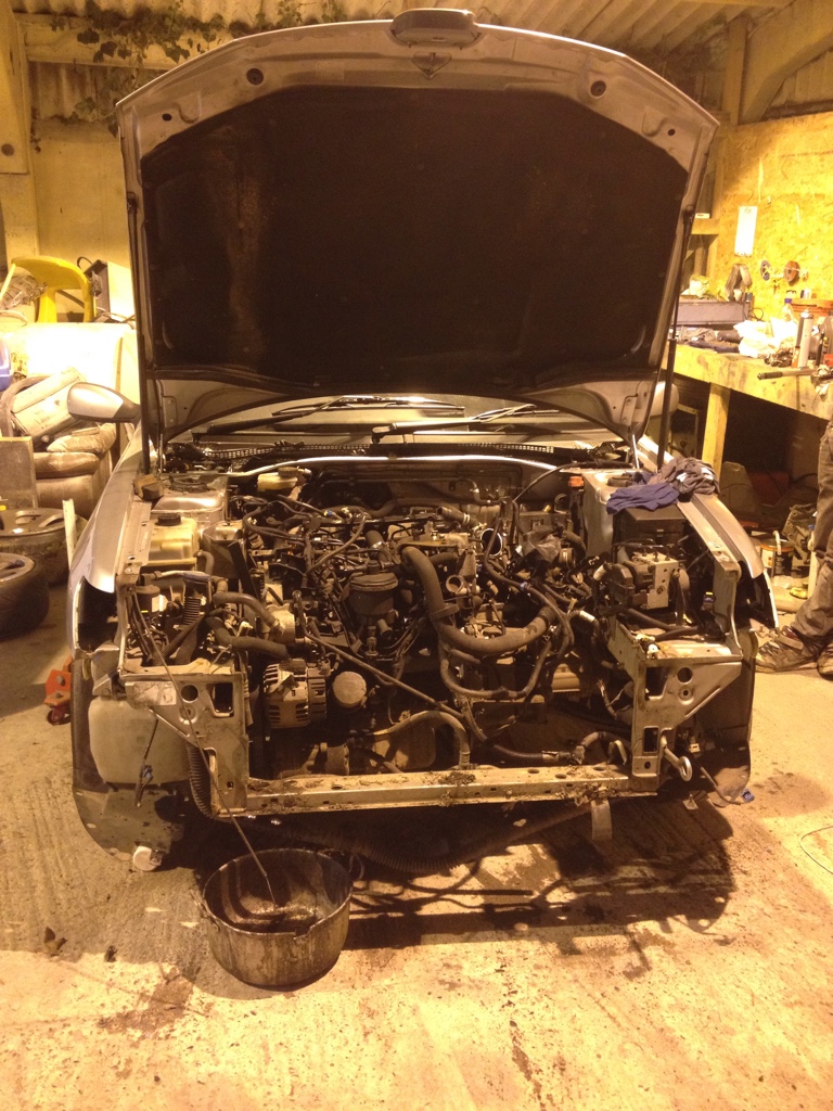

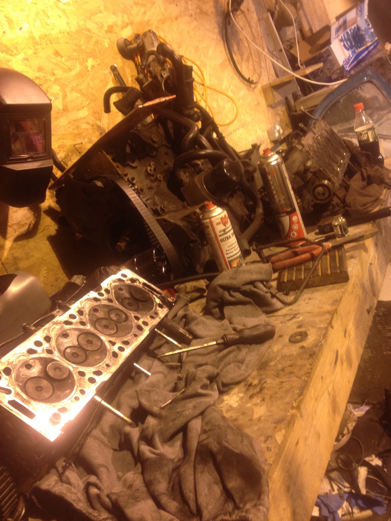

#53
So work is well and truly under way with this now. Engine is out the hdi, head manifold pump is off the 1.9 and its been stripped so just got to slap together now. Smile

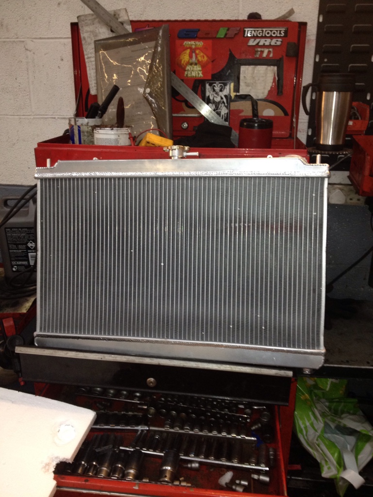

#60
So after my mini freak out last night parts are arriving thick and fast got the headgasket, headset, cambelt and rad today
