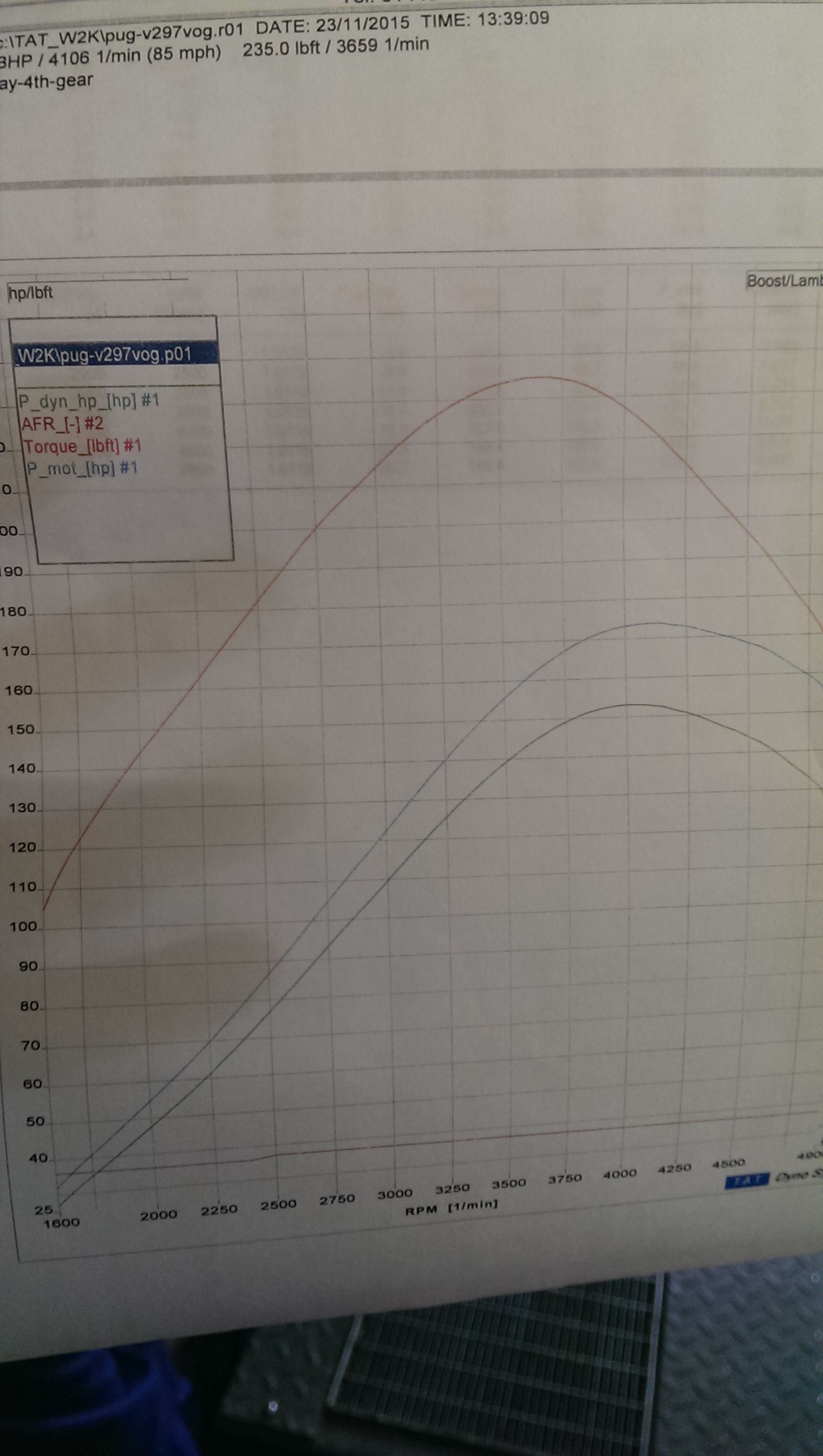

Official now,
173.9bhp,  235ft/lb,
Stage 2.5/3  pro Steve map,
Standard rail sensor,  standard pump, IHI RHF5 1a turbo, GRS motorsport intercooler setup with S2000 filter.

Impressive bhp result Toseland, why such low torque though? Torque limited remap for clutch?

That curve...  Inlove Well chuffed with that, will have to make some more of those. She still tip top Toseland?

Whats the next step toseland? R70/frps/clutch?

306oc generic response: Poor power, horrible curve, why so low
My response: Nice curve dude some real potential here glad to see its all going ok still.

Great result on that toseland! Especially given on stock pump ..etc

Haha well I'll save the trolling for facebook, it's not mega power but as said that curve is very nice indeed, looks very lag free Smile

All facebook trolling aside I take it that's a limited torque map to save your clutch?

I would hope so haha, the clutch slips as is and looking at the stage2 maps I would be expecting 300ft/lb with a proper map.
I have a paddleclutch and stronger spring plate to go in at home already..
Next steps..  1800 bar rail, r70 pump, possibly ARP and then 32psi..
Just having the r70 and 1800bar sensor will allow a lot more finesse with the map, at the moment it's still a little sledgehammerish and unrefined despite that curve...
Soon as the clutch goes in I'll be having another chat with pro Steve.. he will need to redo the map for the 1800bar sensor anyhow
Then replace the springs and sort the lifters out..
This is a starting point.. watch this space.

Good to know. Smile We must take another look at those pipes. Tbh just putting a proper clutch in will give it a whole new lease of life - will allow Steve to really get stuck in. Give us a call later if you want help planning the next round of mods, bang for buck stylee. Smile

I took a look at the map I made you, and it should be good for 180 BHP and a s**t load of torque, I think you're either not boosting right (you want a good 25 PSI), or the fuel pump is maxing out and not getting the fuel in there.
Also, it's possible that the dyno operator isn't putting enough load on it in order to get the turbo to spool up properly at the point where peak torque is set. I did a run at 200% load the other day and it ended up making more power because it got the turbo going properly. Testing on a dyno isn't a great way of simulating the load of the car on the road in my opinion even though they use fourth gear. It's more like flooring it through second and you're through the revs before the turbo is at full boost. Just a thought if you go back there.

Nothing wrong with testing on dyno, but operator just needs to slow down the ramp speed...250-300rpm/sec I find to be a pretty good ramp rate for most blown applications..anything more and as you said, you wont make anything like max torque....

according to the gauge its sitting at a solid 24psi.  it pins at max boost until i hit the redline so it could be either tbh..  possibly the dyno then...
i am thinking however it might be the pump because unless i am missing something that i dont know about i have a standard clutch in there and 300ft/lb should shred the clutch to pieces..
worth investigationg either way
