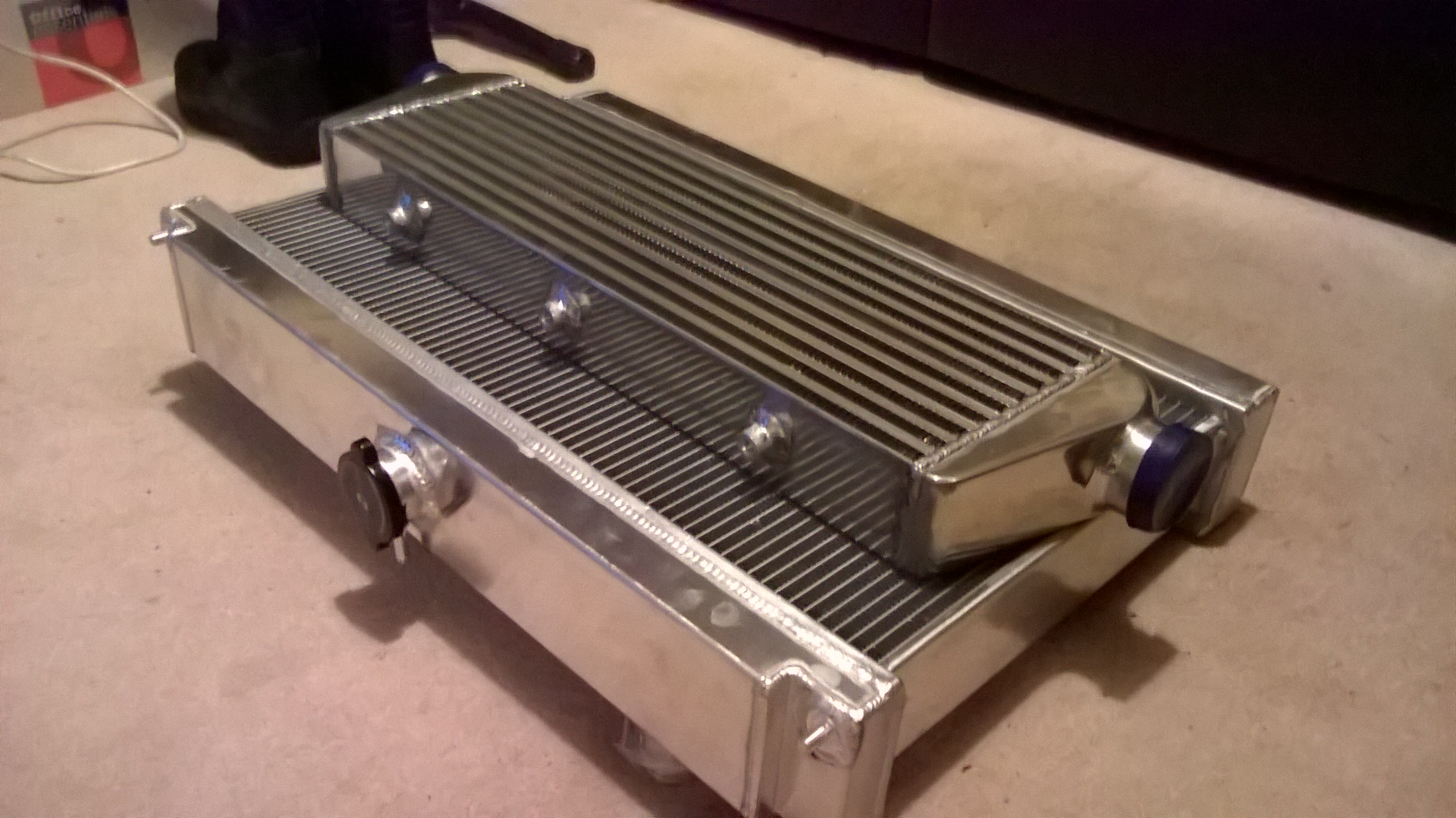

Also got a bargain on a huge Japspeed rad at £50 off on ebay and an aftermarket intercooler for the same price as people are selling them for second hand.

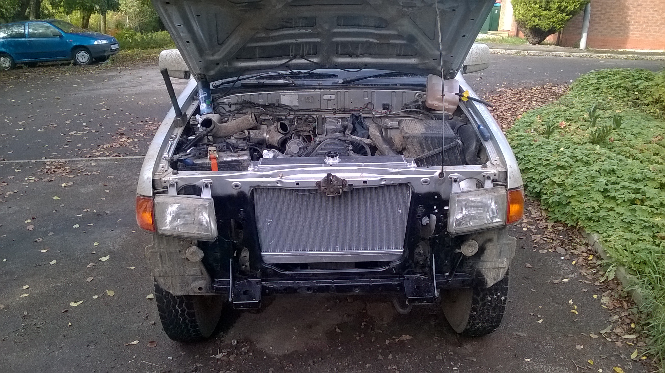

Had to knock up a set of custom brackets for the rad but it wasn't the end of the world, just time consuming. Looks an utter beast.
And here she is waiting for me to trim the grille and refit that.

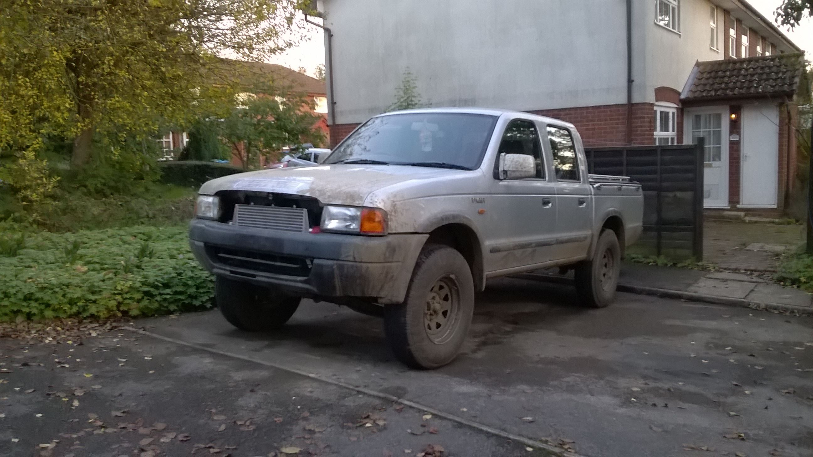

She looks an utter beast muddy.

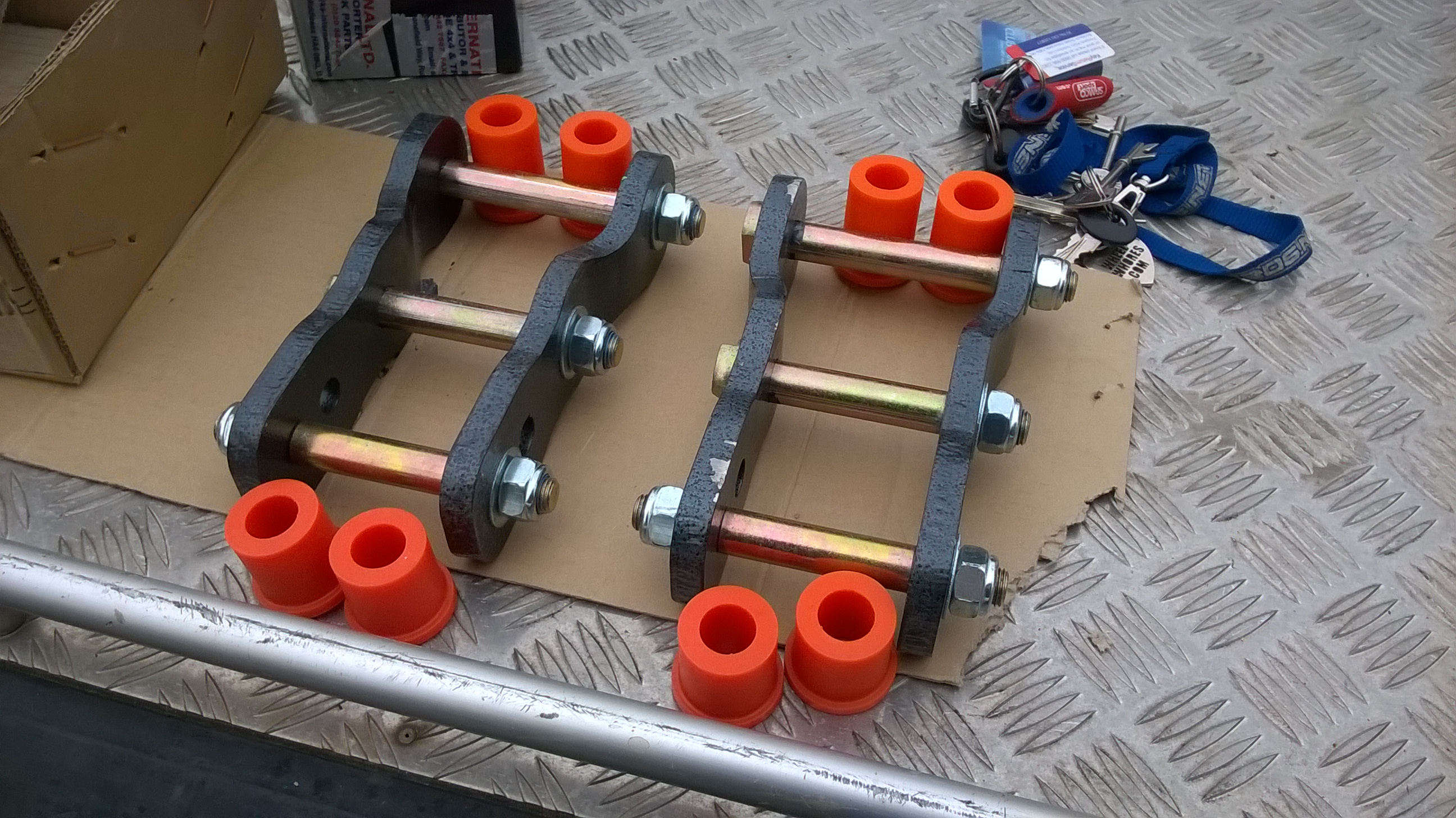

Got my longer rear shackles here so she'll be sitting level again soon.

Yeah they are +2" shackles and the front is only up 2" so will bring it back to being just a tad nose down. Gonna attack the front upper bump stops and try and get another half inch on the front so it's nearer level as i hate it looking nose down.
Got poly bushes for the springs and shackles when I get round to fitting them too Smile

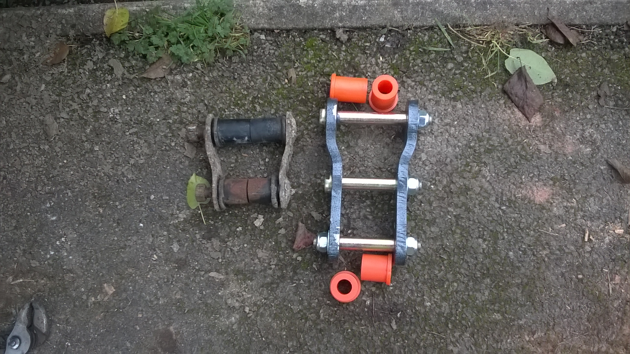

Annoyingly the truck has split a coolant hose so cant drive her till replacement bits turn up but the longer shackles are on
