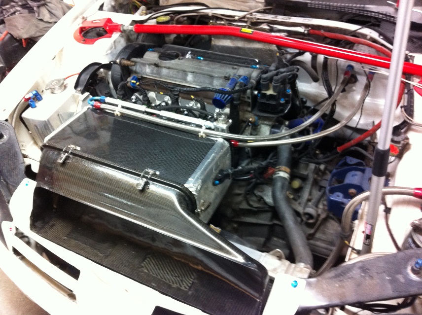

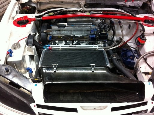

Airbox looks awesome, reminds me quite a bit of the airbox on the maxi rally car
Thanks given by: twangy
(27-10-2015, 01:05 PM)Midnightclub Wrote: Airbox looks awesome, reminds me quite a bit of the airbox on the maxi rally car
thanks mate
those things are going to suck better than a turbo charged hoover,
the air box look epic, good job. Just think of all that lovly cold air being pushed through the gap straight into your jenvys Smile
Are you running unfiltered? or will your at least put a pre screen on?

(27-10-2015, 01:09 PM)insomaniac45 Wrote: those things are going to suck better than a turbo charged hoover,
cheers mate , yes will be running a filter  just haven't had time to order or fit , should get plenty of cold air to jenveys like you say

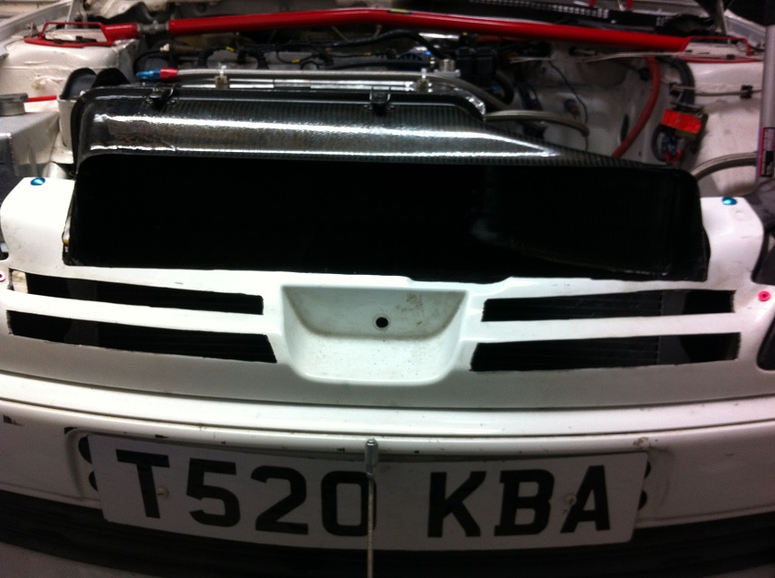

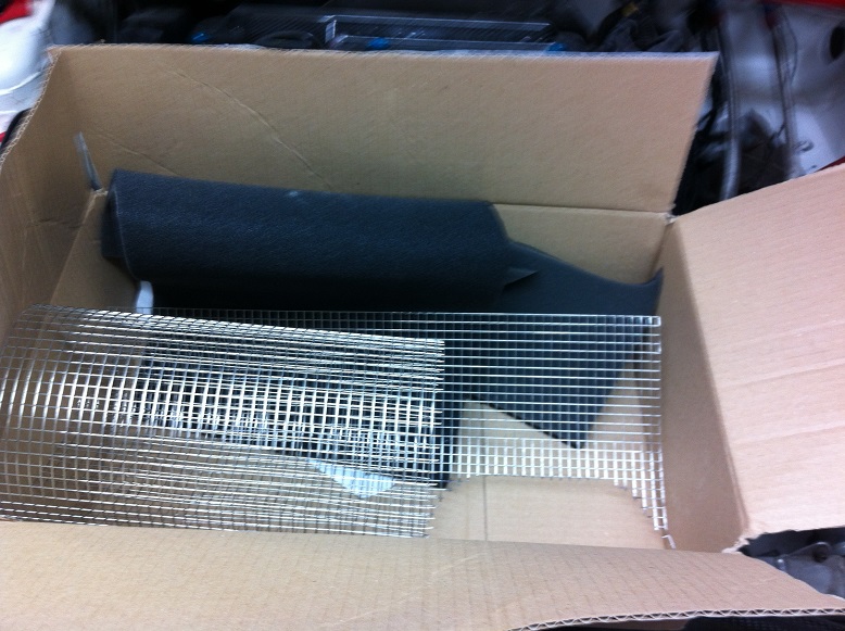

finished air box and made and fitted filter as ramair supplied me with  filter caging and filter foam for a bargain price of £15  next day delivery , and best of all enough to make a spare 1 , , total bargain

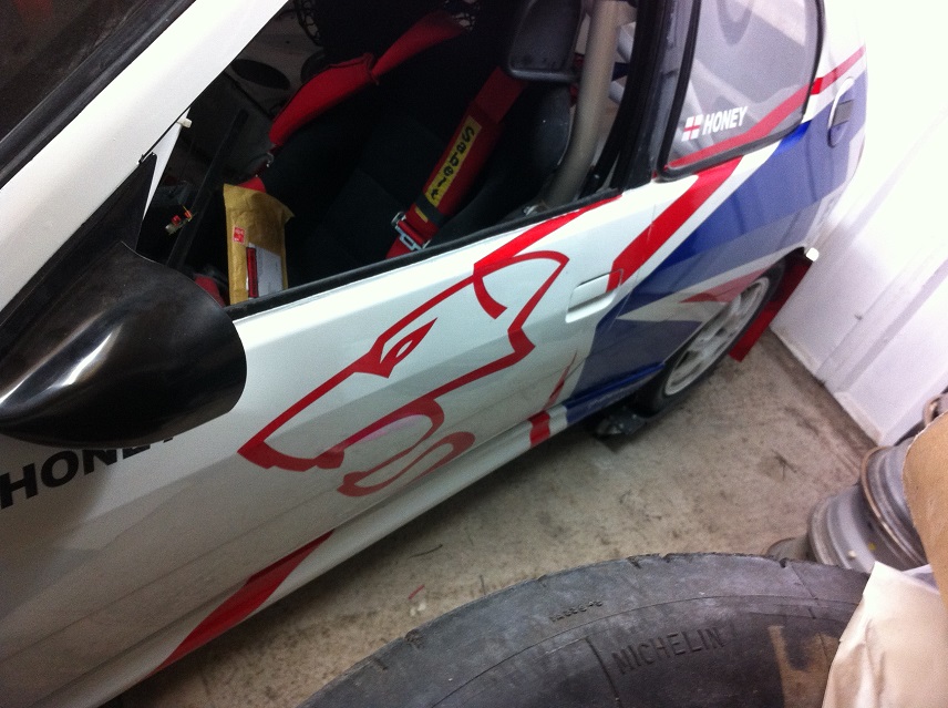

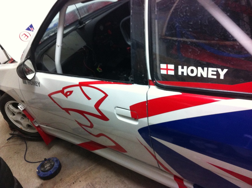

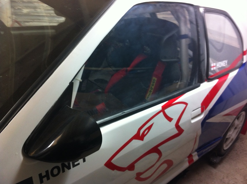

finally got round to  priming and painting carbon fibre door and lower quarter  were rub strips removed , and started fitting graphics
carbon  n/s door all now fitted up , and made a start on dropping front cross member as  am seam welding it  so removed and started to grind down ready for welding

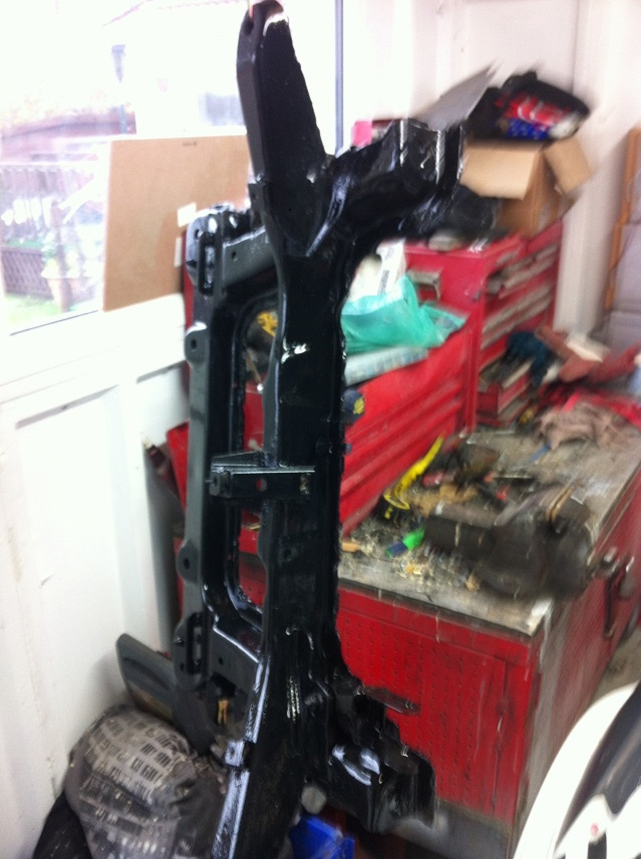

seam welded subframe all painted and ready for refitting , so will refit over weekend

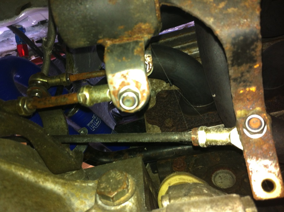

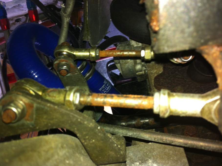

while i had subframe stripped off, took some photos of rosejointed gear linkage that was made  up
