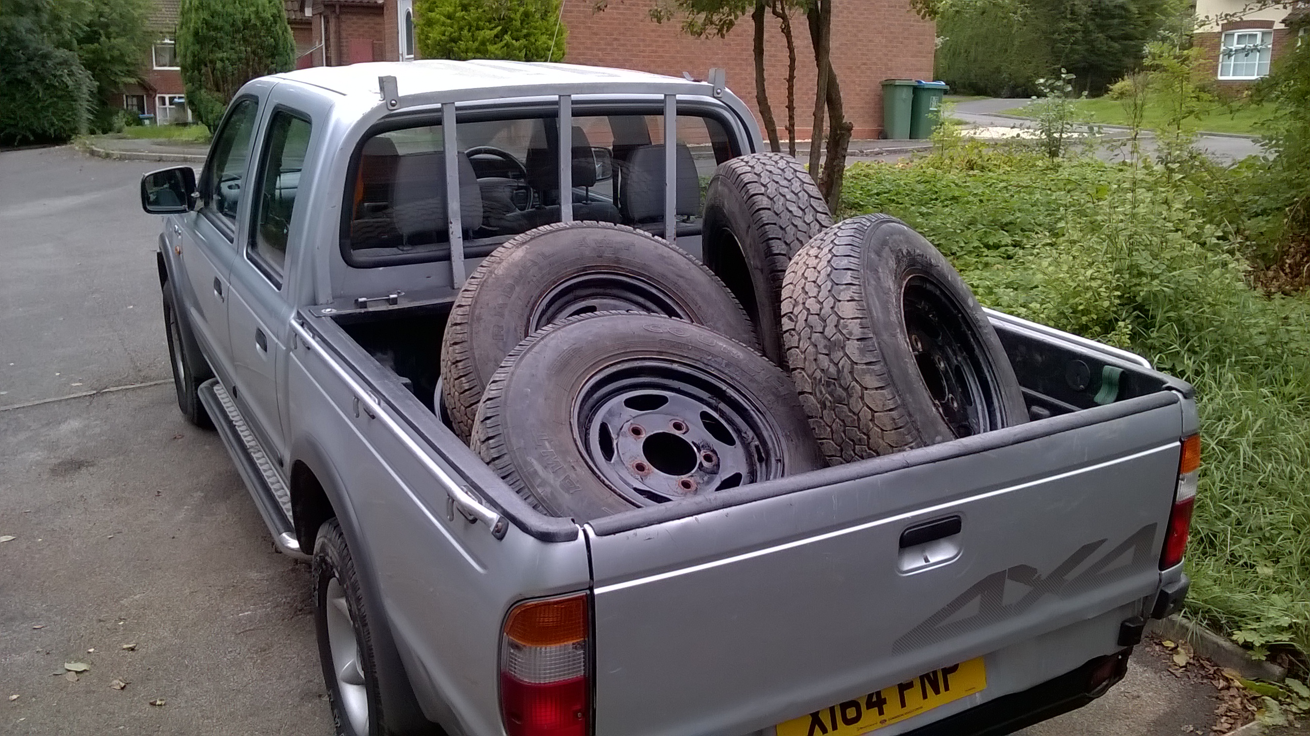

Got a delivery and a half off Milner
This included a set of wheels 16x7 were £35 each new
For which I bought some nice tall all terrain tyres on land rover wheels for £80

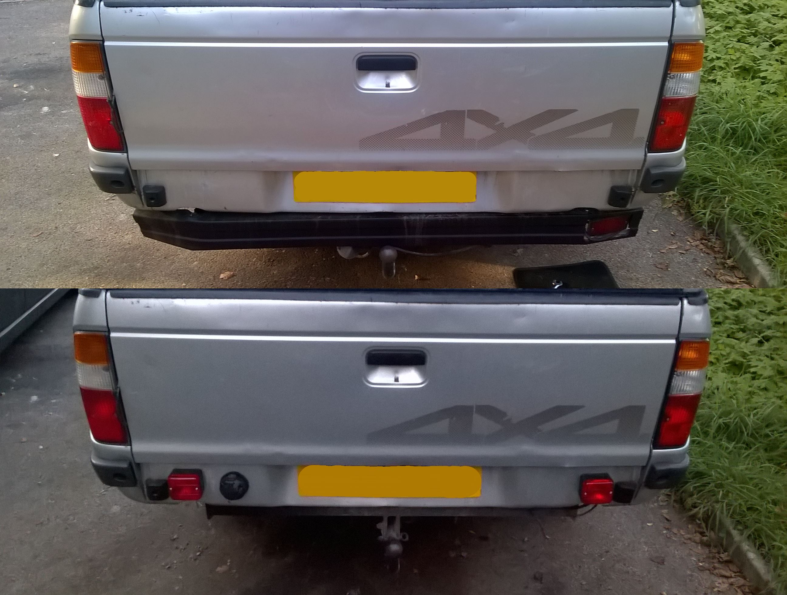

I changed the smashed rear light. Brand new from milner was less than £20

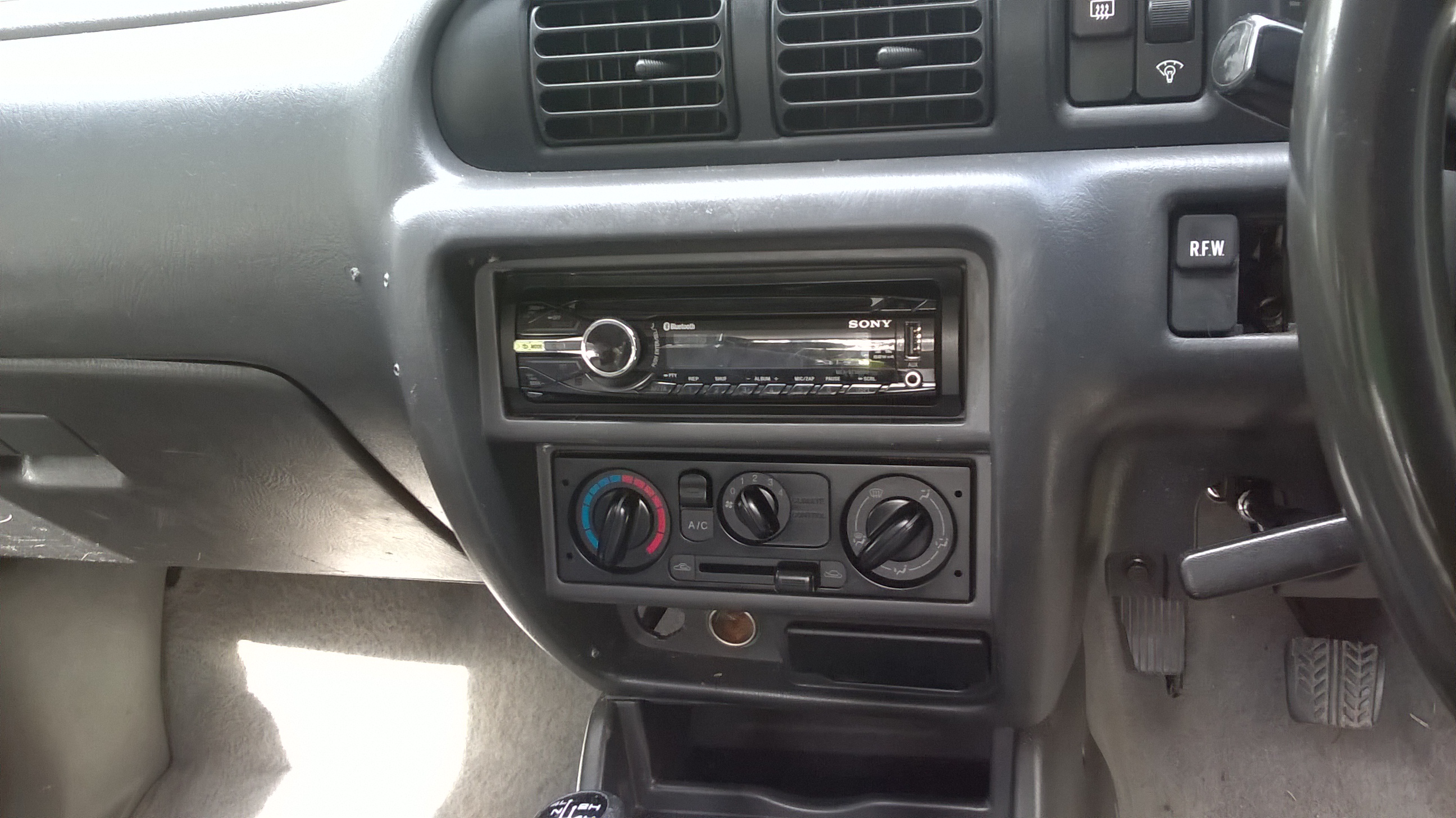

I've fitted my old stereo out of the rallye
And removed the hands free kit that included an absolute tone of wiring and magic boxes

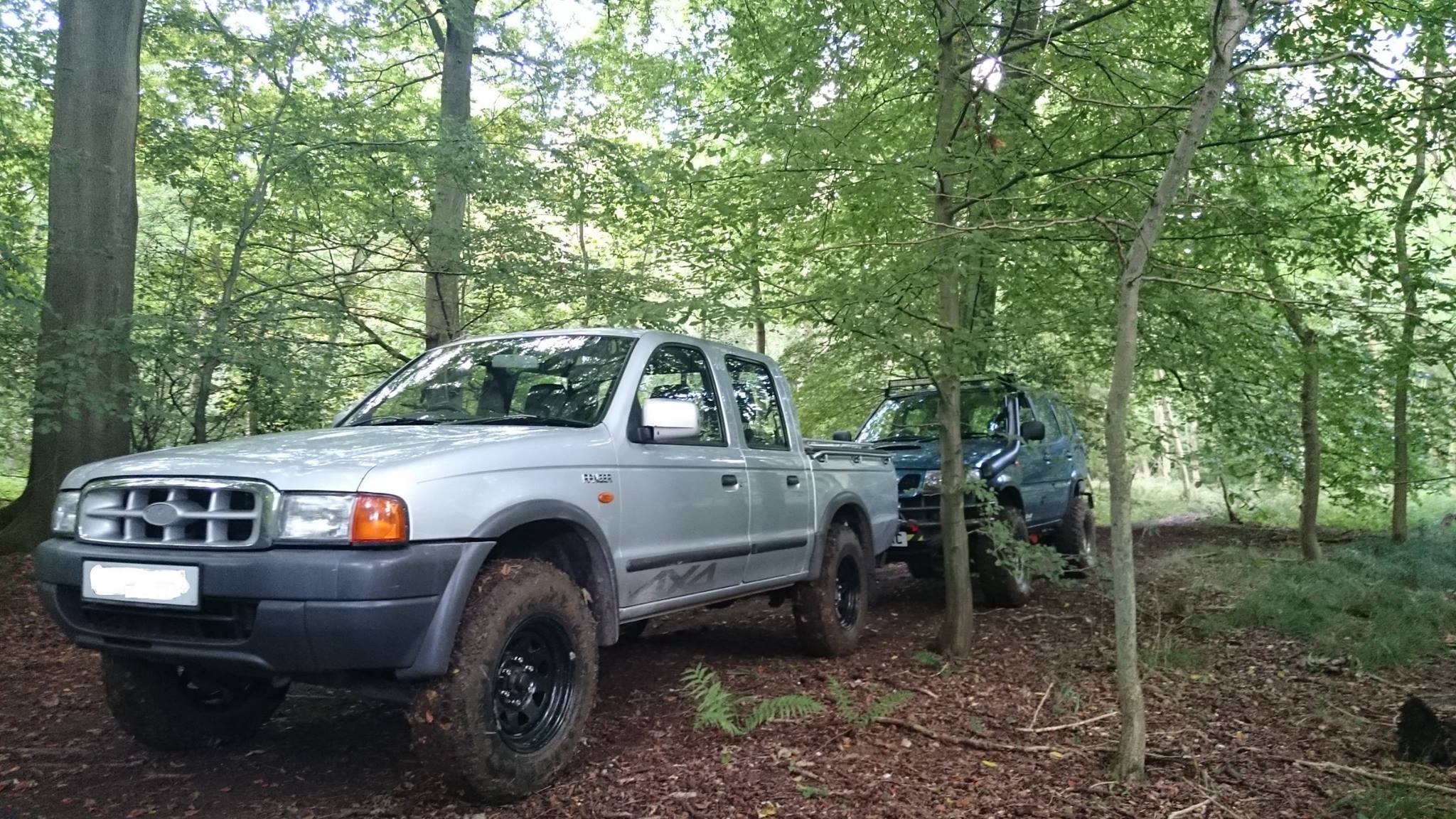

Fitted the shiny new wheels with some 235/85R16 AT (M&S) tyres. These are nearly 32" tall which is almost 4" taller than the standard wheels and so gives 2" more ground clearance. I also wound up the front torsion bars by 2" leaving her like this.
I took her out green laning
And I've just been playing with the rear end for a little more clearance as the bumper keeps eating grass and I was going to loose the old tow bar plug.
Just looking at some longer rear spring shackles so I can lift the rear by 2" and get her level again then it'sa body lift kit and wheel spacers when I can afford it.

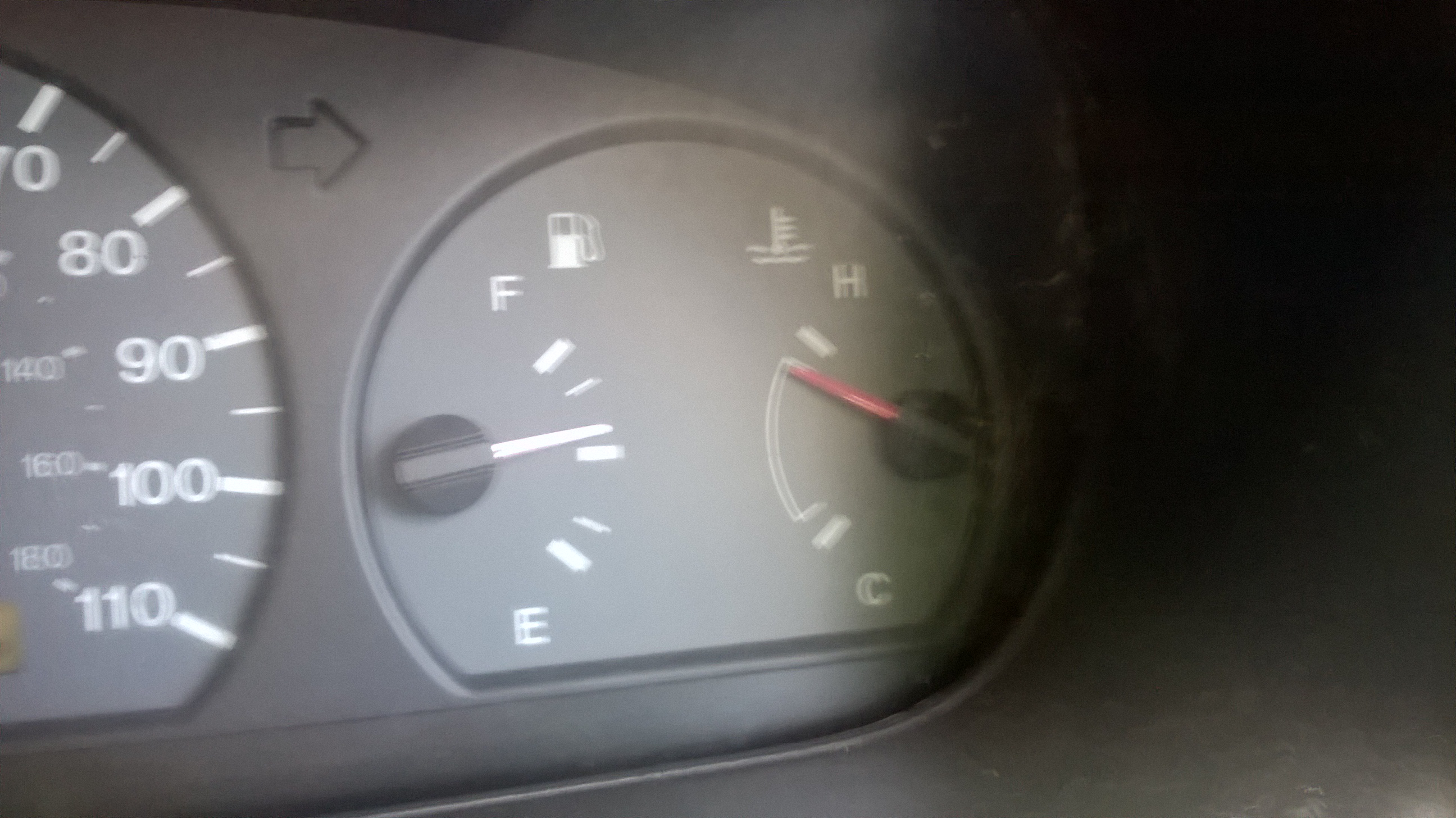

So she's always got a bit warm sitting at speed but it's getting worse now especially after the dunking in the mud, thinking I've blocked the rad/fmic/air con rad. With no signs that the HG is going sadly I think this means that me working air con is going to end up going. I suppose as I haven't had working air con in about a decade I'm not gonna miss it too much but it was nice while it lasted.
Probably gonna fit a big aftermarket rad and an aftermarket intercooler when I do the body lift.
This was sitting at about 60mph (although up hill and into the wind so defo on throttle). I hate not knowing what the gauge means when it's up there, is that 90 or is it 120? Who knows? It scares the life out of me.
