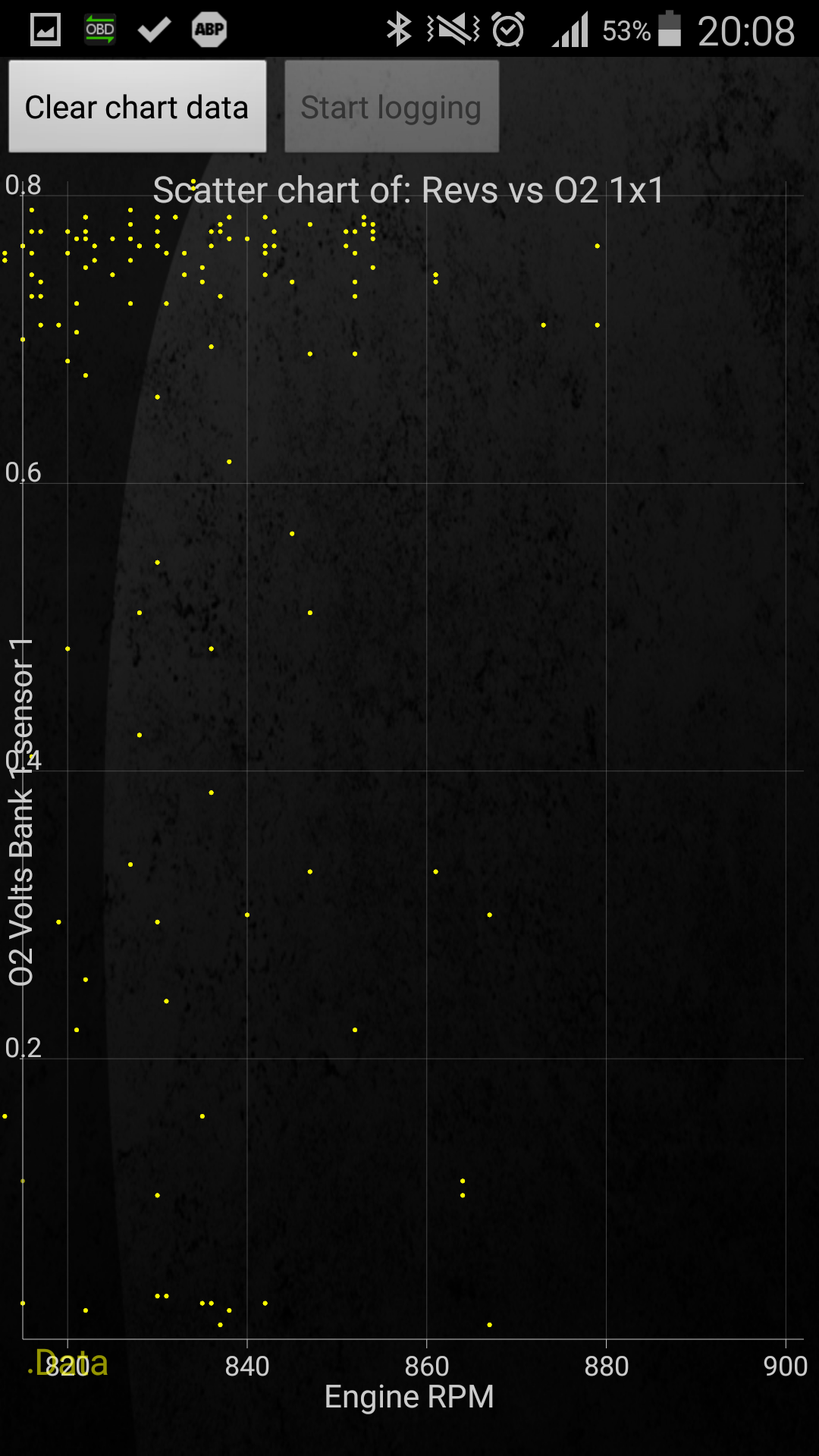

I'm still not happy with the idle/running though. There is something wrong somewhere I'm sure of it. Swapped out the coilpacks and o2 sensor for spares with minimal improvement.
Plugged in the obd reader and watched the o2 sensor voltage / fuel trims.
Voltage seems to be hanging around the 0.8v area (rich) and the long term fuel trim was a good -8% while the engine was warming up (1000rpm) then when it went closed loop it rose up to -12.5%  . Was at -13.3 yesterday and I think that was the maximum it would go hence the EML light and code P0170
[Image: mcetg0.png]

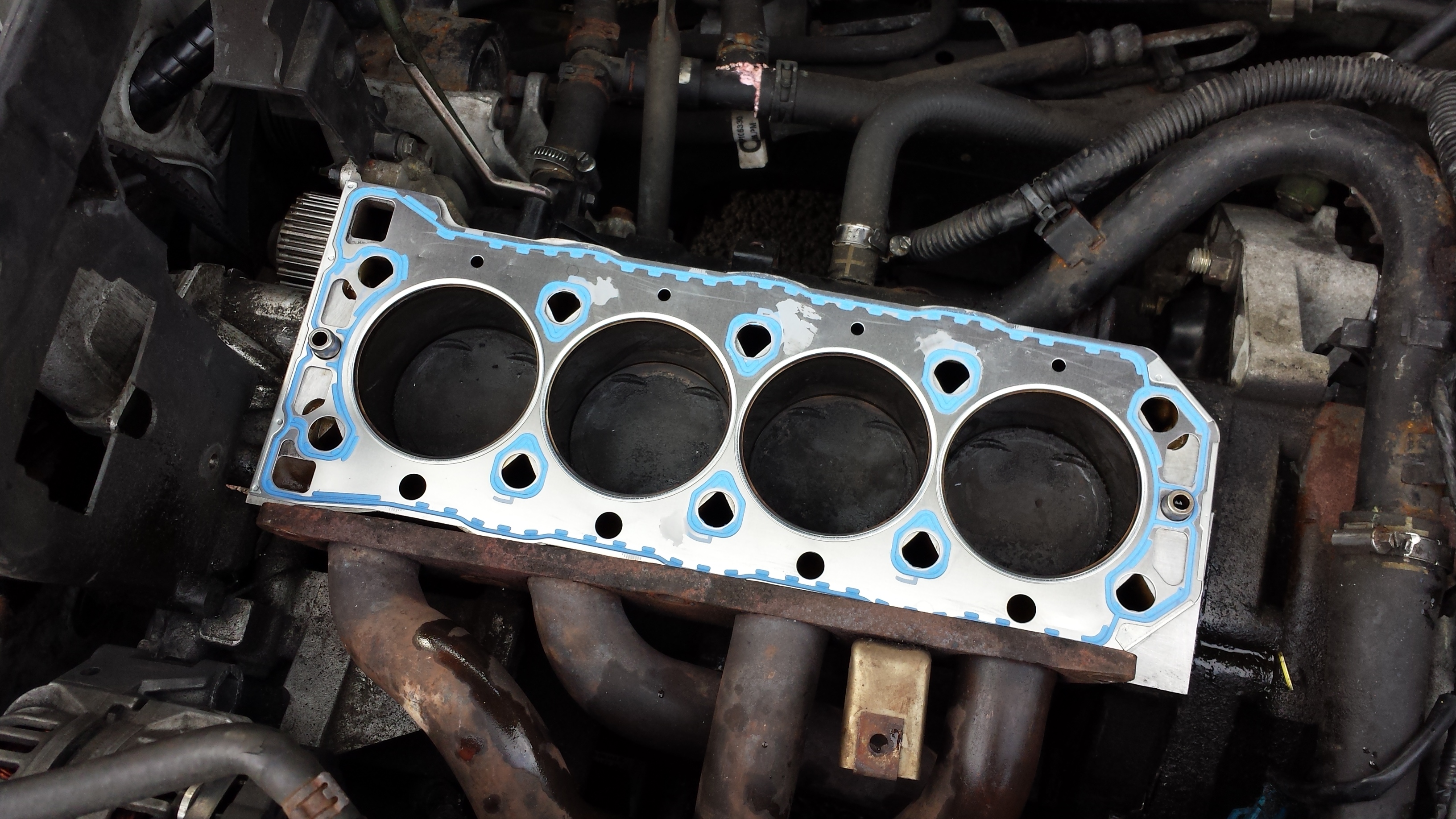

So laugh if you want but I'm doing the head gasket again.
It's not that it's failed so much in that I used the wrong one when i did it last. The liners were flat with the block and you're not suppose to use the MLS gasket but the original style one...unfortunate I didn't have the right one at the time so had to make do with the MLS. I also didn't check the bolts properly and just put them back in without checking tolerances.
So this time I've ordered KAMAX bolts & the latest PAYEN gasket so I can be happy with the quality of parts.
At this rate I really will become a headgasket expert
[Image: mcetg0.png]

I've tried 3 different (used) lambda sensors but they all read the same. Connected up the reader to my friends vvc and was happy with his numbers (sensor voltage, stft, ltft) so there is something wrong with mine for sure. Will know when the head is off I guess and have a new lambda to fit when it's done
[Image: mcetg0.png]
It seems strange that the wrong head gasket would make it rich though? I suppose if it's not burning correctly, the mixture out the tailpipe will be unburned and rich with fuel.
You can always also adjust the target lambda the ecu is aiming for. Stock for emissions will be lambda:1 but if you run slightly richer than that, say down at 13:1 AFR it always smooths out a slightly lumpy idle.
I suspect the idle is to do with your exhaust cam, more duration does that... Try richening up the target mixture and it will stock the fuel trims pulling it lean too!

Yeah I think it's just not getting full compression on one or more of the cylinders, incorrect compression resulting in poor burn?. My ebay compression tester may let me know if thats the case unless it's broken (being £12 it wouldnt surprise)
Will need to find the target lambda settings, remember looking for them as a table a while ago but didnt spot anything. Still need to get on a dyno and confirm fuel maps really but everytime I put money aside to get it roll'd something breaks Sad

oh way to having a new gasket and a running car again. However..
When I dropping the head back down I saw a bit of oil drip from the head onto the gasket out the corner of my eye.
In my desperation to get the engine back together and headbolts in I whacked the bolts in and torqued them up as was getting tired (back was hurting from trying to lift the head while bent over)  and annoyed of the local kids all stood around asking me questions, touching my stuff and just being irritating little...
Is this likely to have rendered all the work for naught? The engine is halfway to reassembly as belts are on
Or will the clamping force be enough to squeeze out any oil between gasket and surface
Very disappointed in myself for rushing the job as wanted to do it properly but the lack of garage means I cant spend more time on stuff
Also if an engine hasnt been turned on (eg no heat cycle) could the gasket be reused? this gasket type doesnt seem to compress much or at least not as much as the mls.
[Image: mcetg0.png]
Depends how much oil, one drop on a fibre gasket wont matter but a good bit probably will. You definitely couldn't remove the head and re use the gasket once torqued up but by the looks of those valves might be worth removing it and cleaning and re lapping in all the valves, they look crusty out...... Two birds with one stone
Yeah that head wants a good clean up buddy!
As said, no reuse. Sucks a bit pal, hope its ok.
Weak.
Going to try it as it is and if not satisfied will order another gasket to do it again as only £25 for a gasket

Given its mostly apart would you not just do it correctly now? spend a day removing and lapping the valves and cleaning head properly, be very surprised if those valves aren't leaking, if even a small bit.
