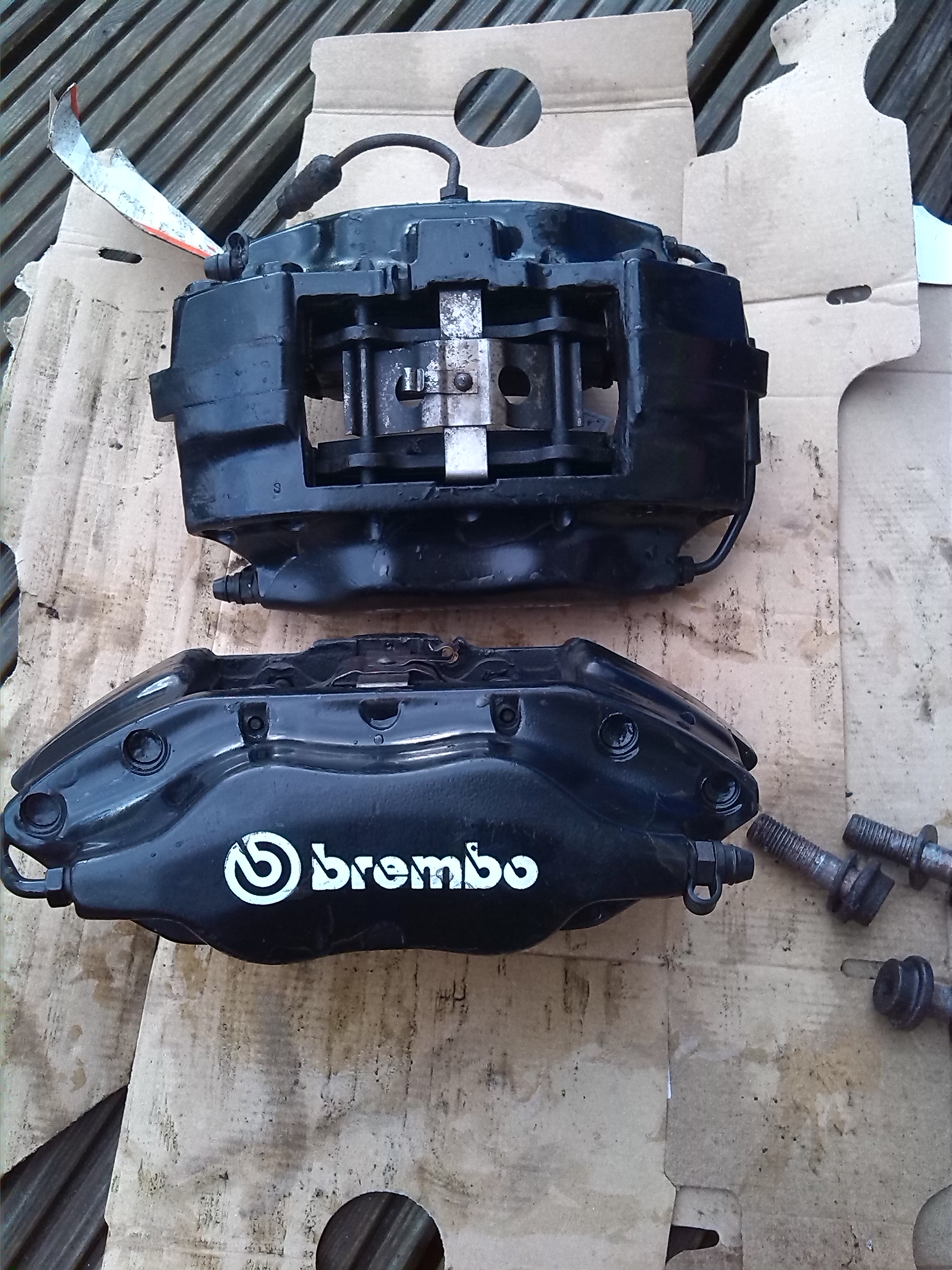

A dirty set of hands a pulled butt cheek muscle and £40 lighter I'm off home with a big smile and big brakes!

Hi Janne and Adam, your not far wrong about the price Janne, on new/reconditioned! My sister is in the parts trade and she looked the callipers up reconditioned and if your a good customer (mates rates) you can get them fairly cheap! £75-85 each side which is pretty much how much mine just did used!
I've kinda embarrasingly discovered last night after fuelling up £15 I can't afford to replace disks, pads, fitting kit etc right now so the brembos arent being fitted and will likely find a new home soon enough and the way things are going now my car might end up offskie too! :-(
