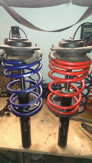

So, a little progress as the car is now lowered and stable
Visited the beam fairy, and purchased a shiney new '6 beam, lowered 40-50mm, new febi mounts all round and powerflex assisters fitted as they were cheap
Blistein B4s on the front with H+R 40mm lowering springs (lovely ride)  red came with it @ 60mm, too low for me on the HDi as they are/were 6 springs,
Also fitted some nice new lemforder balljoints to the front and these arms, with powerflex black polybushes front and back and the ride is precise and solid.
