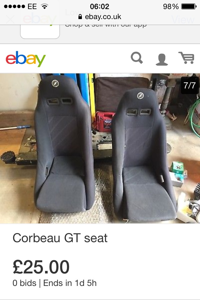

Bagged a pair of Corbeau fixed back bucket seats so going to butcher the original seats for the frames/sliders etc.

Managed to win the seats for £50 in the end
