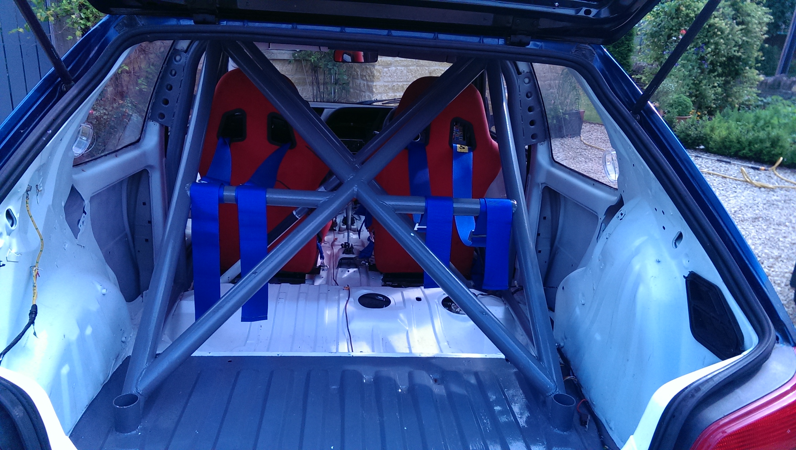

Mine would be classed as that then...
[Image: cage.jpg]
It's an entry level car, in fact doesn't meet the criteria yet by some margin!

(18-05-2015, 07:58 PM)adam b Wrote: Mine would be classed as that then...
[Image: cage.jpg]
Looks nice setup, seems very narrow mind.
And despite it being a weld in and top job, as you say, doesn't meet the criteria of a rally car by some way, despite some of them having off the shelf bolt in cages.

the cage meets the criteria certainly, its just the car hasn't the suspension or guards to cope with rallying yet.
cage is not narrow, its as wide as it needs to be, it is one of the "lower classes" as you deem it, its fully welded in, gusseted to the A and B-pillars, double door bars, bottom of main hoop to rear legs linked, welded to both beam mounting points. and a full double cross main hoop and rear legs.
#55
I can see where it's welded and what it has.... I have eyes weirdly enough.
Still quite narrow as cages full go.
#56

what do you mean narrow?!
every weld in 306 cage ive seen look pretty damn similar, including the ones in the 306 maxi, which if you are too young to remember them were capable of being quicker than a wrc car at the time in the right hands.
