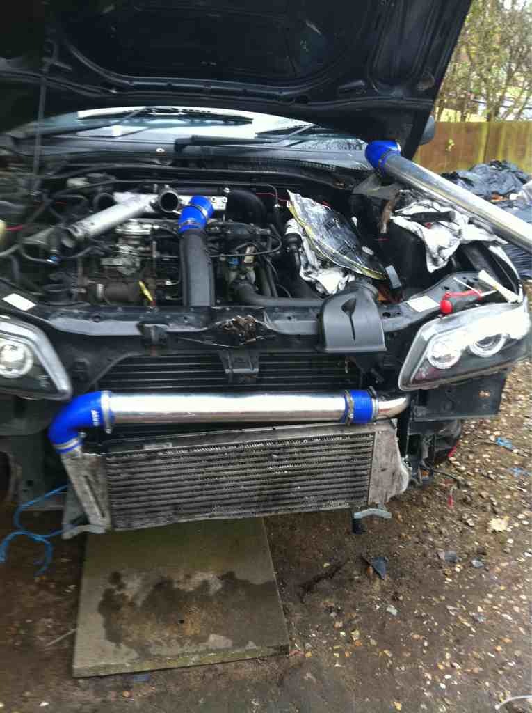

been taking the xud out after fitting fmic, and instead of the 14 psi i had on the top mount its only boosting to like 10/11 now so i presume theres a boost leak somewhere. I've been round and checked all connections and can't seem to pin point where it is. nothings blowing off but air is escaping from somewhere.

what size FMIC have you got, what turbo you running and where iis your boost gauge located? - thats a fairly low PSI anyway, 14 on an 'upped' turbo is low, on a derv at least.
the fmic is purely to prevent heat soak, in your case at least. if the new FMIC core is too smal, it will be restricting air flow rather that helping it - again, where hasve you located your boost gauge? any pics/info on fmic?

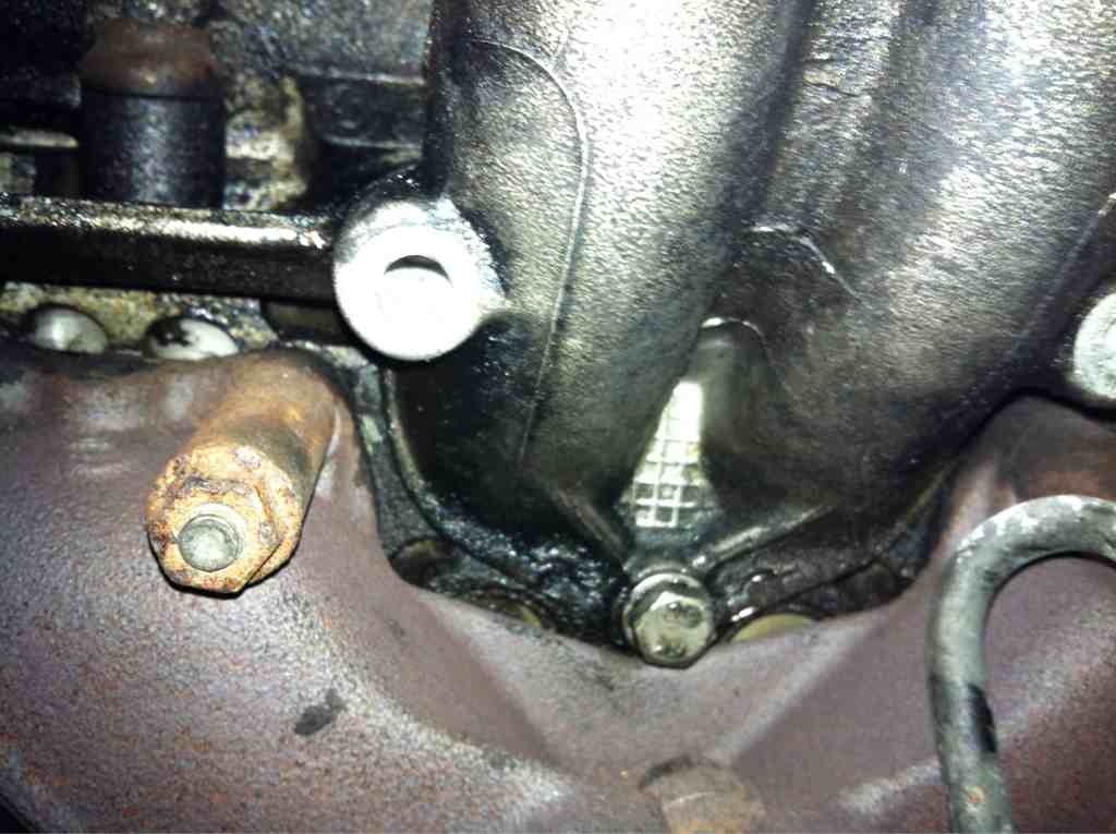

I think the 13m nut at the bottom of the inlet is loose but was impossible to access without exhaust and turbo dropping.

Bolt loose, f*ck that, there is an entire stud missing (like where the empty hole is) in that last photo, sort that out before wasting time looking for leaks else where as if half the manifold bolts are missing then you don't really need to look any further!
You can get to all of that with everything still in place too, stand at passenger side wing facing the engine and use your right arm along the back of the block using a 1/4" drive socket set, some extensions and universal joint you can do it Smile

Theres 2 studs missing in that photo! Confusedhock:
And also, your LDA looks like the top screw is screwed right down. Have you dont that on purpose or is that how it came? Because its wrong lol Tongue
Well, that's where your boost has gone!

OK so out of the 3 inlet manifold bolts visible in that photo, 2 of them are missing, doesn't bode well for the rest of the manifold but I think that might be the problem :o
Team Orange Engine Bay
That pic was from wen I was taking the manifold off so apart from the 13m nut all the studs are tight as f. So I dnt think it's that.

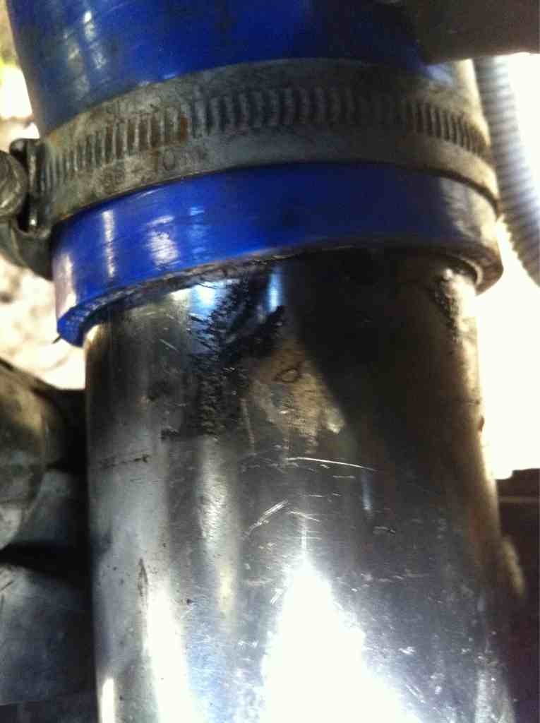

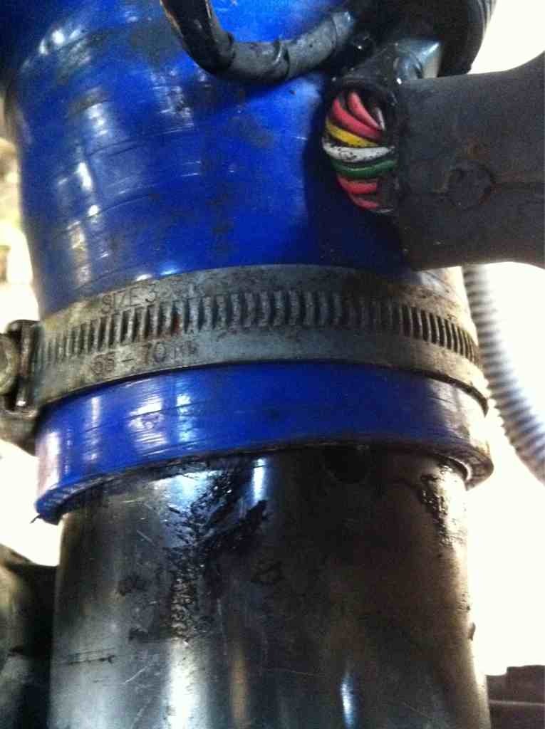

Yea sorry bout that, well looking round, ive re-attached everything and eventually found this hole drilled into the side of one of the pipes. Couldn't see it before I twisted the pipe. U can see it in the pics. So covered that as there was some play in the silicone and the noise went. Smile but a good rag to what looked Like more than 15psi for a second, and it all came apart.
All the hose clips started slipping when I tightened them and lost boost so I'm goin to replace all the ones I havn't and cover the hole up tomorrow. Also got a proper t piece and better boost hose for the boost gauge coming in the morning so we'l see how she runs then, but looking promising.

Pics, the hole is just top right under silicone, little bugger!

Got a spare bit of silicon to slide over that hole? Stop the leak
Buy a new piece of silicone...........if there is a hole in it then your not stopping it leaking!

Could always find a bolt to screw into that hole?
Was that hole used for a boost gauge by any chance?

It's in the ally pipe, yea the silicone behind in the pic goes over but I'm not sure if it's enough.
It looks like a random hole? The boost gauge is tapped into the silicone at the inlet side. That pipes between the rad at the bottom.
I managed to get it boosting well today, flickered up to 19 ish a few times. I'm guns re route it tho the outlet pipes go infront and round the back of the rad so I want to get it up under the bonet catch this week.
We had a laser thermometer on the pipes and the air was coming out the same temp as it goes in the fmic so it's effectively pointless lol.
