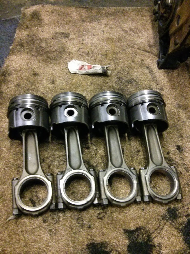

Rods and pistons out:
[Image: IMG_20140212_152031.jpg]

OEM rods next to replacement rods:
[Image: IMG_20140212_155609.jpg]
[Image: IMG_20140212_155627.jpg]
And on the pistons:
[Image: IMG_20140212_160929.jpg]
