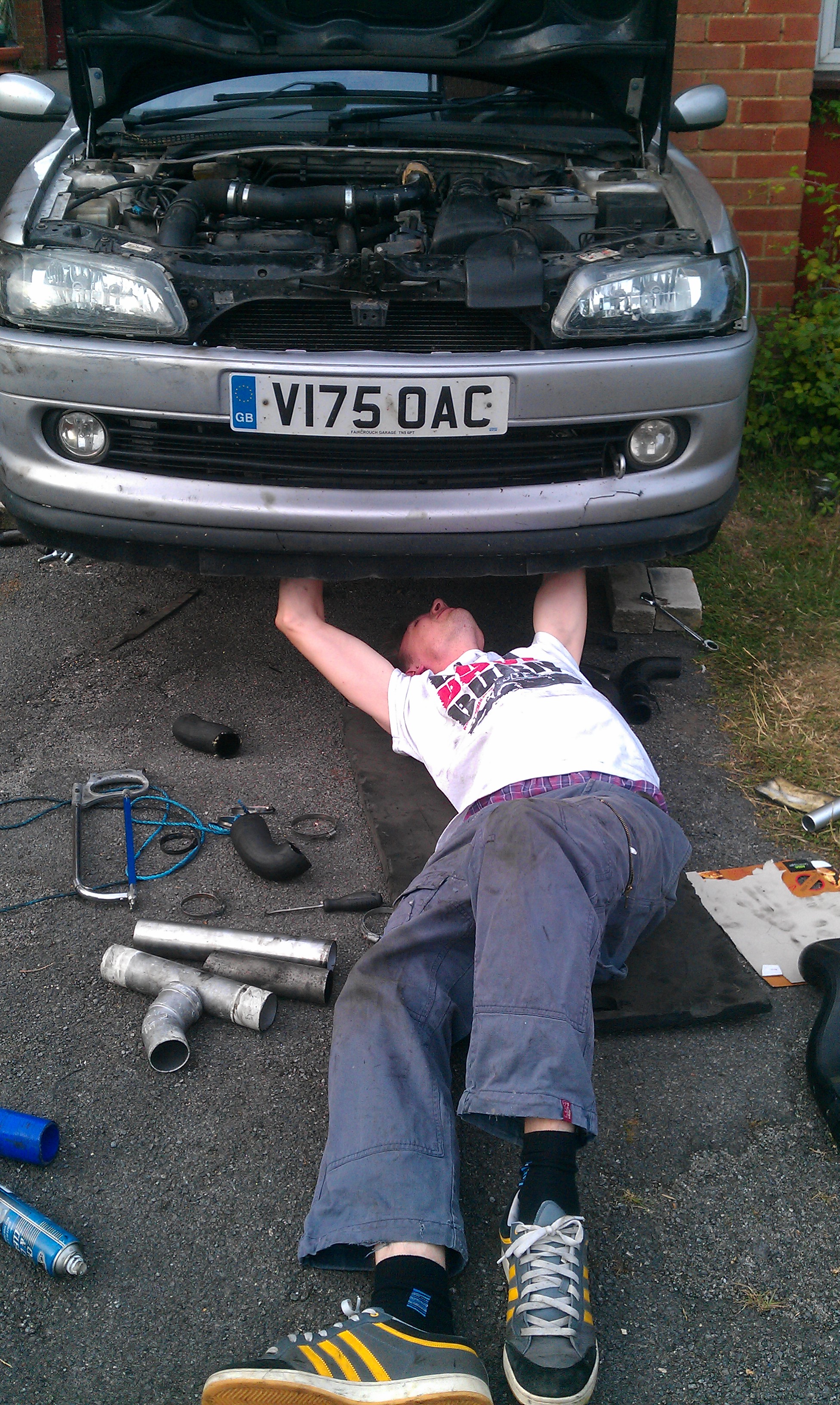

Here's what I got, pics of dumdum taking 5 & alex under the car working hard
Im impressed at the install and how quickly it was done considering it was done by 2 cripples and a..ermm.. Steve
[Image: mcetg0.png]
great photos lol. Obviously I spent most of the day on the floor doing not alot. I did manage to get the rear pipe off in one piece after about 2 hours of finding that Poodle has no ToMD to cut/break the pipe up.
I also did the super neat top pipe arrangement.
Hahah yeah, Dan did his usual - turned up for an hour, hung on to the biggest hammer he could find and took the piss, then got bored and wandered off again. Although tbf i think he did hand me a spanner at one point...
Cheers, for putting those up dude, love your description of the available work-force - two cripples and a Steve... lmao I think you did by far the majority of the work tbh mate, motivation between Chris and I was fairly non-existant.

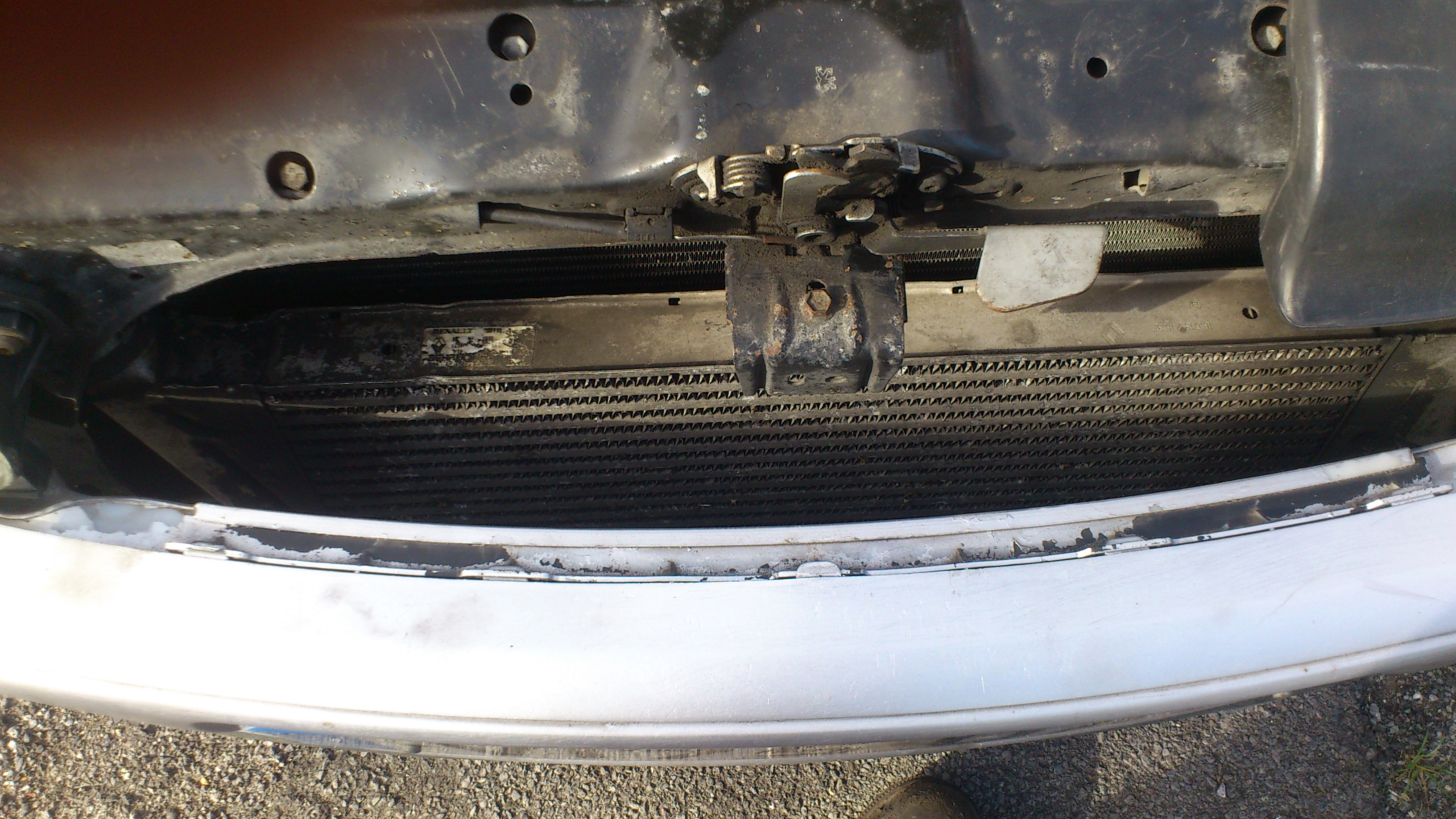

Taken some more so you can actually see the install:
Top pipes:
Cooler:
Bottom pipes:
Necessary bonnet adjustment, one in the middle looks fairly awful from the outside, but i guess that's just further motivation to get a shift on with my grp plans:
