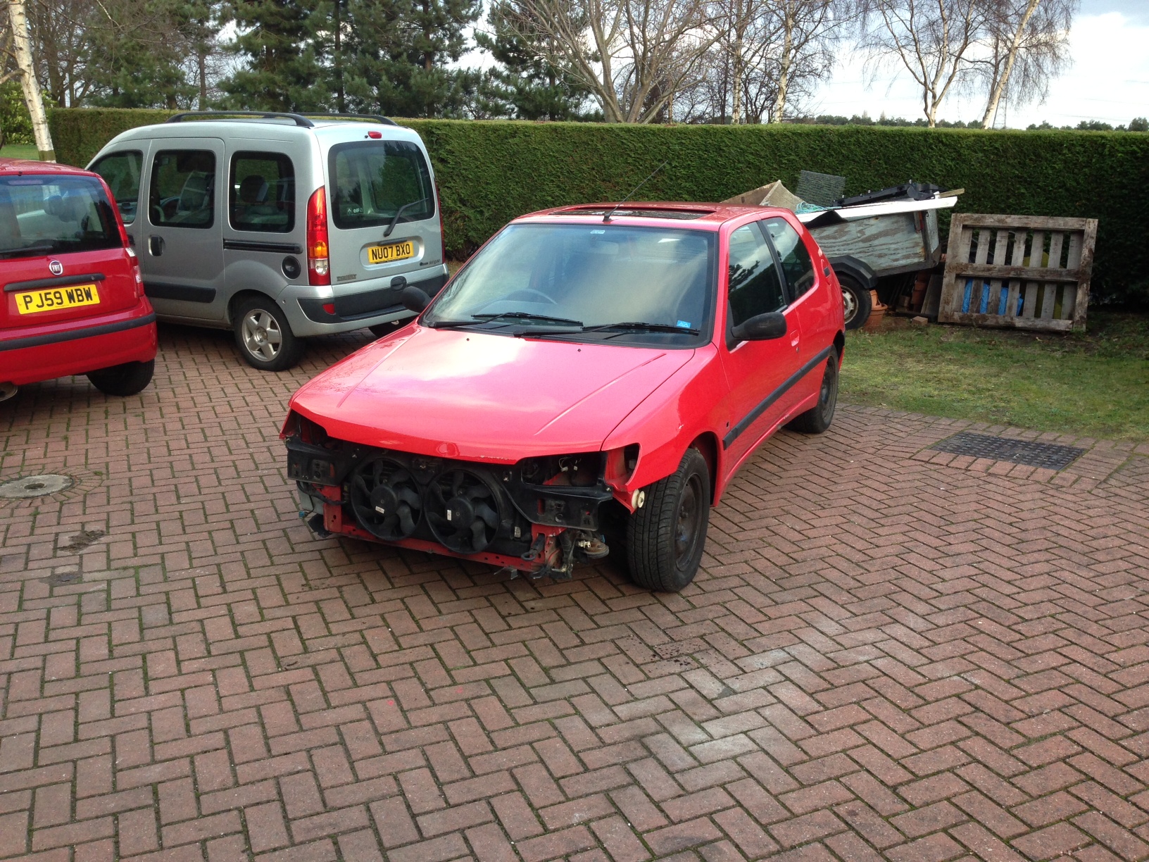

This is what it looked like the day after bringing it back , front end off to repair damaged fan housing and bent cross member which we later found...
After front end was repaired i then set out about tuning and after very quickly becoming bored of the t2 and lucas set up , i decided to throw myself in the deep end and get a bosch and td04 which i knew nothing about lol.

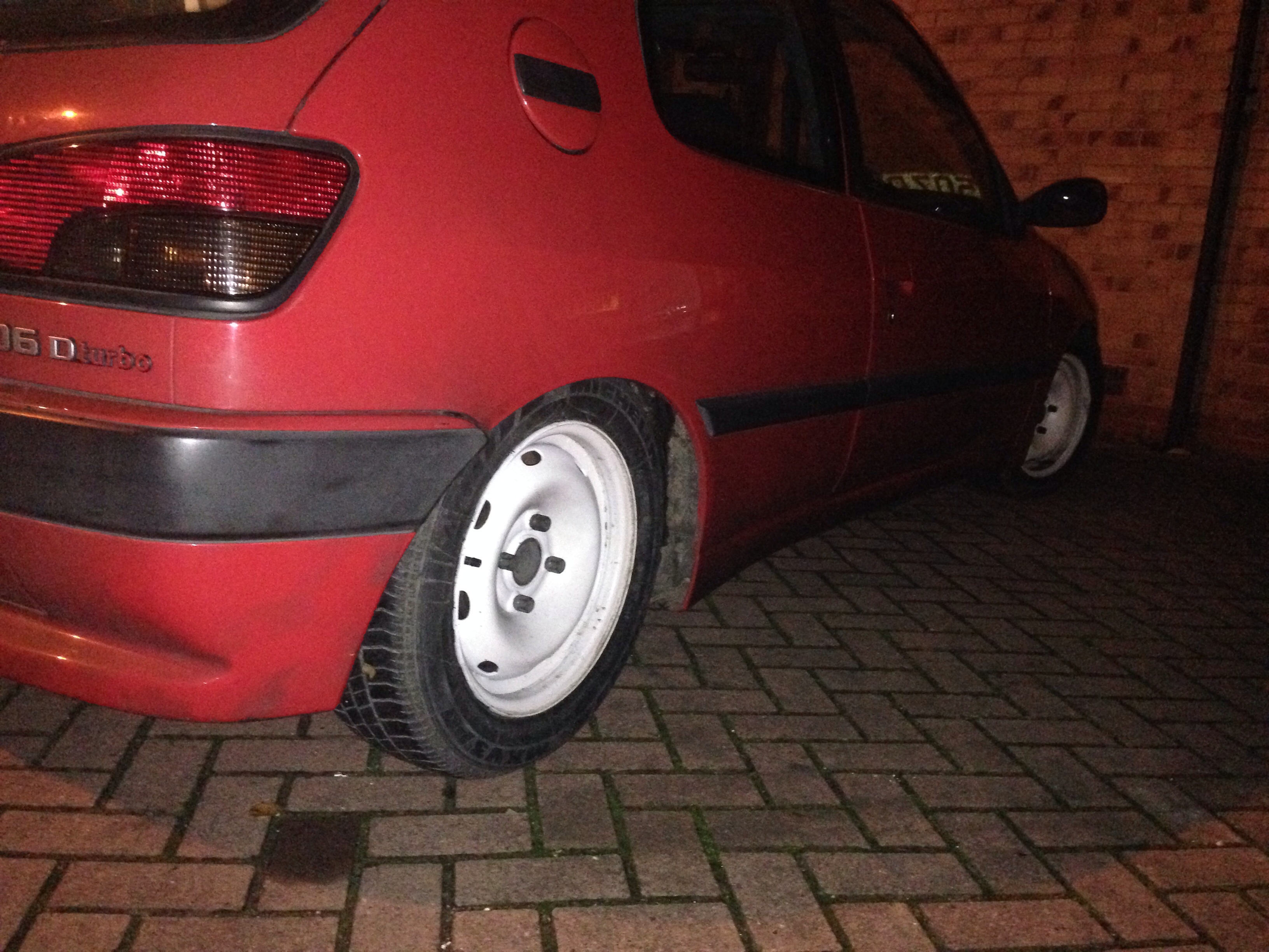

Since then , it has now been lowered and is on my original 14'' steelies which are now in white , soon to be lowered again, and on coilies... Most if not all major mods and work carried out by Danny.

I must say it looks good on the white steels
(23-11-2013, 07:47 AM)karl1989 Wrote: I need to lower the back. Erm I gained 2psi more so at 22 now
Yours is crazy low on the front lol. Should look mad when it's done all round Tongue
You still on a t2 aren't you? has it still got waste gate on it?
(23-11-2013, 09:13 AM)Frosty Wrote: I must say it looks good on the white steels
Thankyou sir , I was considering white 15 steels , the gti6 ones? But when I had my clones on it felt as though it slowed the car right down. Sad
