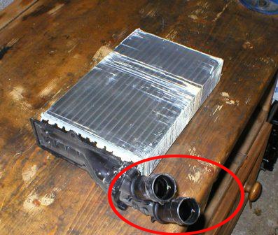

Right the below is you heater matrix, the plastic pipes on top actualy poke through into the engine bay, then the pipes pictured below that attach to it in the engine bay

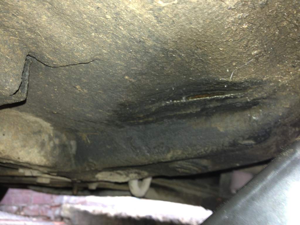

Right think tonight I've discovered I've been a bit of a dick and have 2 separate issues
I have the hole in the drivers footwell which is where I think the water is getting in to the carpet and soaking up towards the centre console because of how much is coming in
The other reason I thought it could be the matrix was that I've been loosing a couple of litres of water from the rad every few days however tonight I discovered that one of the bleed points has been left slightly open which I guess is where all the water is going

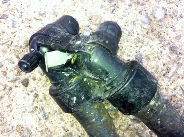

Picture of the split looks pretty big to me

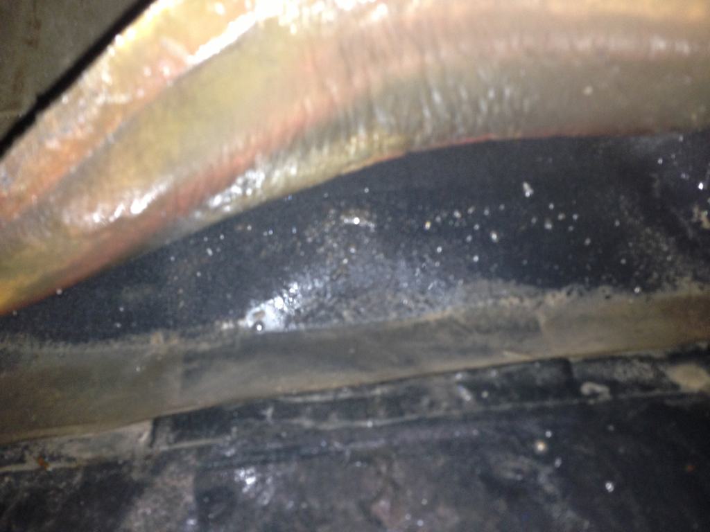

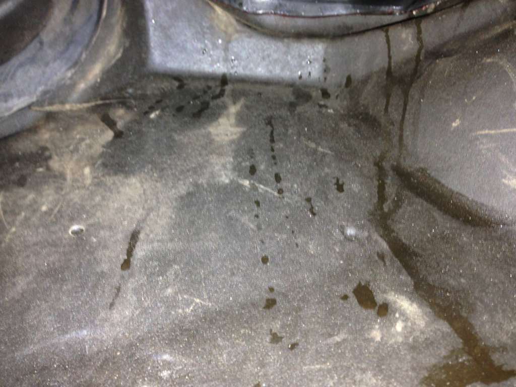

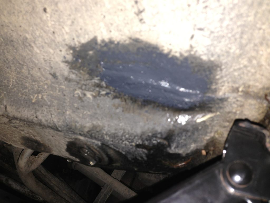

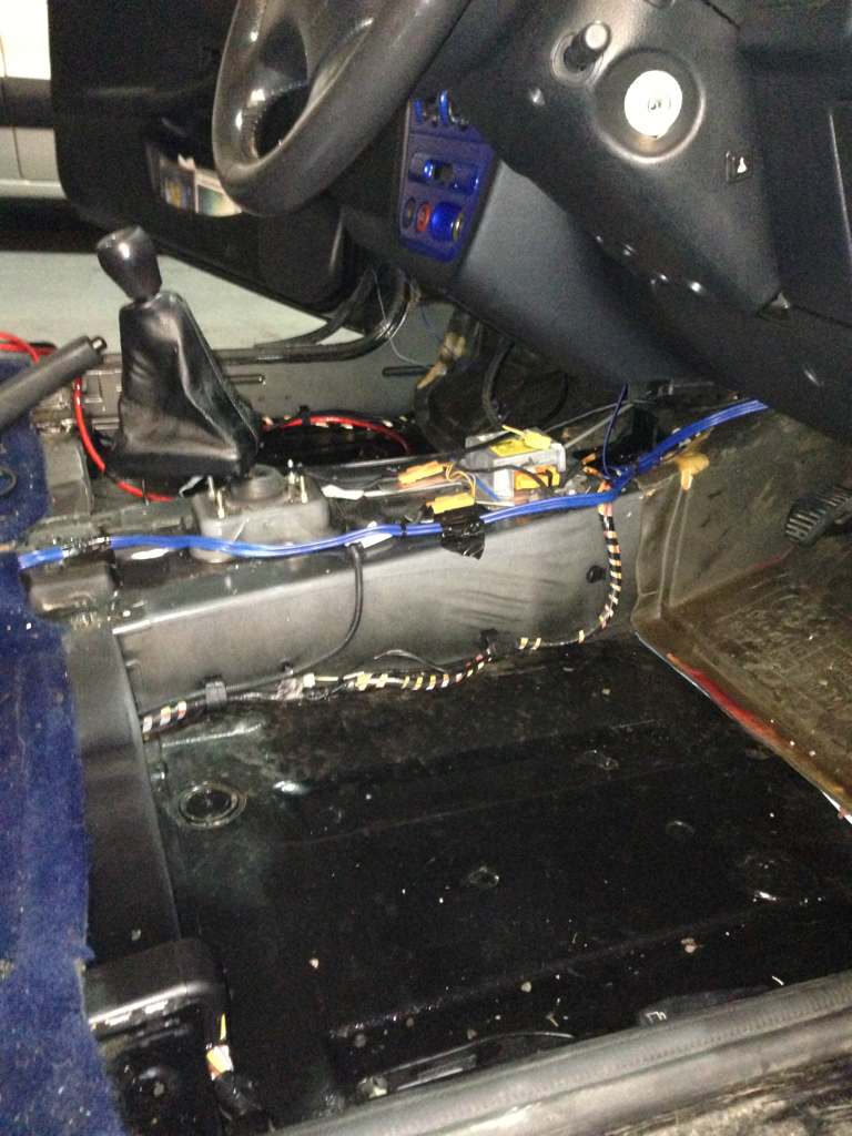

Decided to strip the carpet and have a good look at where the waters coming in
Couldn't find anything obvious it doesn't seem to be coming down from above the pedals but its definitely pooling in the bottom of the footwell
Tried to seal up the split in the floor with some silicone waiting to see if anymore water comes in

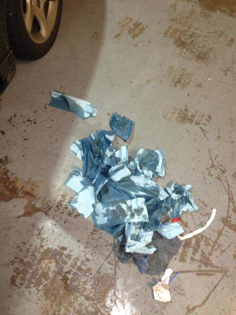

You can see how wet the drivers side of the carpet is lol
Used a few paper towels to soak up the water
Also loving the sound with no carpet in Big Grin

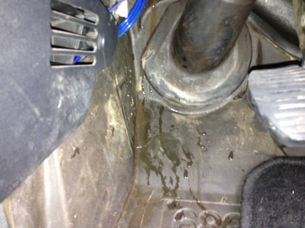

Came out of work after a dry day today and found this
That's behind the pedals and looks to be coming down from where the throttle / brake pedals go through the bulkhead
At least in that state you could clearly see where it's coming from Smile

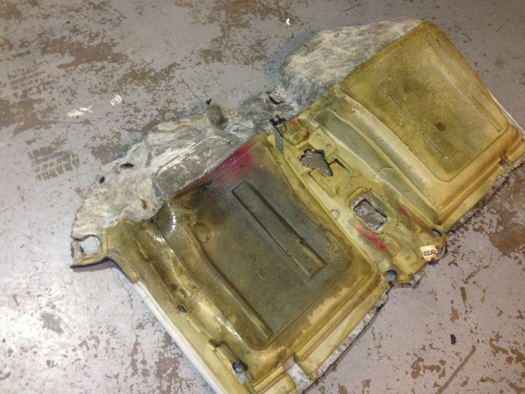

It's much easier without the carpet lol Smile found a little rust on the sill inside so need to touch that up and get it primed and painted
