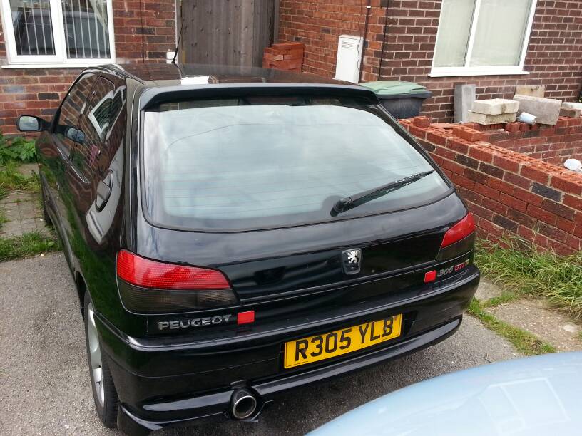

I have a non tapping head dude if you want one? Please please get rid of that rear splitter

(09-09-2013, 09:48 AM)sam Wrote: I have a non tapping head dude if you want one? Please please get rid of that rear splitter
Yeah, this. Worst rear end of the year award

lmao the splitter is almost off took the grinder to it but grinder deiced to explode so need to get another one when i got some money, also lights will be gone as soon as the new ones come Smile then the reflectors can go to lol

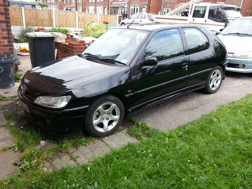

Hey, some of you on facebook would of seen I've bought this from chris.
I dont really do much work to engines my self im very noobish to them. Most of the work done to my cars is done by my dad. But this is going to be most me so I can learn from it, with alot of his help.
Car will be sat in a garage all winter where the work is going to be done. In the garage I have access to electric and a pit to make life easy.
Not much has happened to it yet as I wanted to get the head of to inspect the damage. This way I can make plans and set a budget.

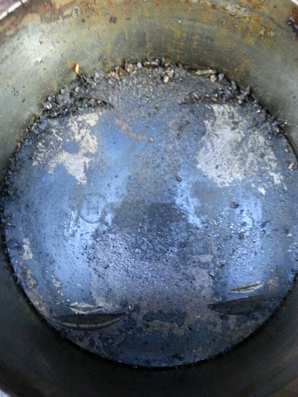

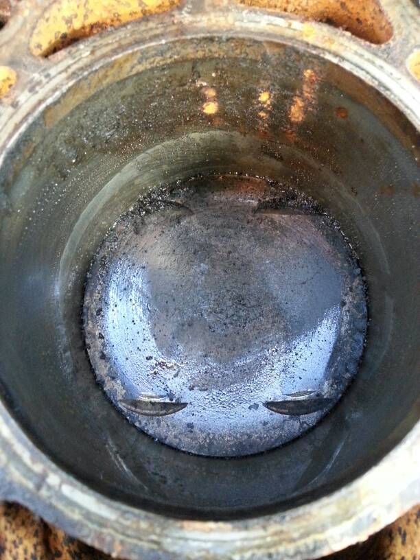

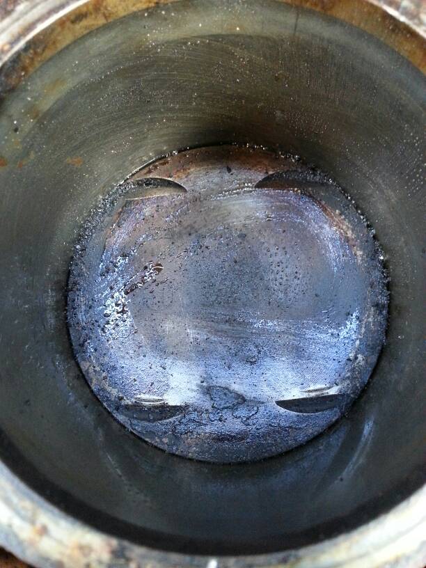

The valves are well and truly bent, some are catching on the head they're that bent. They have left scores on the pistons to be expected, but as far as we can tell threes no major damage!
Pistons starting from cam belt.
Plans for the car is get engine out and give it a full rebuild, think it will defferntly get head polished and ported. Engine bay will get fresh coat of paint, under car will get undercoated. So far is going to stay pretty much oem.

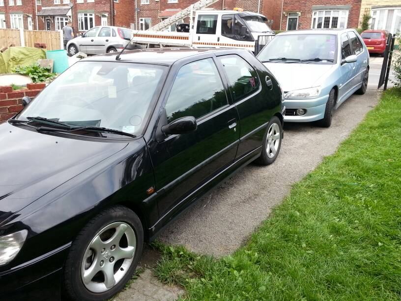

Few pics of car on drive
Body work is in pretty good condition only few things need sorting.
cool there are marks on all 4 cylinders on the inlet side,

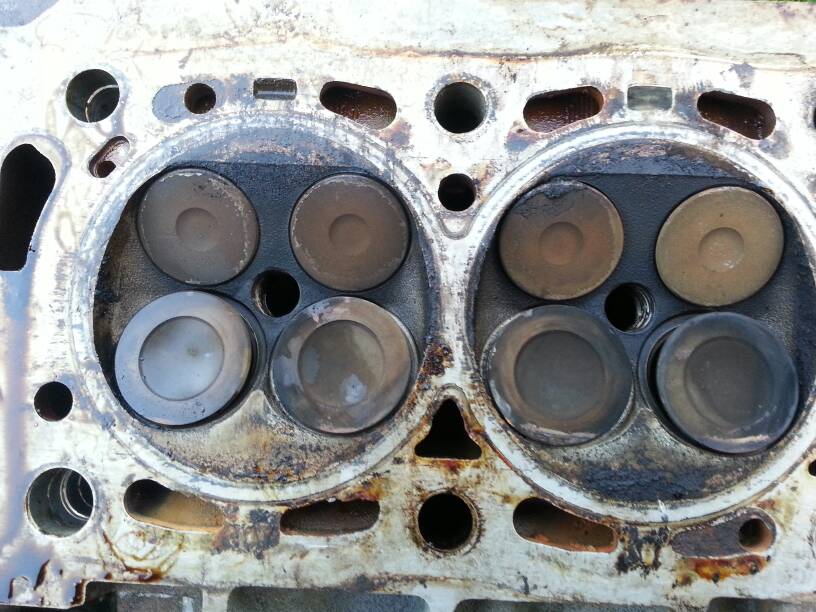

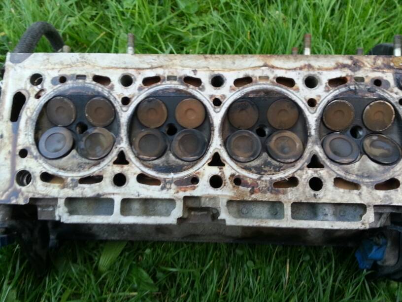

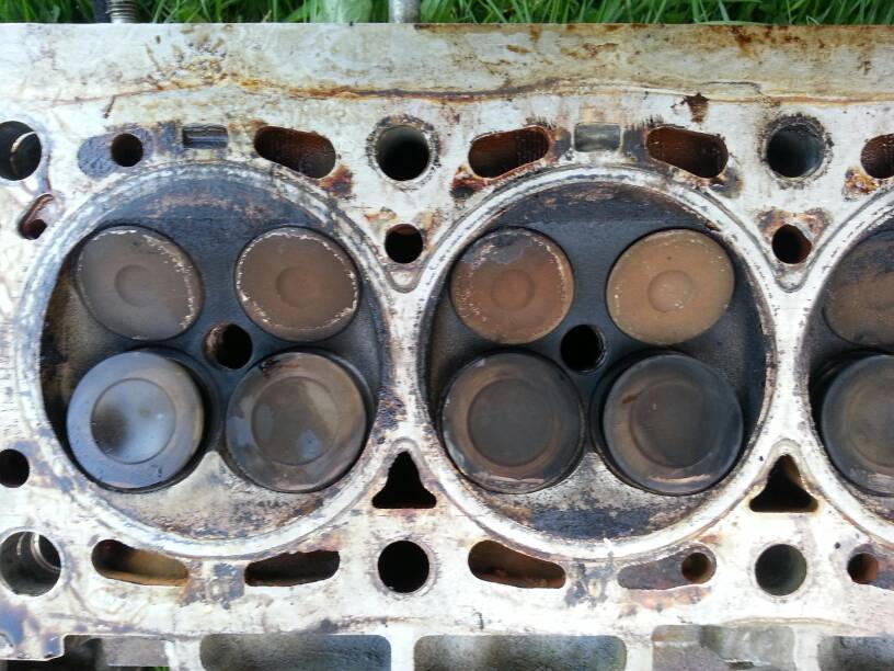

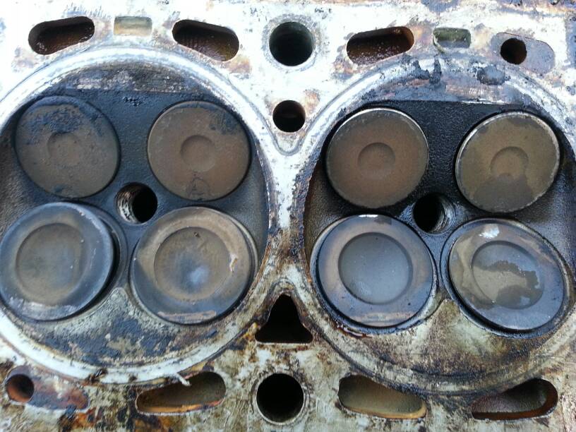

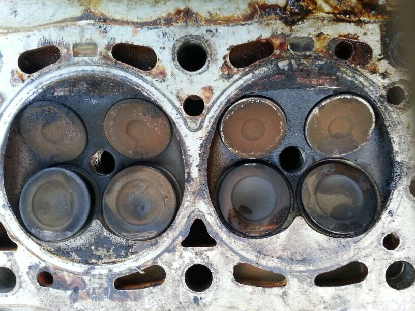

Ill brave the cold and get pictures of the head for you.
Heres pictures of the head.
You can tell a couple of the valves are catching the head.
Same but from opposite angle.
yeah they be mashed
lol when you get those inlet valves out that head they are going to look bent as a dogs hind leg
