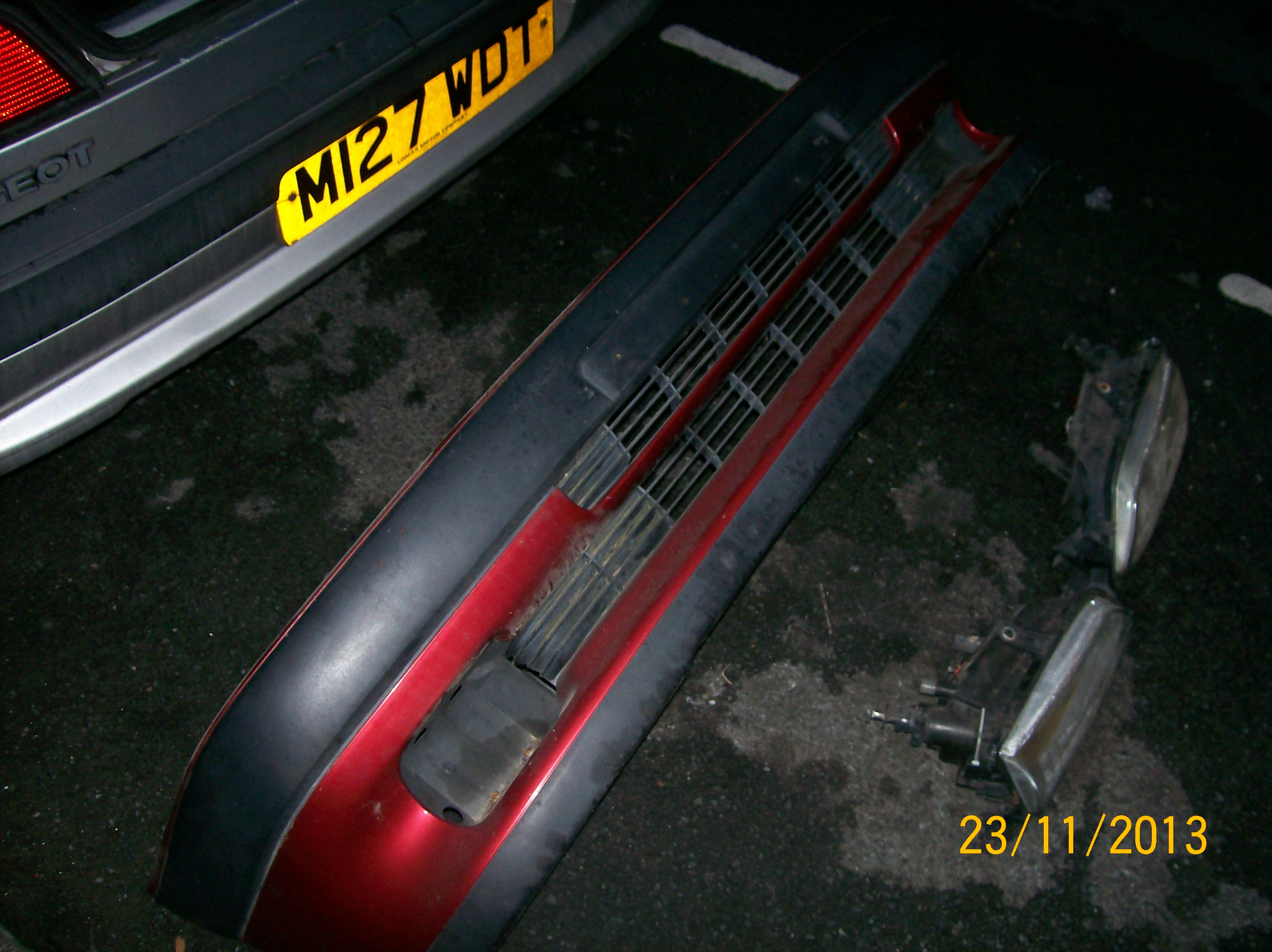

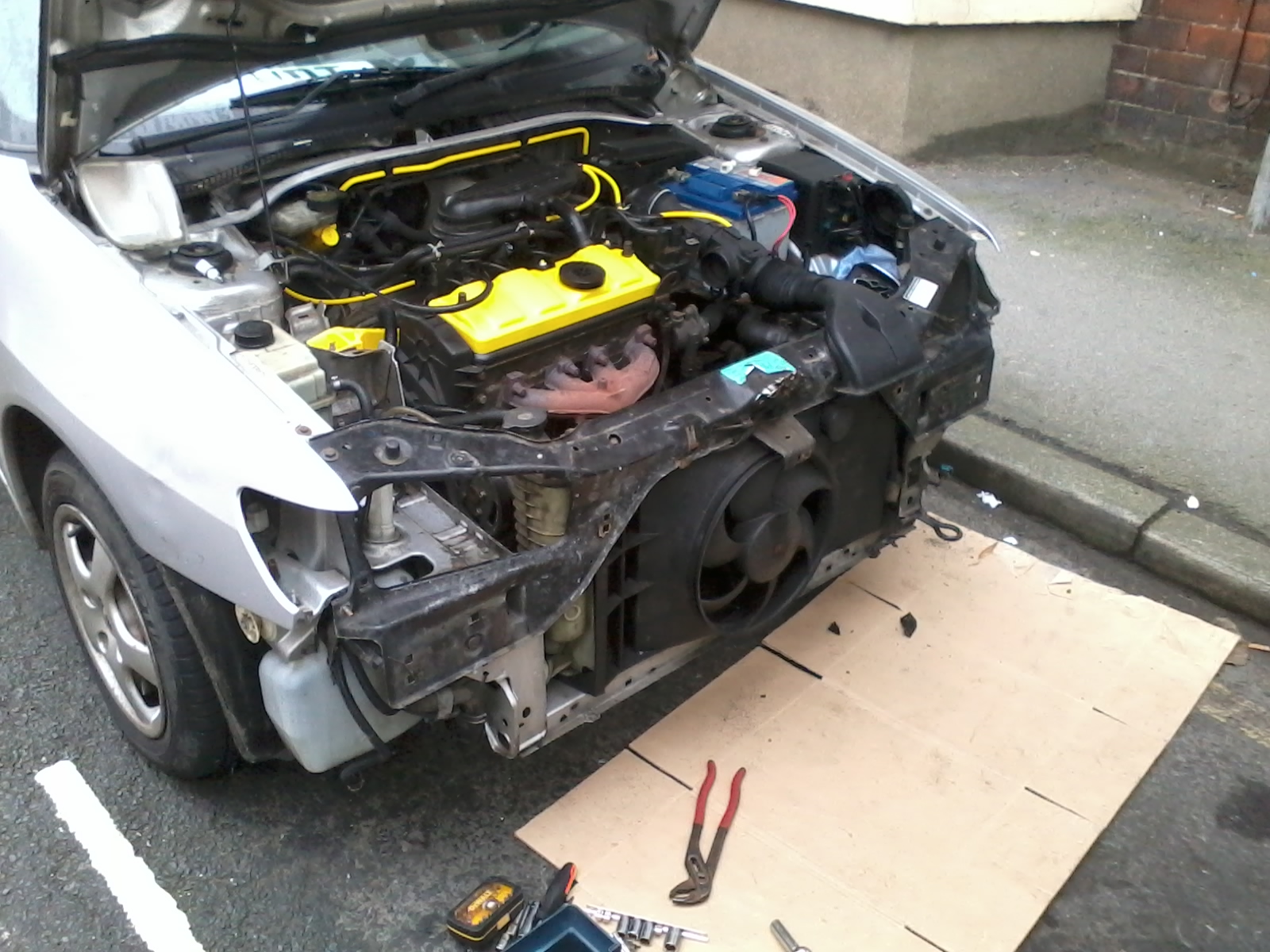

thsi might become a habit, got round to fitting the new bumper and lights this morning - and removing the last of the plastidip from the bonnet lol
started by removing the grill and things under the lights - managed to break a couple of the clips on the drivers side one... Sad
rounded bolts and non-captive captive nuts - hate them soooo much, but as i'm not keeping the single optics they got hacked out...
old bumper off - was pleased to see not much rust anywhere on the front
old vs new
new bumper and lights fitted - no grill or stick things - gonna get some new clips and sticks later -
moar yellow bits
while i was on ebay the other day i ordered some yellow silicone hose - gonna get some bigger diameter when i next get paid, and i have a hydraulic hose guy that's making me some stainless braided bits including an oil feed line ninja
