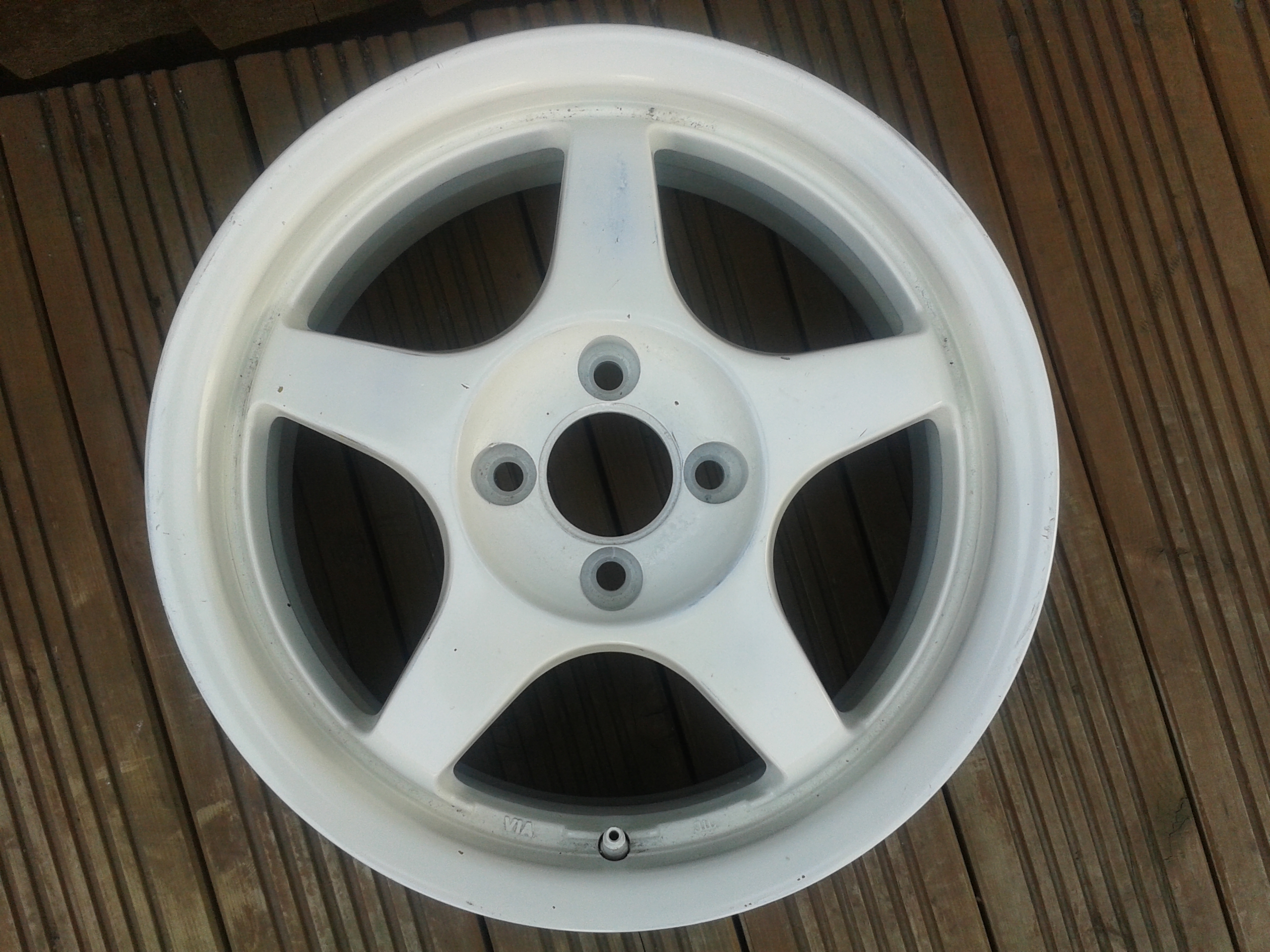

I'm a complete newb in this area so am hoping someone can help me with this. I've got a set of alloys wheels (rims only, no tyres) but don't know much about them or whether they will fit my pug?
The tyres currently on the car have 185/65R14 86H (front) and 185/65R14 86T (rear) and here are the details from the rims:
Adikt
Excel EX
6.5Jx15H2
21 01
366 S .+40
The wheels have been very poorly resprayed so will need a refurb but before I start on that I'd like to know what they are, whether the tyres I currently have will fit or what to get that will and finally if its really worth it.

Pcd (thats number of bolts holes and the diameter of the circle they form in mm) needs to be 4x108, centre-bore (as the name suggests, the bore of the hole in the centre) needs to be 65.1. I think that ".+40" is probably the et or offset, the 306 takes 18-23 iirc so you'll need 20-25mm spacers. 15x6.5j is fine, almost the same as standard.

they look like adikt speed alloys
uh no your tyres wont fit ....... you current ones are 14" and these wheels are 15" plus theyed look fecking stupid with65 side walls on .
you need 195/50/15 or 195/55/15 tyres for these
and looking at them id say they are 4x100 pcd
take on of your wheel off and see if you can fit one of these???
As is stamped on the back they are Adikt Excel wheels (google images)
They are 15" diameter by 6.5" wide and as Poodle says probably ET40 offset. The 306 needs ET18 so you'd need 20mm spacers
They came in both 4x100 and 4x108 fitment so you need to see if the bolt holes line up properly.
As they are cheap multi fit wheels even if the bolt holes do match up they probably have a huge Ford center bore so will need spigot rings to take them down to 65.1mm
Oh and no your 14 inch tyres wont fit 15 inch wheels
