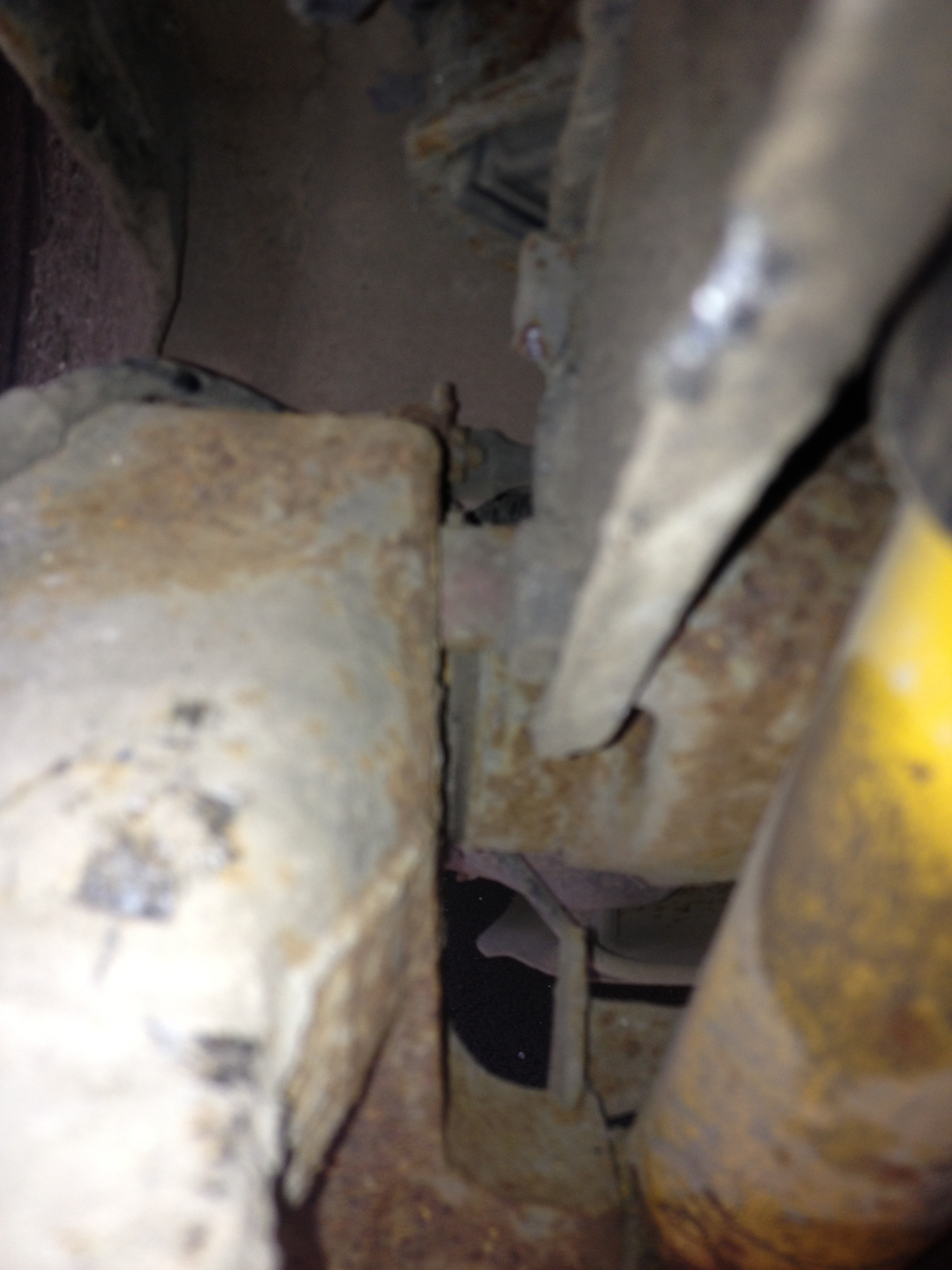

Id take that beam off and check the chassis is all straight before you go buying parts for it, the shell maybe a total write off, I had a 106 that some one had done this to, you physically couldn't fit a new beam to it because everything was so bent out of shape, it had twisted the back end up a treat, & the damage to the beam wasn't anywhere near as bad as what yours is,
Id get that beam off and get checking......

I hope I haven't!! It was crabbing on the way back but I'm hoping that's due to the state of the beam :/
check yur door and bootlid gaps are all even.

and bootfloor...get the carpet up and check it out

Right then, beam collected from the scrappy (you all know what a rear beam looks like Tongue) had a look at the gaps, they all look like they should and ive got that much stuff in my boot but took the edge of the carpet up and it looks fine *fingers crossed*

Right then not much of an update as such. Been to longleat today so the old girl has had to sit there looking abit worse for wear :/ but I have had a look underneath. It all looks old/rusty/dirty, no visible signs of splits/twists/cracks so really it's just what puglove said, a case of taking of the beam and trying up the one I've been and got and see if it fits. There's just one thing that has me stumped, the beam I have on the car at the moment is yellow, the beam that I collected from the scrappy yesterday is black? What's the difference?
