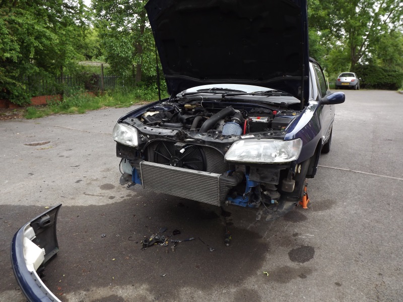

Engine is in and wired up, FMIC is on and plumbed in, coolant system all fitted and plumbed in, dials swapped, boost gauge fitted, got a load of diesel in it, removed the filler restrictor, got one sides 302mm brake on

Cheers lads, got a little bit closer today
Fit HP PAS Pipe - arse ache of a job but done
Refit front end - Slam panel and lights are on with bonnet release cable. bumper awaits
make a couple of fuel lines to bridge gap to inner wing and back - done
refit OS hub and drive shaft - Done bolts need tightening though
fit 302mm brake that side - Done
bleed brakes - Awaits
Fill up all fluids - Awaits (well its got a liter of gear oil in now)
Make exhaust - Done but needs fitting, I need to find the right clamp
New jobs
Find exhaust clamp
Refit dash
plug boost gauge wires into somewhere
find a TRE bolt that fits.
Make fogs yellow
tighten up alot of suspension bolts
So some pics

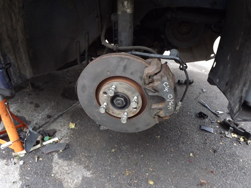

302s on Big Grin

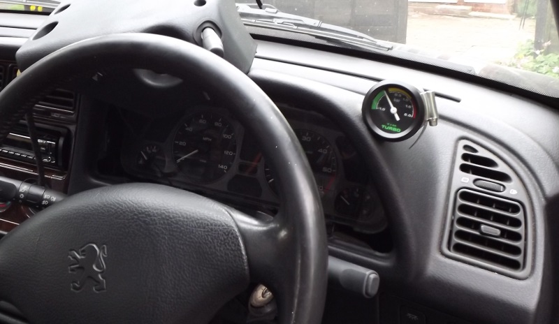

Boost gauge fitting (bodgetacular 3 13mm holes and a jubilee clip)
And how she stands now
How much were the 302s Chris? What car are the off of?
(10-06-2013, 11:31 AM)Niall Wrote: How much were the 302s Chris? What car are the off of?
I'm guessing a Citroen C4 going by the writing on the caliper.
Oh yeah didn't see that lol. Bet them discs weigh a f*cking ton though! Would do disasterous things to my unsprung weight
£150 with the used pads and discs off a member here. One of the faster C4s.
(10-06-2013, 11:36 AM)Niall Wrote: Oh yeah didn't see that lol. Bet them discs weigh a f*cking ton though! Would do disasterous things to my unsprung weight
they weigh a ton but imo stop better than brembos.
