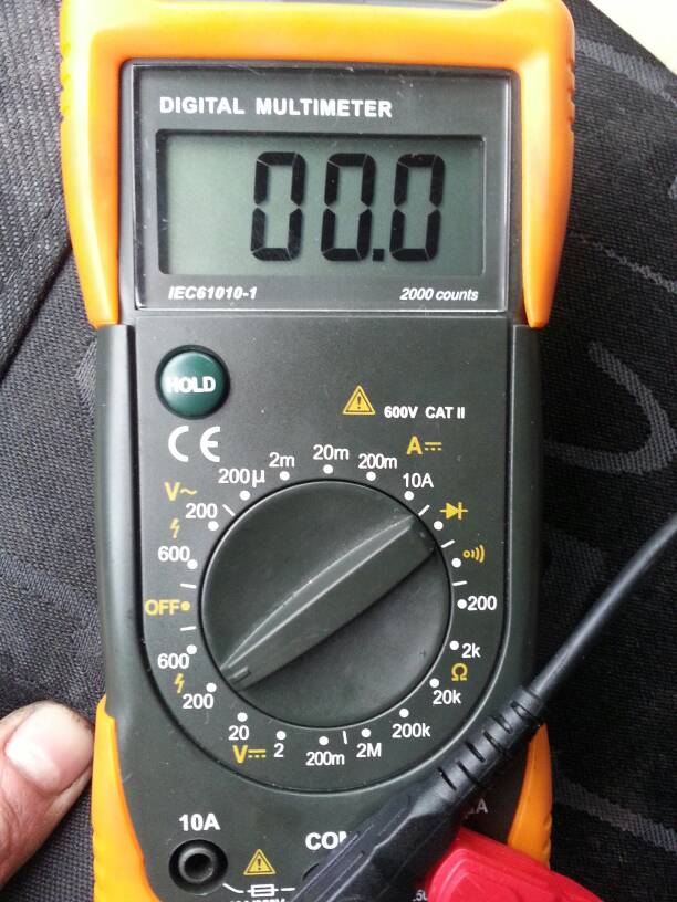

So I can put the multimeter in to it to get the reading. Got autodata on anyway but not sure what to look for.
#69

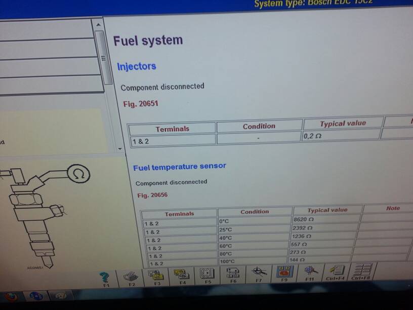

Defiantly something up with the injectors as they measure 0 ohms and as it shows here in autodata they should measure 0.2ohms.

I've never heard of the injectors being "shorted out" and i'm not even sure it's possible. Plus you'd struggle to do it with the voltage generally found around a car, especially considering it takes 80v to fire them compared to the 12v everything else uses lol.

I know what your saying about not being able to but its just they defiantly measure 0 ohms which they shouldn't according to autodata.

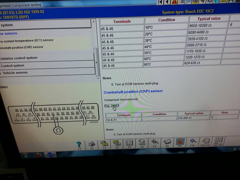

This is what I have found
Frps 1.3v OK
Fpr at multi plug 0.3 ohms OK
Fpr at connector 11.4v OK
Crank posistion sensor 11.2ohms ???
Should be between 315-405 according to autodata.
Could it be the wiring going to it or probably the sensor?
#89
405Ohms? Is that through the sensor? That's massive resisitance, sounds like its shorting out inside the sensor if its as low as you say.
